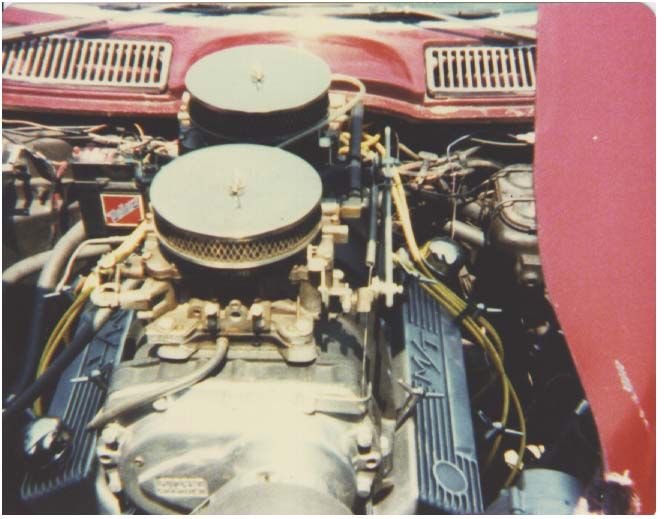

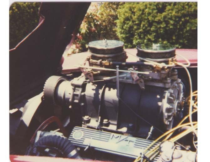

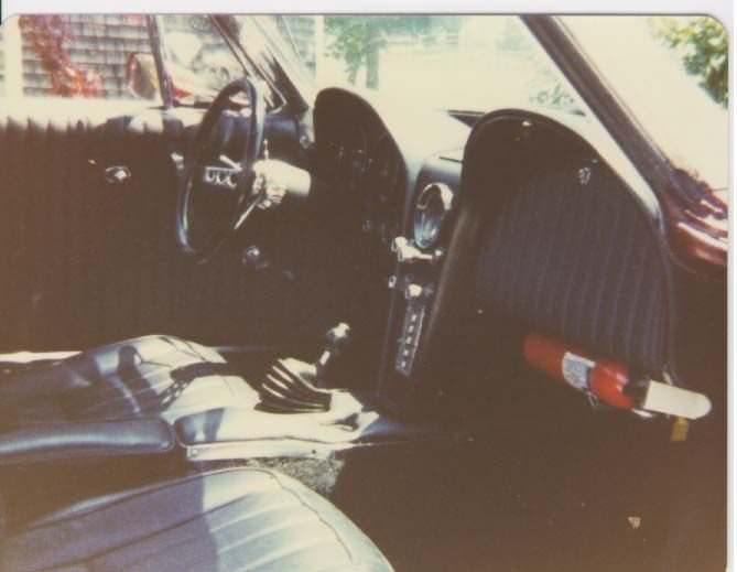

I came across some old pictures of my old 66 that I had put together many years ago when I was a kid. I wish I still had it. I bought it for $2400 from a guy that was trying to restore it, but ran out of money. I brought it home in a basket. Everything was there, though. It had a nice little 327 with a 750 Holly double pumper on a Tarantula manifold. I put headers with pipes and shields on it and it really woke it up. The only bad thing about it was the kid stripped all the paint off the body with a grinder. Anyway, I got it together as best I could with the limited resources I had while in college and It turned out to be a fun little driver. Then one day I was rolling down the highway, doing about a buck, when I pulled a valve train stud out of the head and that was that. I thought I had killed it, but I was lucky. I took all the pieces to a machine shop (Bradwell & Hallaway) and everything was good. I had it magnafluxed, punched out thirty over, line bored, decked and paralleled, polished the crank, cut the bosses and had screw on studs installed, shot peen the rods - you name it. I was amazed at how good it came out. I wanted to do something special with it. Why not a blower?
I've been trying to put some pictures here for an hour, but it's not working right. I'll try to put in a post below.
