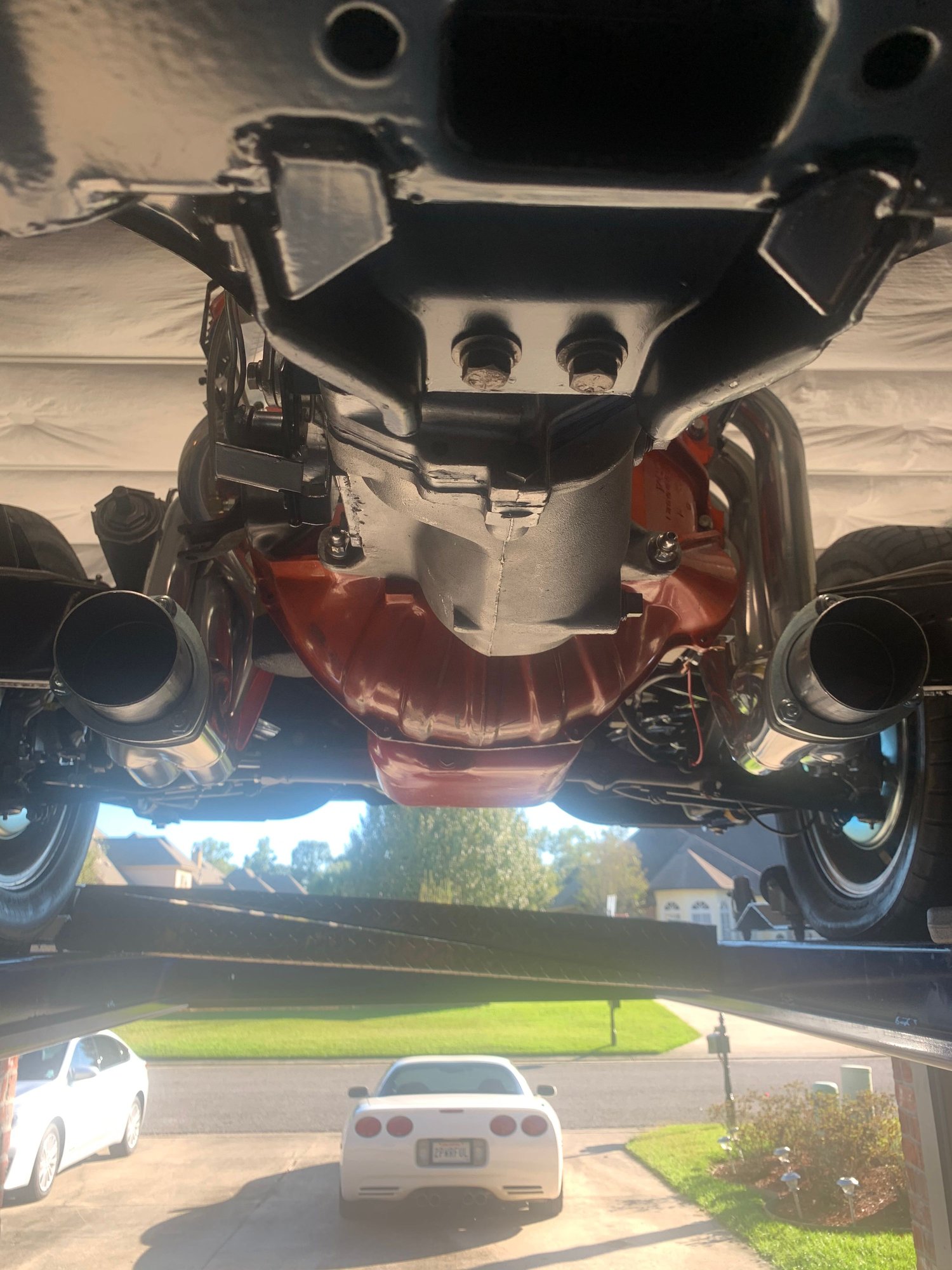

I was really happy with the Headman elite ceramic coated ones I got for my 71.
Just uploaded this.
