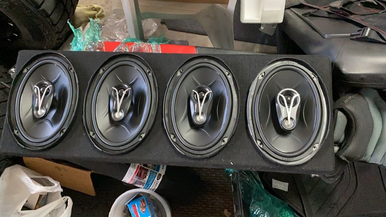

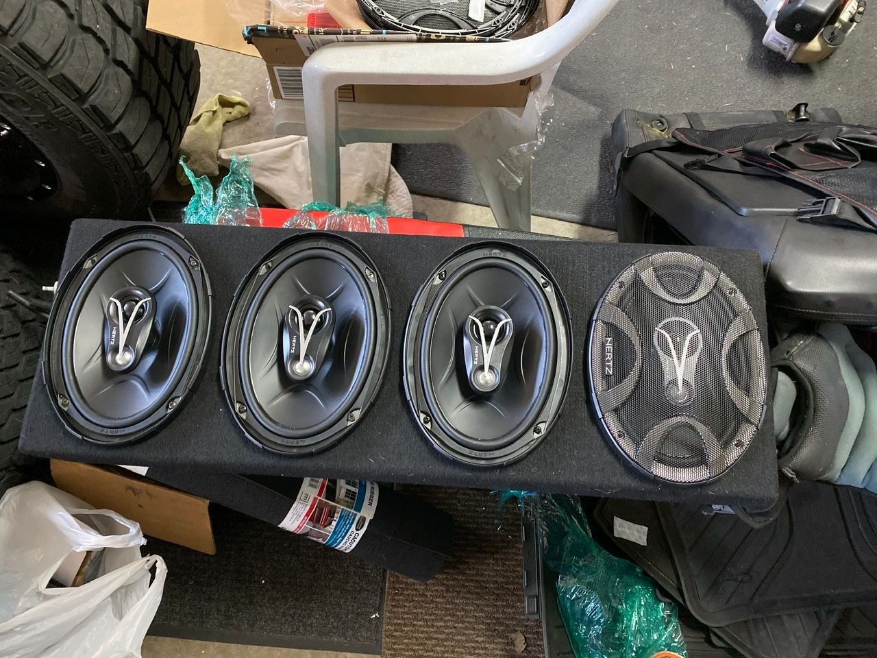

Well I finally got around to getting the audio system set up. Once the interior is reassembled I’ll test everything out and make sure all is well. I will be grounding the amp to the - of the battery.
