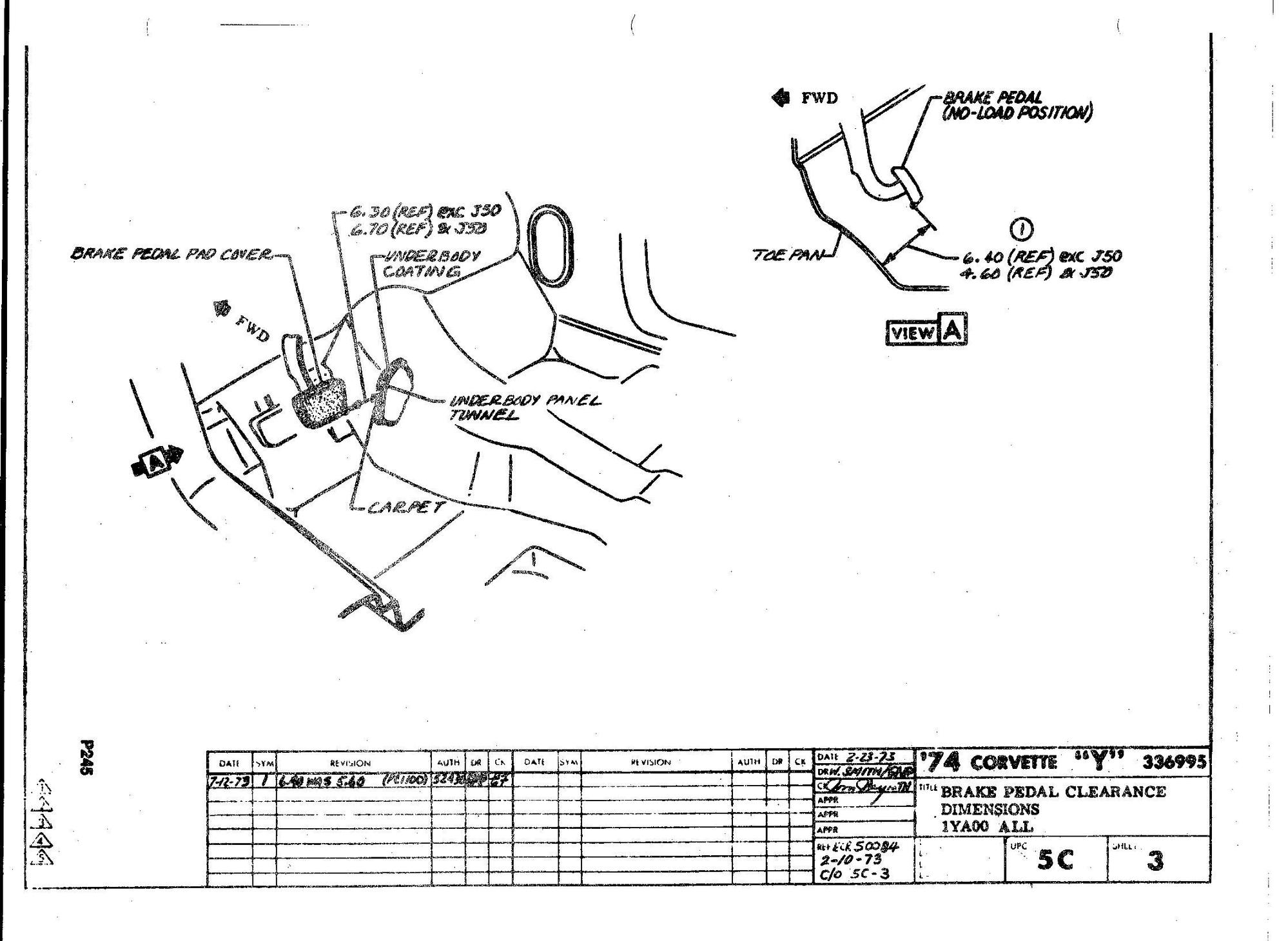

Pedal travel:
A C3 brake pedal seems to have a lot of travel and takes a little time to get used to.
With only 6 inches of total travel and 2 inches of travel before the brakes engage it may seem like the travel is excessive, but it is not.

Thanks everybody, and especially Peterbuilt for the drawings. I would be trying and trying to get very little pedal travel when there is a fair amount built into the system.
I don't have a reservoir cap adapter for a pressure bleeder, so if the brakes still don't feel good when I get it back off the hoist, (waiting for new tires to be mounted on the rims), I'll try the gravity bleeding idea.
