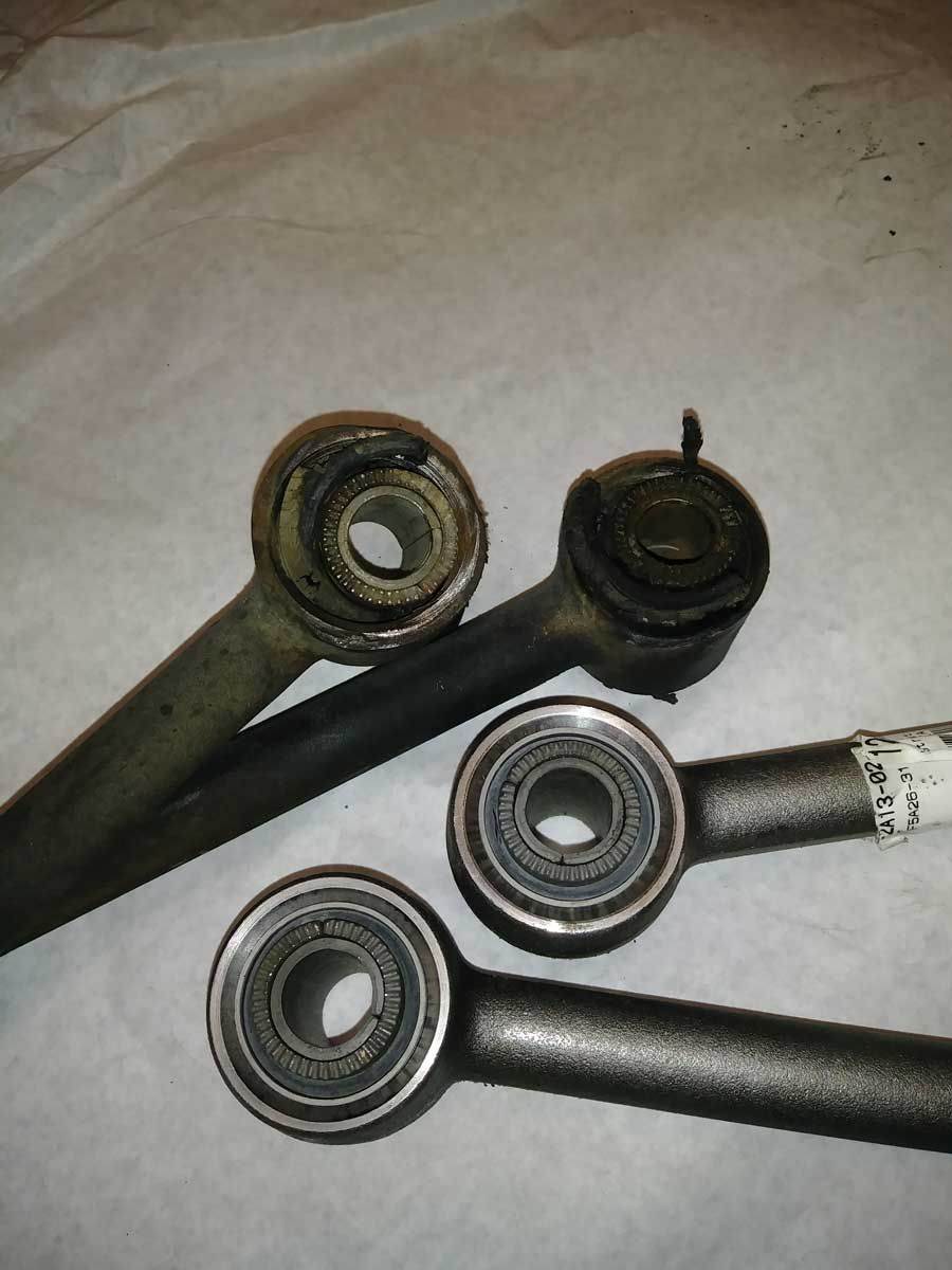

Thanks for the response guys. I'm using a stock style replacement (non-adjustable).
I'm thinking they were due.
