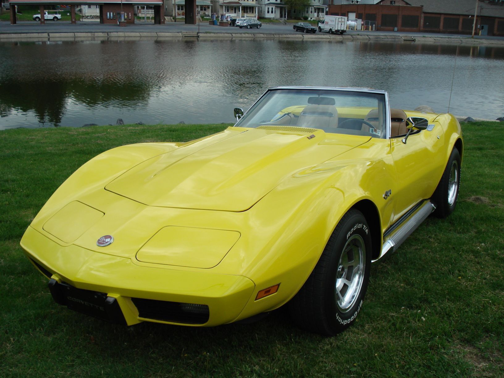

To compare to Gusto, here is my '75 (same color) with the Hooker sidepipes and Cobra Stuff shields.
