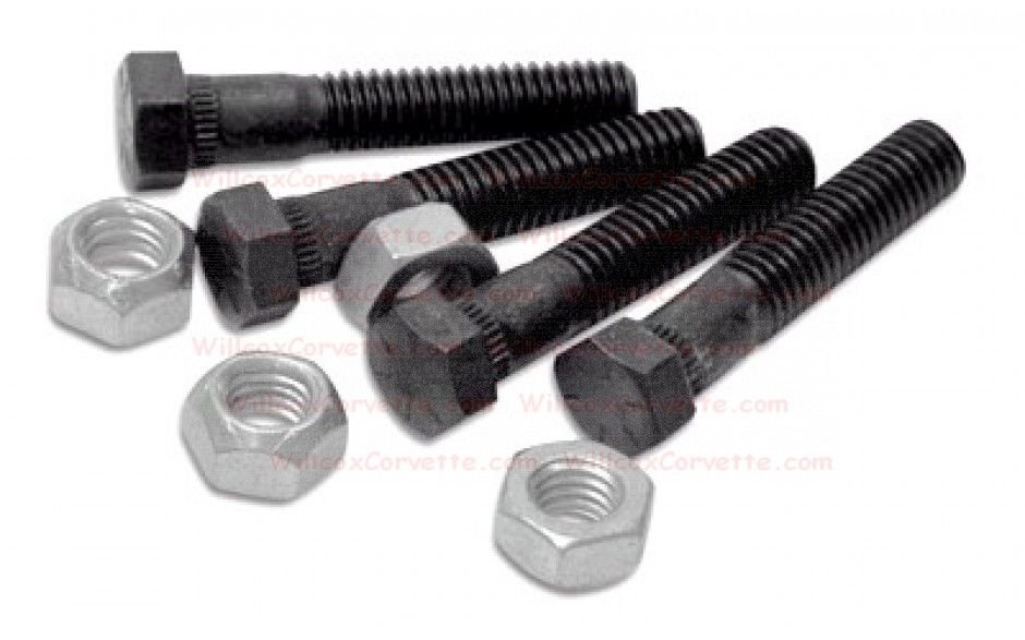

I'm considering flipping the upper A arm rear bolt around so that the nut is on the wheel side to give me more room between the bolt and LS-1 water pump. This keeps from having excess bolt length sticking out toward the water pump and only the number of shims would affect how close the upper A arm shaft is to the water pump. I realize this makes it difficult to torque down since the nut will be inside the A-arm but I don't see how it really makes any difference if I can get a socket and wrench on both ends.

The upper bolts have are serrated on the head side (see picture below) of the bolt which locks them in place once installed. I don't know if flipping them would lock the head down or not (which is only important when you have them installed correctly), so you may want to go another route bolt wise. I have some used upper shafts here and probably a used bolt that if you remind me via email tomorrow (don't send it tonight), I will see if there is any issue created with the stock bolt.
