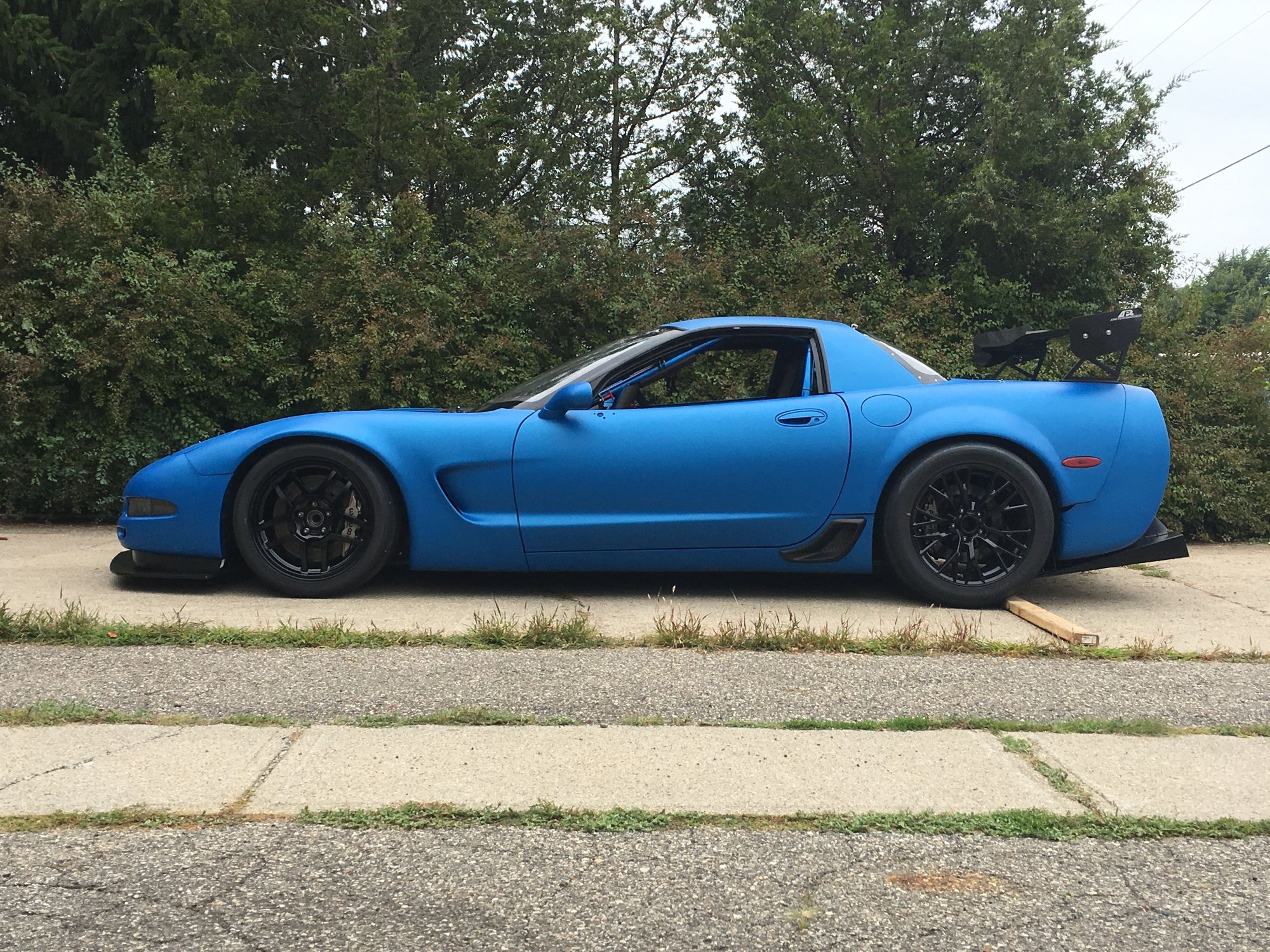

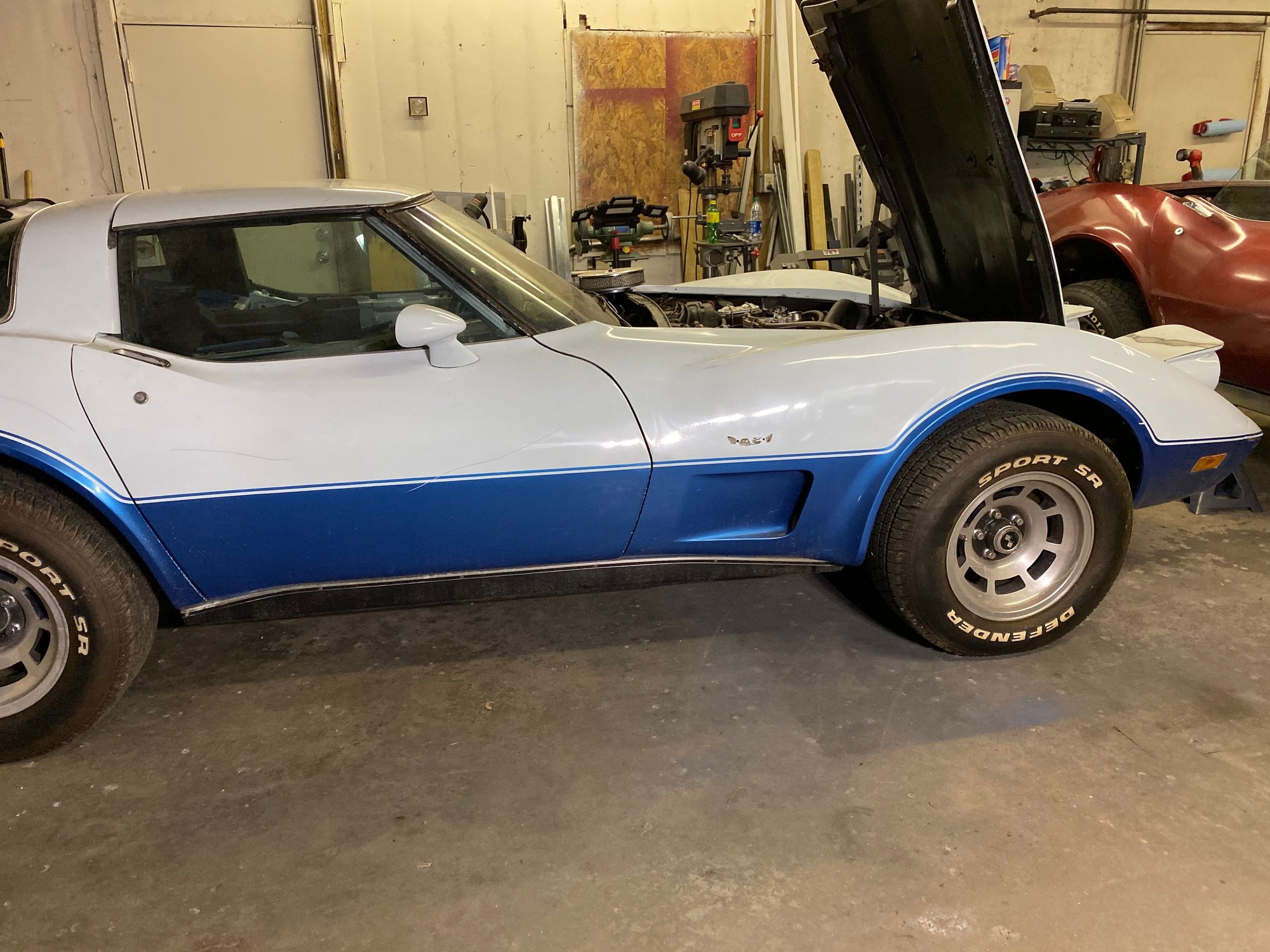

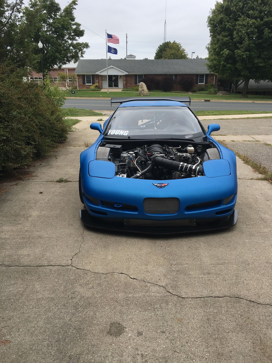

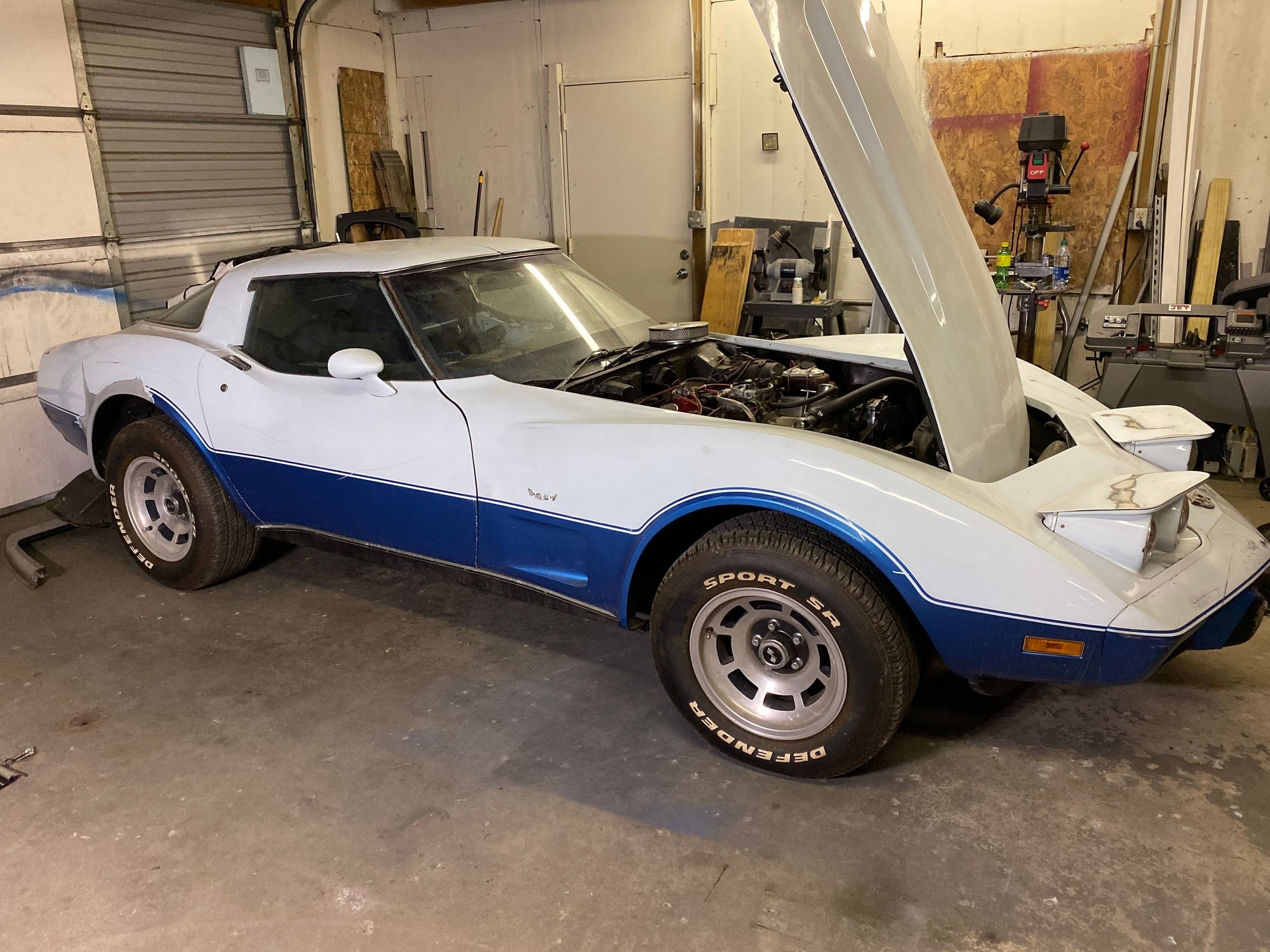

The casting numbers on the block are 3970010. I will not need any of the hvac parts. I am building this into a road race car for the NASA Trec endurance series. Any part or piece that does not need to be on the car will be removed. I will be installing the roll cage over the next few weeks and carbon fiber wide body. Motor has not been started in 9 years so don't know if I will be installing this motor or and LS. Hopfully this motor is usable. Here are some pictures of my current race car which is for sale and the 78.
