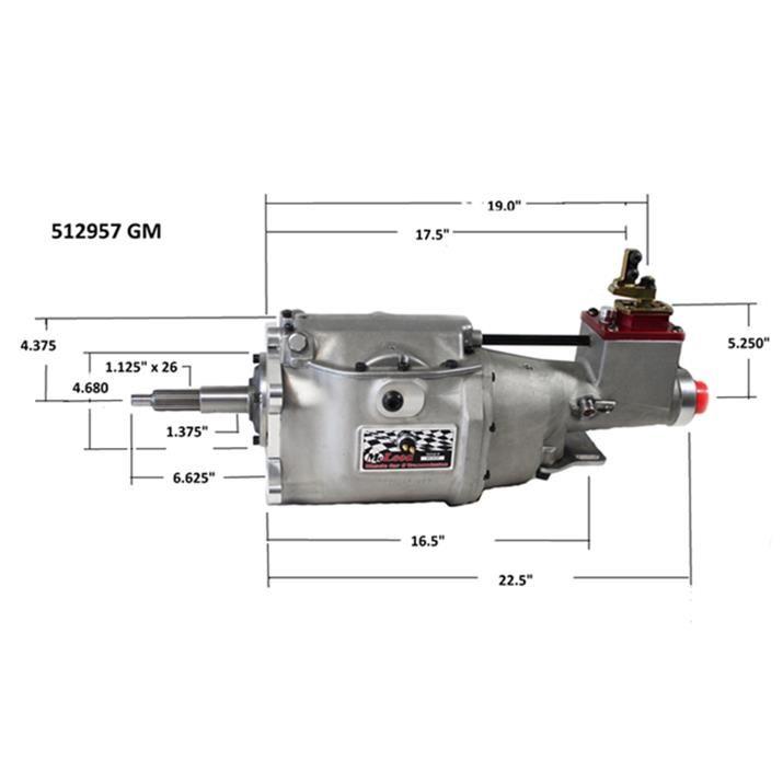

Yes, I have it installed. I did have to shorten the driveshaft and the slip yoke is larger, I think the same as TH 400 but check with Mcleod to confirm that. As for the shifter. The Camaro comes up in the center of the tunnel / console so I just made the hole more rearward and didn't have to pay the extra for the shifter mod. Don't know if that would work for you or if you need shifter offset you will have to purchase that from them. Here are the dimensions. Hope that helps.
I also had to modify the cross member trans mounting for more rearward location.
