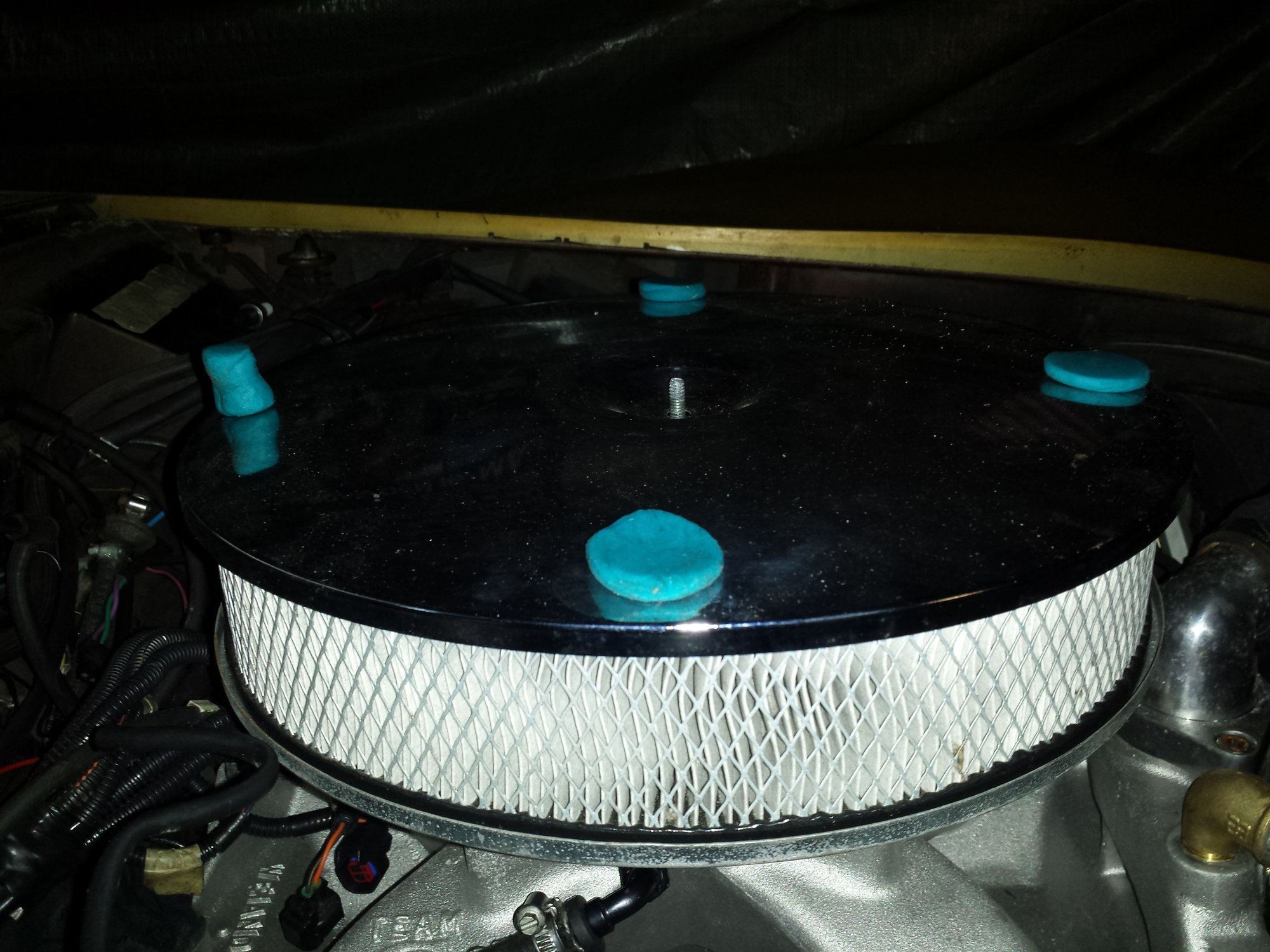

When all is said and done, take some aluminum foil and make about a 6 inch ball of loosely packed aluminum foil and set it on the air cleaner hold down stud and slowly close the hood part way, then a little more, and finally close it. The compressed thickness is your hood clearance.

Play do works too. I workout it on the front lip of the air cleaner as well as the middle

I use Play Do.
Also when I measure valve to piston clearance.
