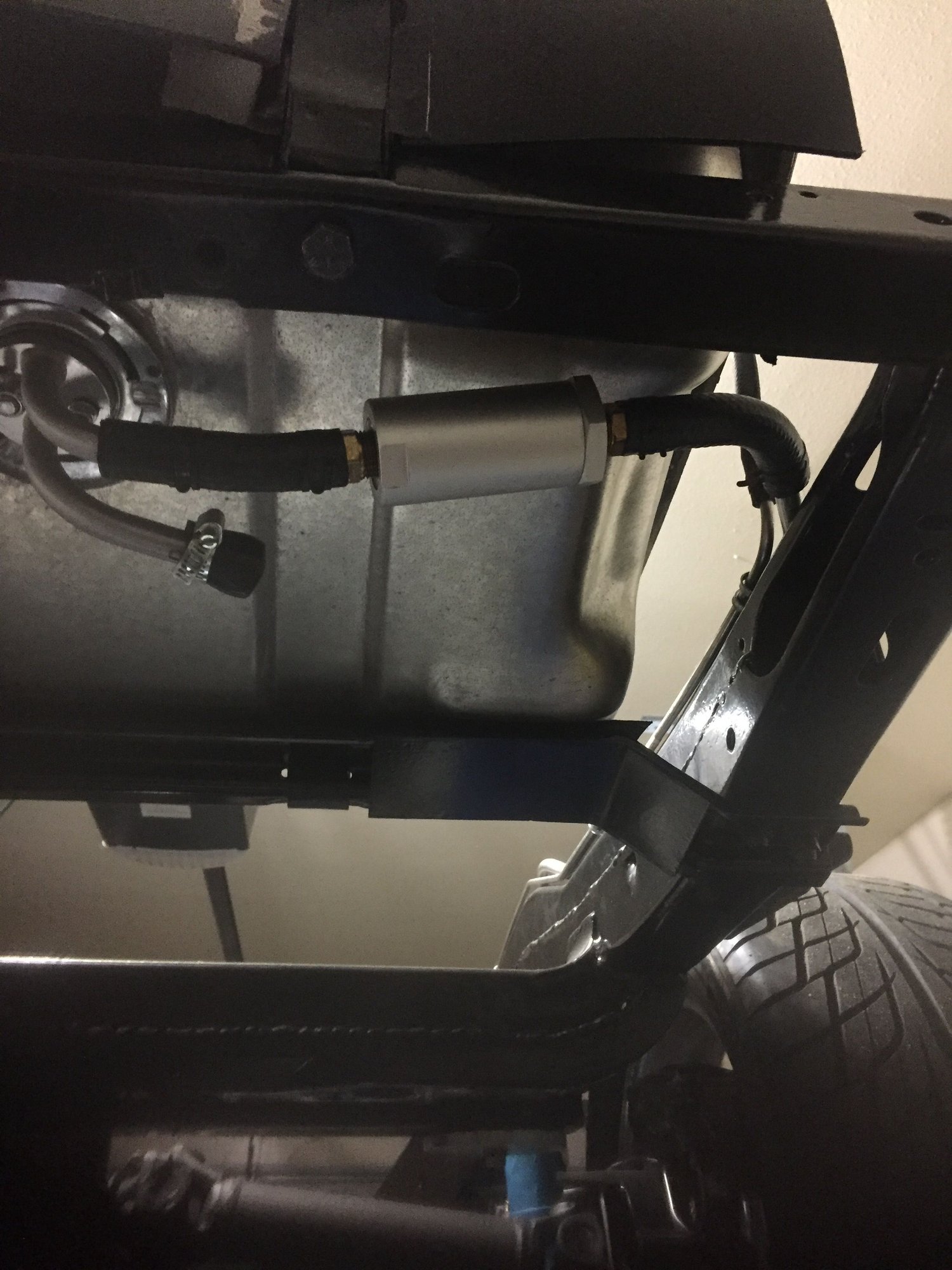

I went with the hose option on mine. Here is the fuel pump, filters and pickup.
mounted in the tank.

That is a nice pump.......I would have bought one had I known they were making them. I went with a Holley 130GPH Keith Dorton.
Currently just using the stock supply line but want to change it out to -8 and run braided AN......
Does your fuel gauge work well?
Jebby

i can not answer on the gauge since the body and frame are still separated. I have been debating on how to finish my feed line. Right now I think I’m going to cut it and install AN fittings and a short length of hose with 90’s. I have been unable to locate a 1/2 S hose and the bends are too tight for my liking.
