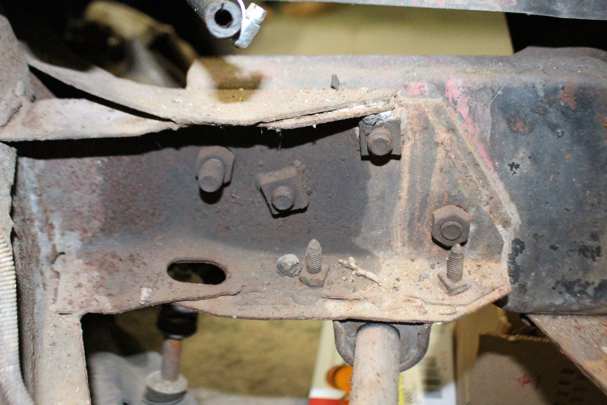

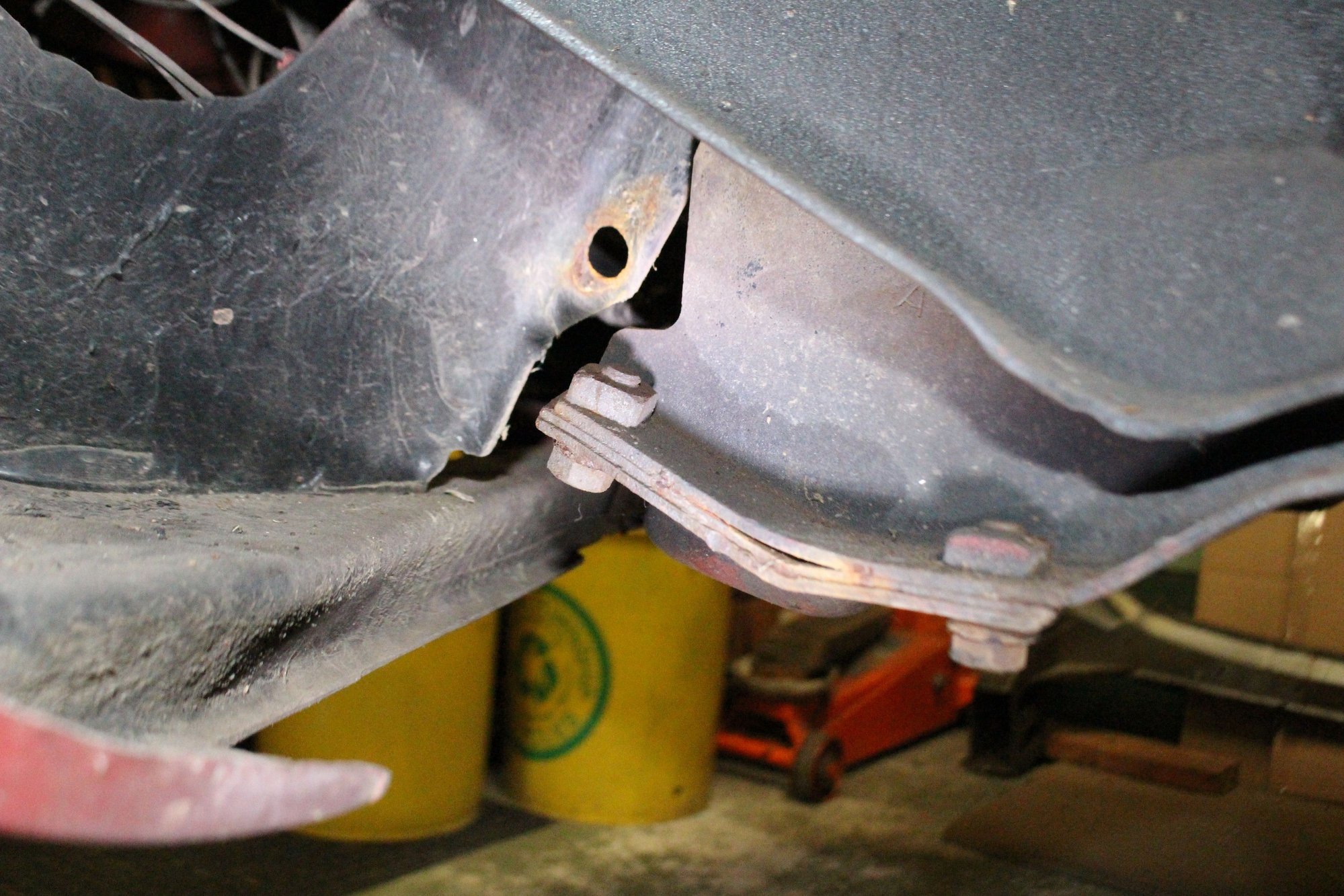

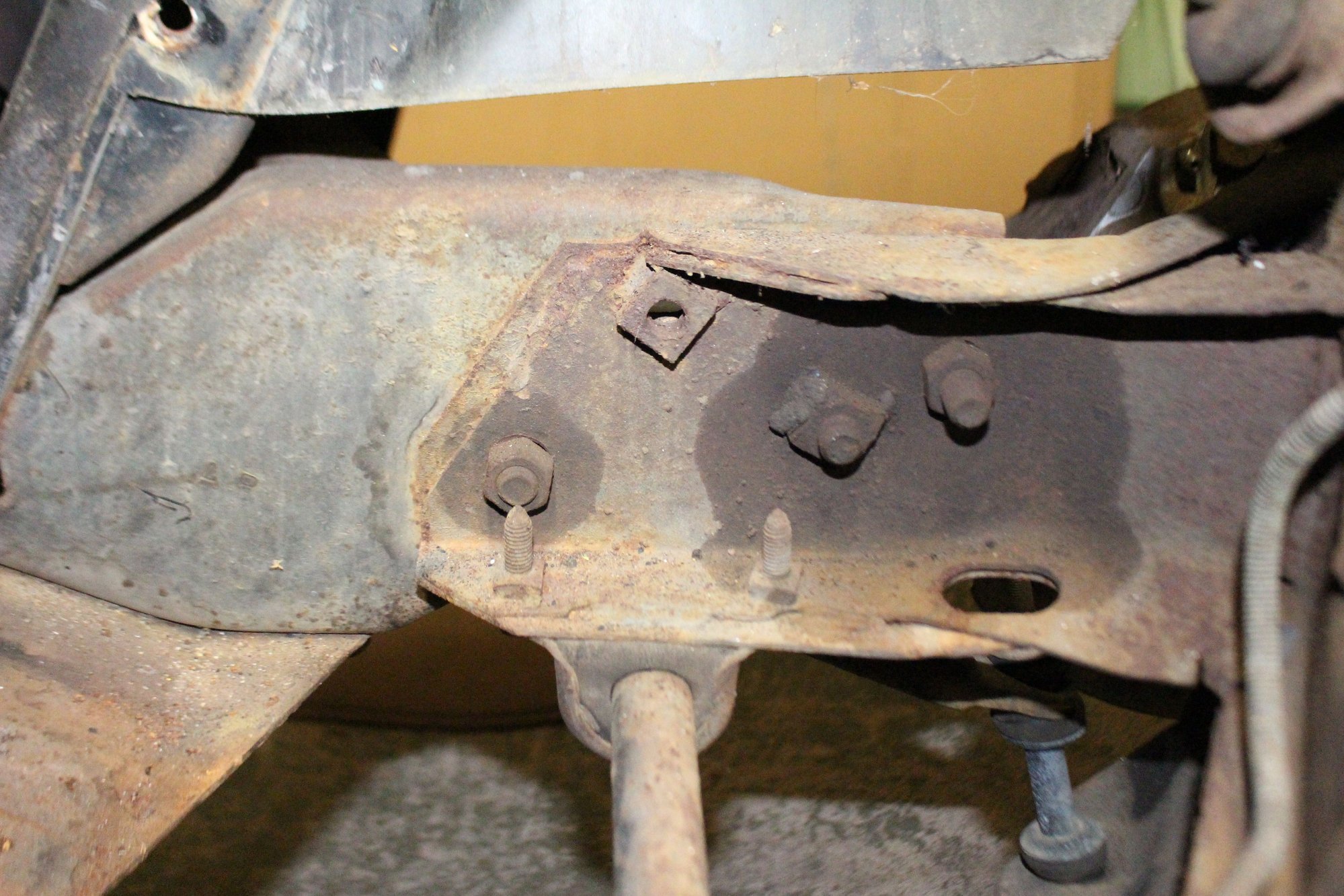

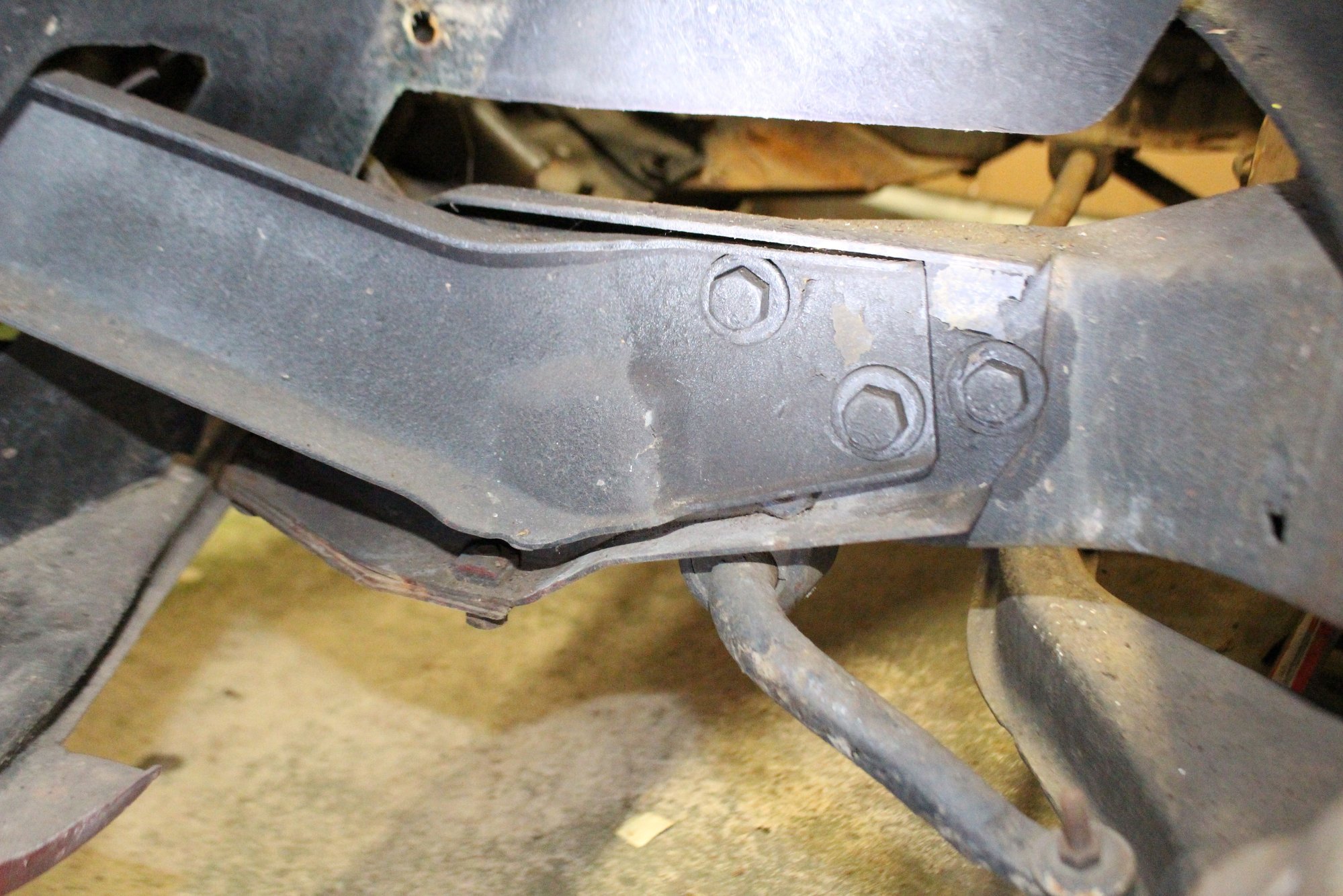

My frame extensions look to be 1/4" higher than frame itself.

Ok. I can see from Leigh's pictures that there are no welded nuts for the extensions. I thought that mine had just rusted away.
