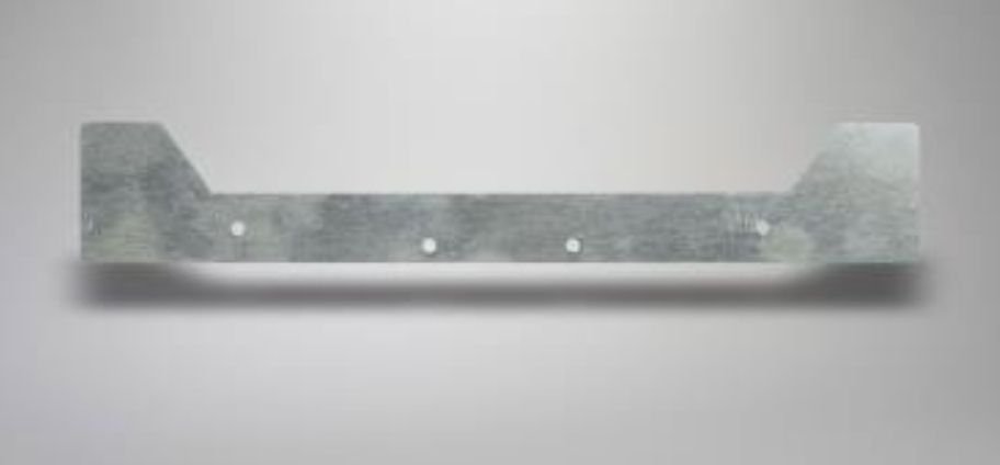

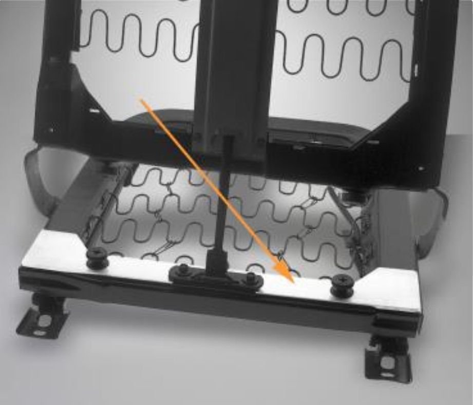

Here is the metal piece that is attached to the bottom of the broken seat frame:
Repair Plate for Lower Seat Frame
The piece is available from our forum vendors.
