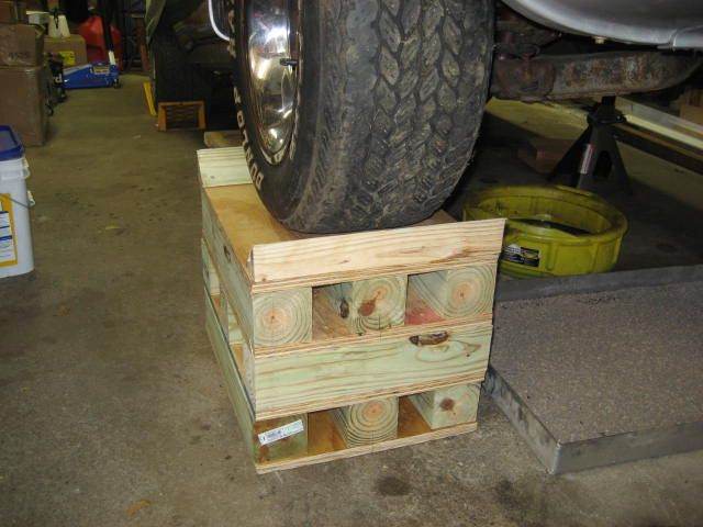

I built a set of wood stands that are very safe and gives lots of room to work under the car. Shown here is just the front lifted up. I have the car up on 4 stands most of the time to do work underneath.

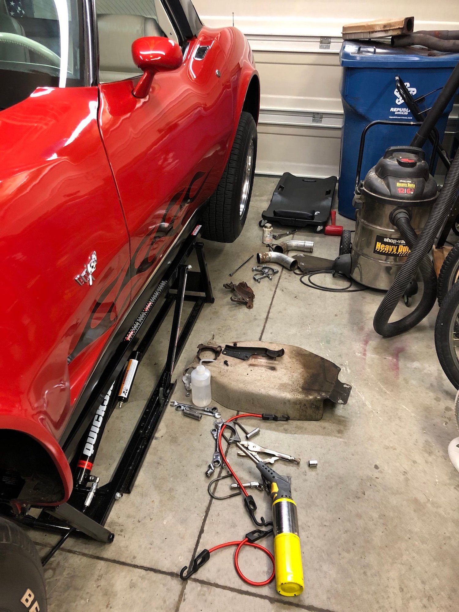

me as well....thus the quickjack purchase..and i had two jacks but always a btch with wide base jack stands let alone balancing act

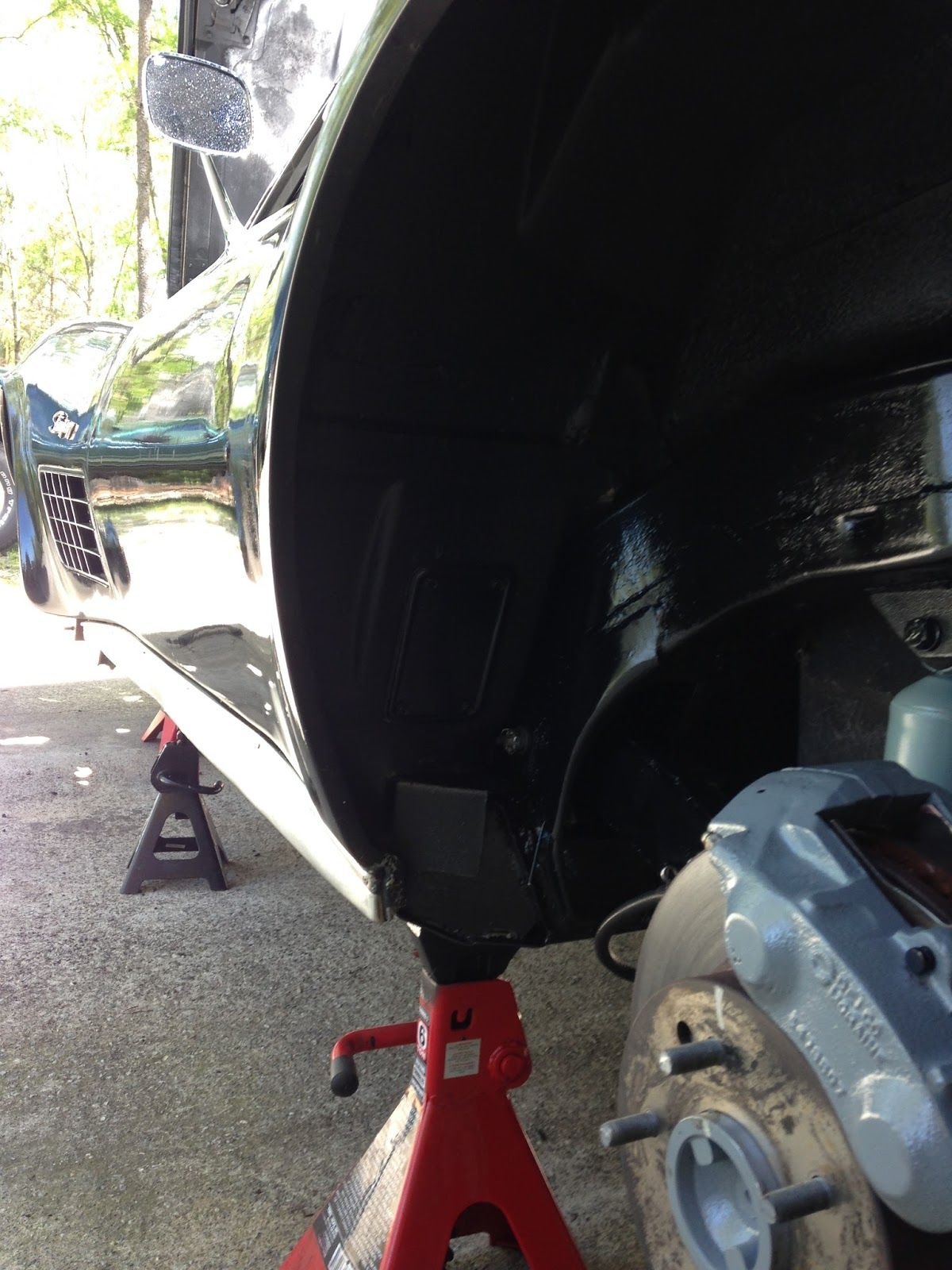

Be careful lifting the front by the cross member...That metal is thin and easy to dent. It's much easier to do with 2 floor jacks...I lift the front first putting the jacks as far forward on the frame as I can right before it turns up. Some where under the vents. I then put a set of 6 ton jack stands under the frame where the sway bar attaches. I then move to the rear putting the jacks far enough forward to still be able to get another set of 6 tons stands at the back of the frame where the kick-ups are located. When jacking up the car I bring each side up together slowly by rotating between the 2 floor jacks. I then add a set of 3 tons stands at the points where I jacked the front up. I'm getting ready to do some more frame cleaning and painting and if I can find my camera I will make a short video and post it. Here are a photos of my 72 up on stands.

I jack the front 1st then the rear....2 floor jacks and try to bring them up about the same time....Takes a lot of going back and forth unless you have two people.
I'll try to do a video this weekend.

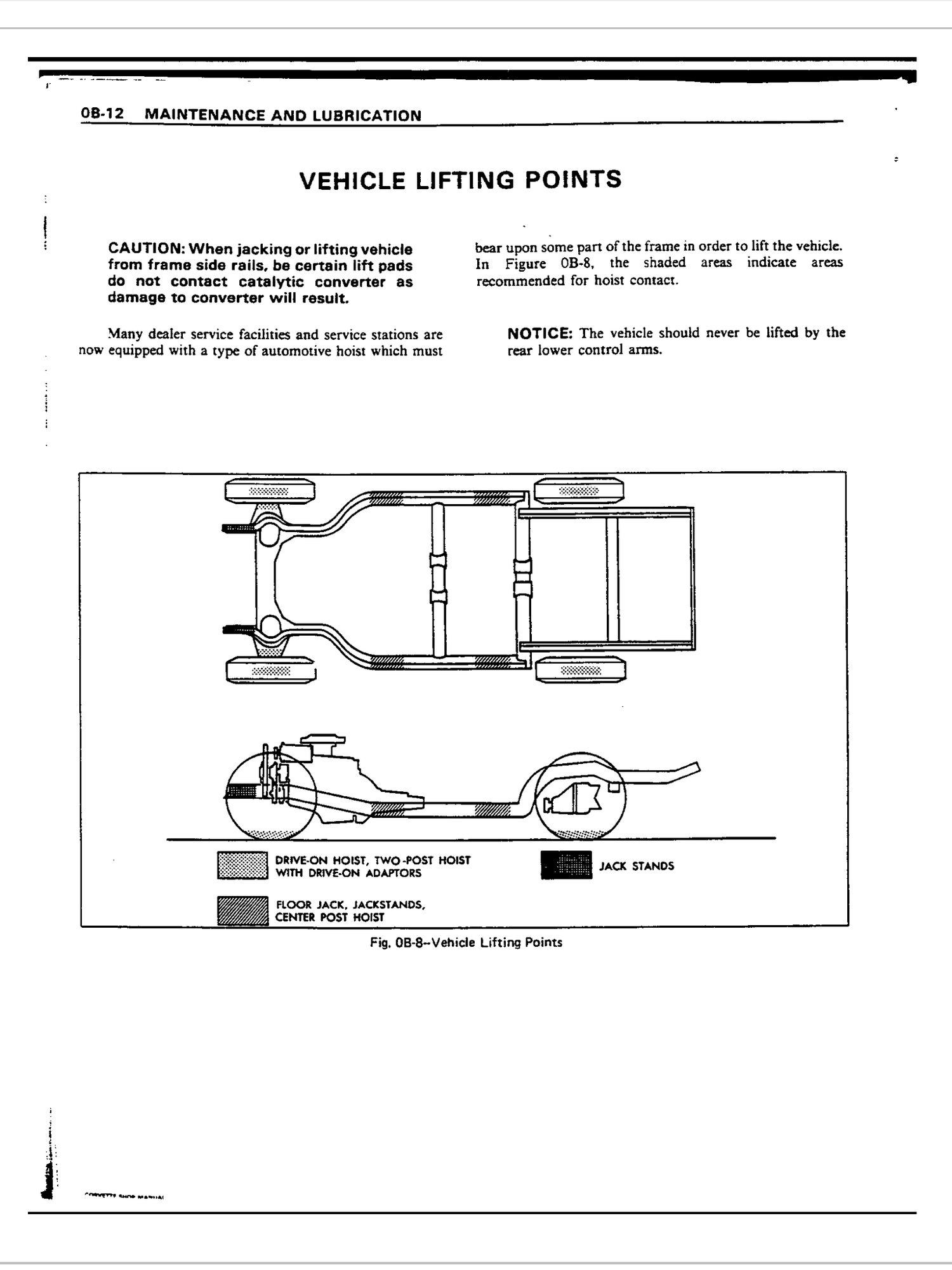

Here is a better shoot where the front and rear jack stands go....
Brian
