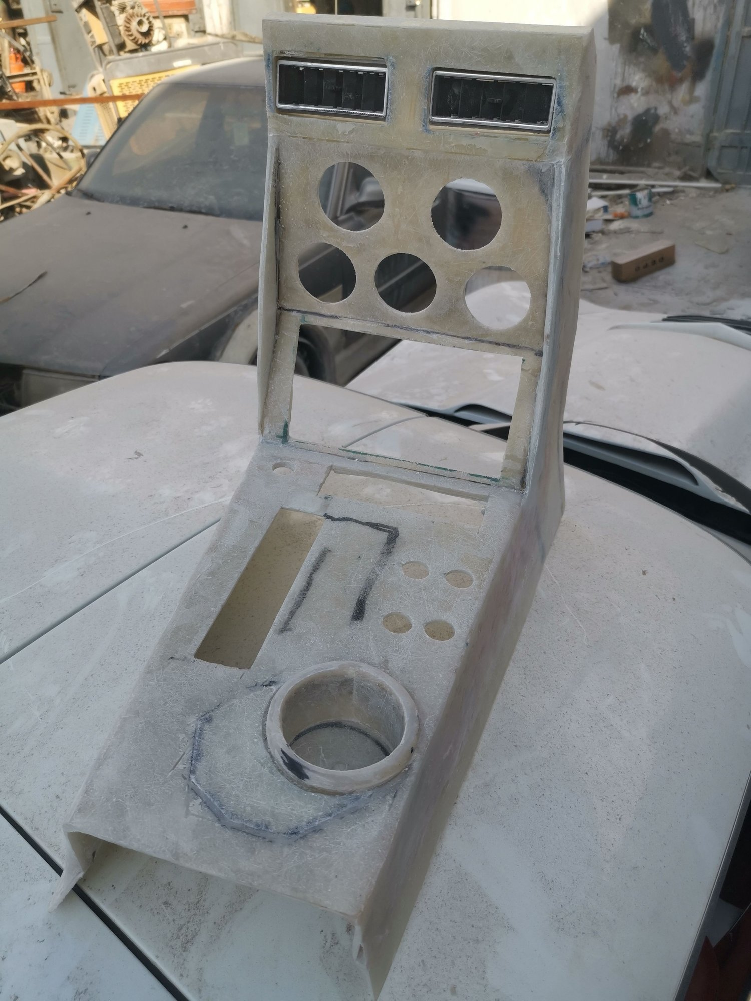

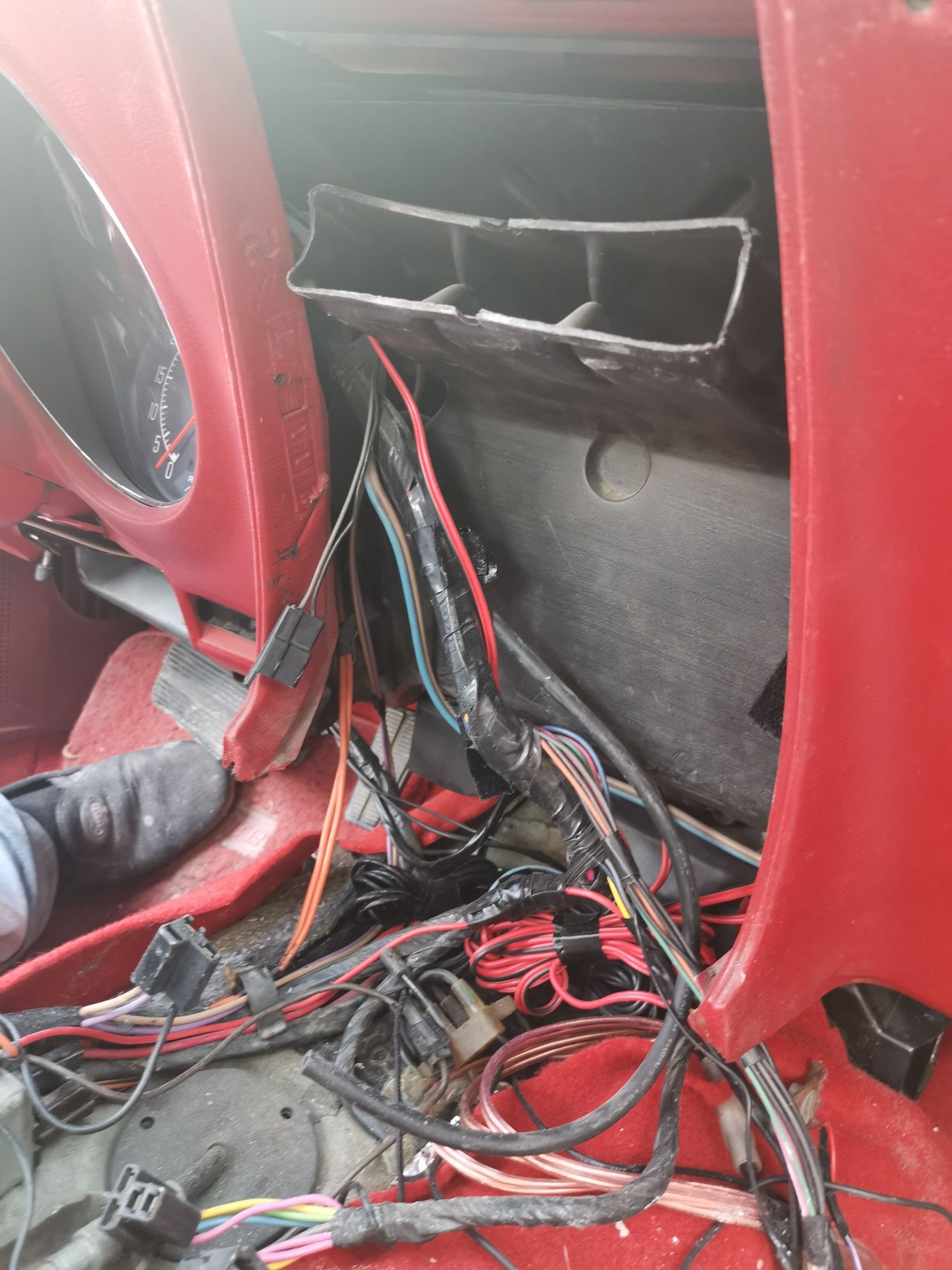

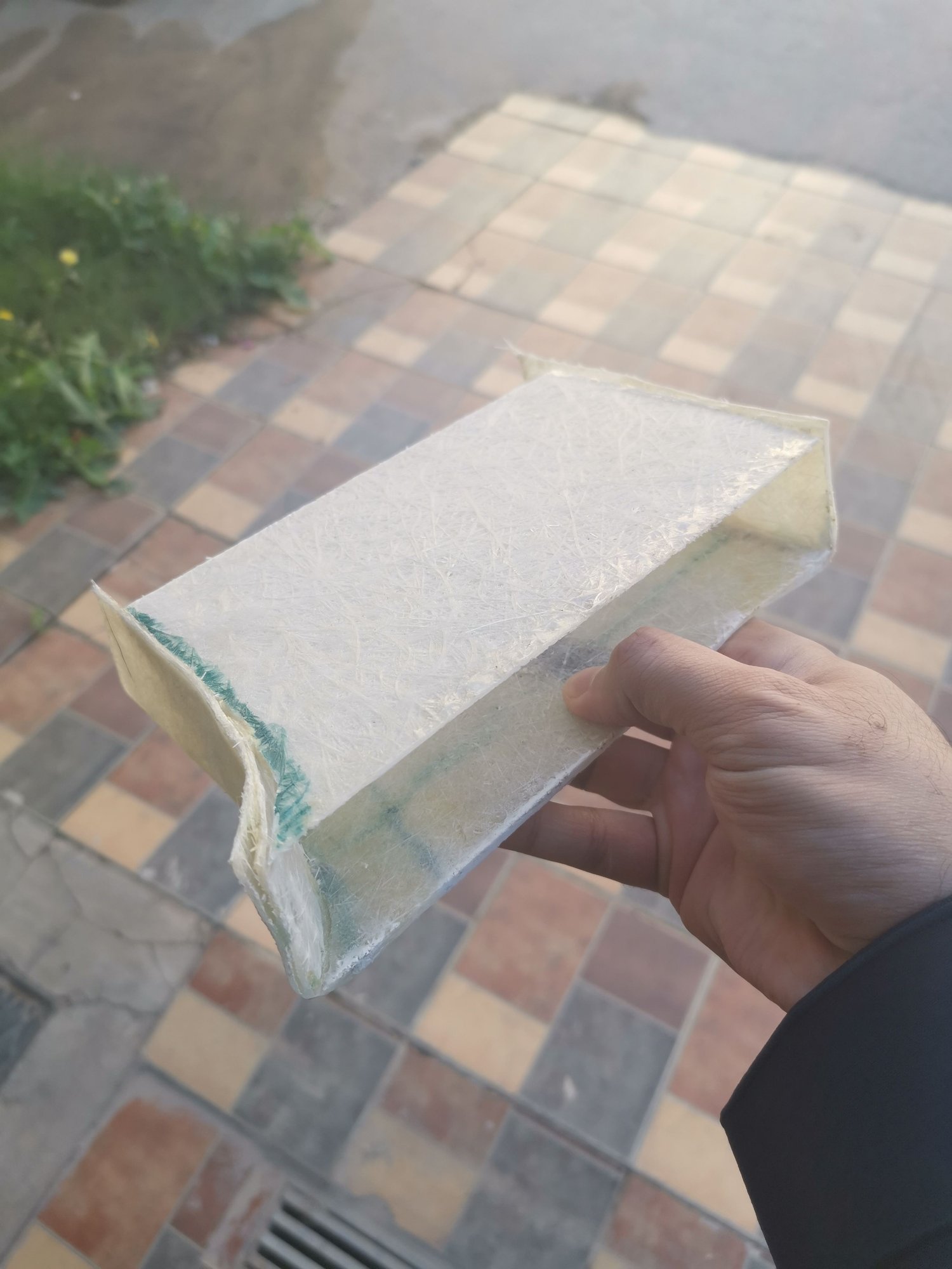

Hello
I just finished my 77 costum dash.I wanted to add a 7" screen. I am happy with the results but I am facing a problem with the inner Air duct under the dash. Now they are far away I cant connect them. We did try to fabricate a fiber glass connection but it didn't work, we need a more flexible material. Any ideas?!!!..

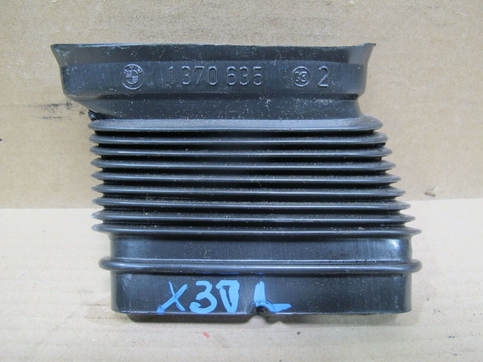

If you have a junkyard around you-
Look at the 5 & 7 series BMW they use large flexible ducting under the console to go to the back seats-

Thanks a lot that's will help
