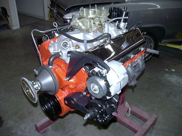

With the exception of the aluminum heads that's very similar to one of our 100% stock-appearing builds!
With a set of non-ported, 3/8" valve stem "840's" on a 9.5:1 C.R. we see 510+ HP @ 5900 and 480# T @ 4800. Same cam, 11-451-8.
This is also with the OEM "3885069" intake and 750 Holley.
Thanks, Gary in N.Y.
P.S. I see absolutely no reason you shouldn't see 550+ with the addition of those Edelbrocks?? Here's a shot of that very one we finished for the resto shop!!

I see you have the L78 hi Rise intake, I have to use the low Rise for the stock Corvette Hood.
