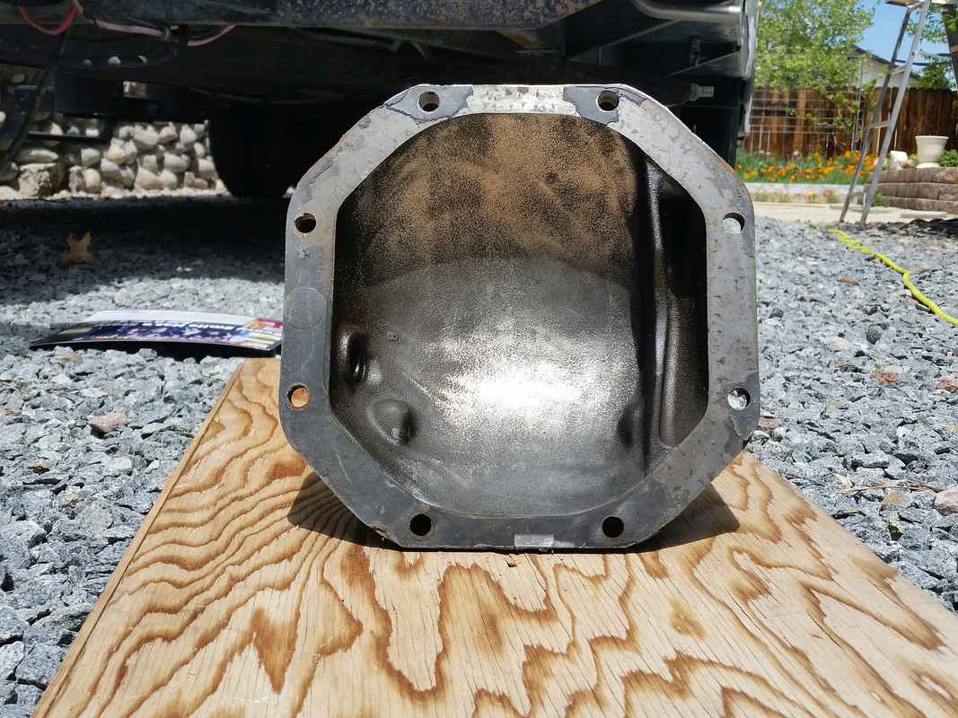

Drain Plug! When ever you have the rear end out, just go ahead and drill and tap for a drain plug. This is the latest 4.11 that I put together. This is Black Epoxy paint. I'm also a firm believer in polishing the inside to the cover. This one is a HD and they are well worth it. The casting is so superior and it used substantially larger spring bolts and plate.
Just polishing, cleaning, and getting ready to paint the HD diff cover

"Drain Plug! When ever you have the rear end out, just go ahead and drill and tap for a drain plug.". So you get to miss all the fun of cleaning up the gear oil that always misses the drain pan!

[QUOTE=gkull;1600758263]Drain Plug! When ever you have the rear end out, just go ahead and drill and tap for a drain plug. This is the latest 4.11 that I put together. This is Black Epoxy paint. I'm also a firm believer in polishing the inside to the cover. This one is a HD and they are well worth it. The casting is so superior and it used substantially larger spring bolts and plate.
Nice!!
