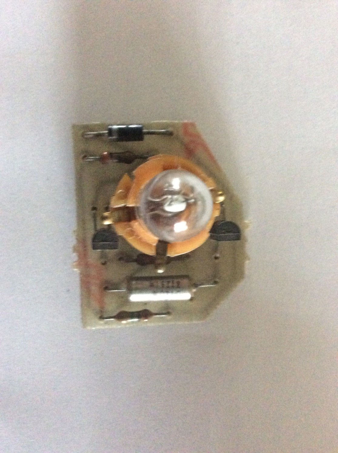

As I took the dash apart,
this fell out anyone know where it goes or what it is for. Thanks

Model year? Blurry pic, but it might be part of the seat belt warning light.

1979 ,older phone I took pics with. Do you know where it goes?

fuel low warning on back of gauge console?

That’s it. Thanks

I agree, this is my 79' gauges.

Before re-installing bench test the module with a known good bulb (194). The 6681E transistor on the module often goes bad. You can find a replacement transistor (Sylvania ECG-159) on e-bay for $3-$4. Mine had the suspect bad transistor, I repaired my original.
Willcox Corvette also sells a newer version of the low fuel module.
Willcox Corvette Module Testing Link:
My Module Repair Link:
