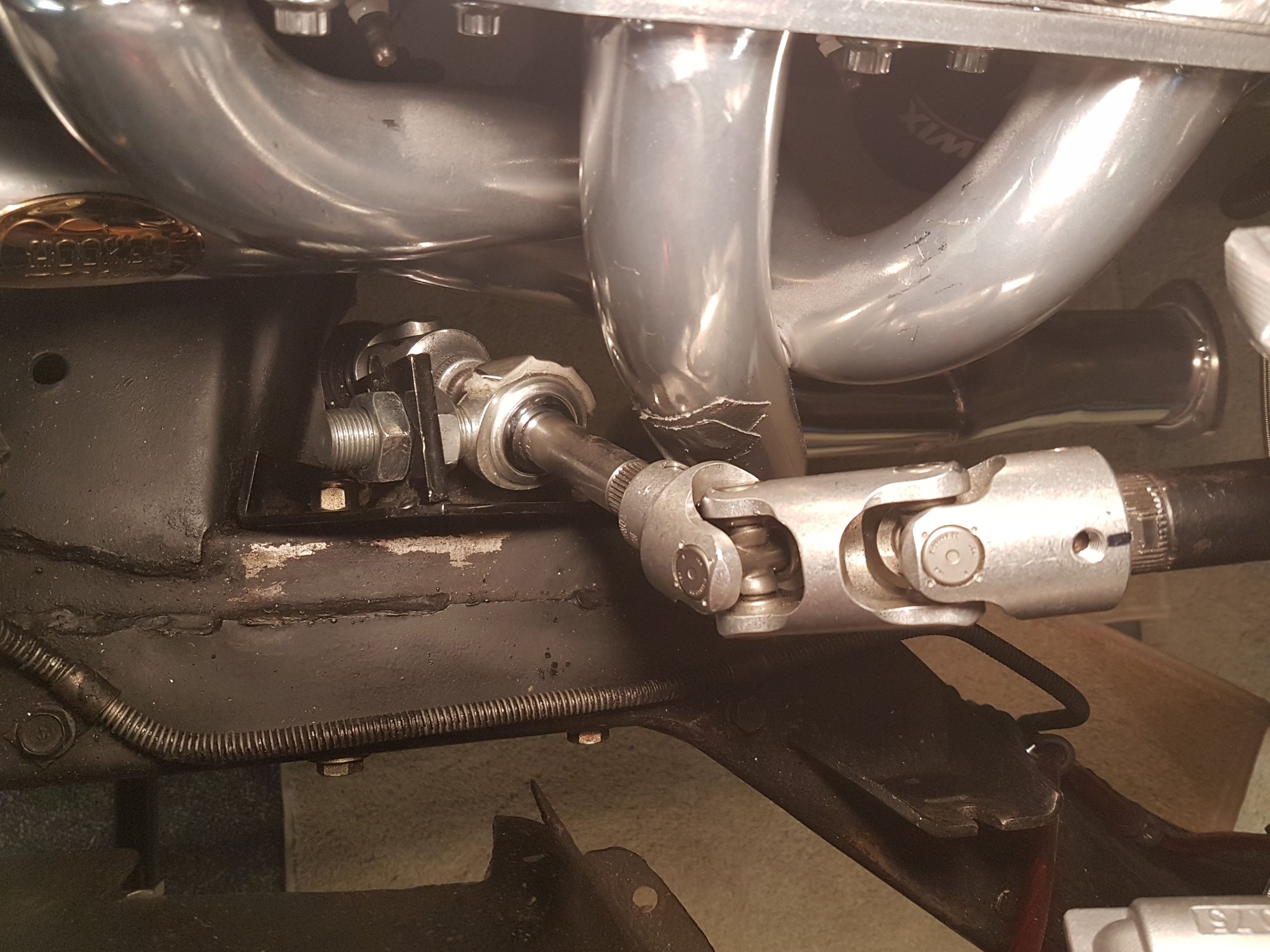

Hey All,
I am reinstalling the Big Block in my '73. The problem I'm having is clearance with the new 1-7/8" Hooker Headers with Steeroids. The Steeroids cleared fine with the stock cast iron manifolds. But now the #5 tube causes the steering linkage to go way out of line and bind up.
Is there another way to connect the Steering Wheel Shaft with the Rack? Or, are there other Headers that will have better clearance for the steering linkage?

I saw this. It shows Hooker Super Comps as being no problem...

Hedman with zero issues on my BBC

Is this what you have? https://www.hedman.com/product-detail/68091
These look like the same ones, except with ceramic coating: https://www.hedman.com/product-detail/66897
Did they line up with your stock exhaust, or did you have to get pipes custom made?

You may consider these or of course what Ddawson posted. https://www.sandersonheaders.com/san...ategory_id=649

I bought these and had them coated inside and out.
https://www.summitracing.com/parts/h...model/corvette
Yes pipes will need to be made to connect to the rest of the exhaust under the car.

Thanks everyone for your input. I bought the Hedman 2" headers. Now I have a nice pair of ceramic coated Hooker 1-7/8" Headers for sale!
