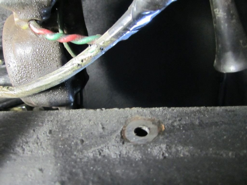

Mooser's Avatar
Mooser
Joined: Apr 2011
Posts: 11,183
Likes: 3,336
More or less like this

Mooser's Avatar
Mooser
Joined: Apr 2011
Posts: 11,183
Likes: 3,336
Seems to me I bought a "kit" that had that one, the one for the antenna plate, I think it was just those two but I've added some others along the way that GM probably didn't plan on.
Would have been either Corvette central or Corvette america, I would imagine Ernie would have access to them as well
M

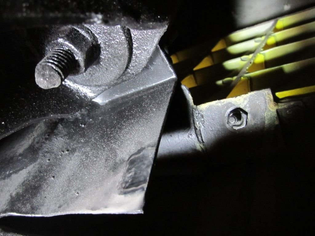

Mooser's Avatar
Mooser
Joined: Apr 2011
Posts: 11,183
Likes: 3,336
Originally Posted by 89LT1Camaro
Is that right behind the gills? I bought all the straps in a kit.
For mine (72) that you can see the egg-crates up higher in that pic, about the same location as your gills would be. That pointed bolt is the body mount bolt
