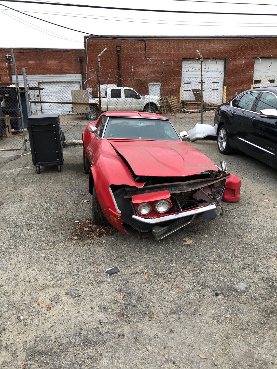

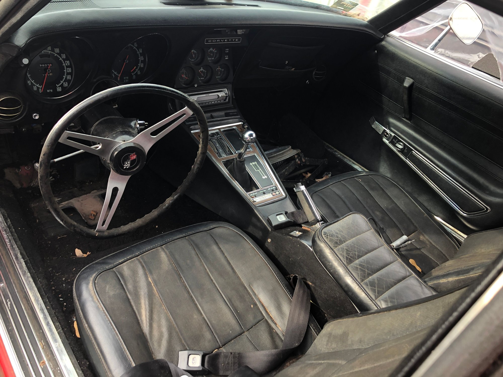

After the PO decided to drink and drive
This was before the car was wrecked
Steering column took most the impact

Hope you've had the frame checked for straightness. That thing looks like it took a pretty good hit.

Is that the 72 car in another members build thread here? Jakeinge I think.

Yep that my brothers car.

yes that frame in the picture is perfect, the one under the car is toast.

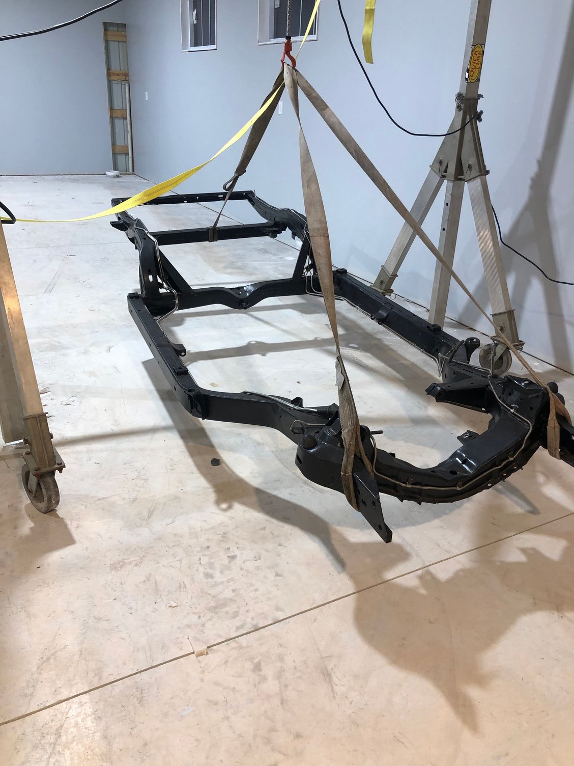

Default Update on frame assembly

Does the drivers door shut properly on that wreck ?
forget the red and black chassis , put that gold one under it !

hahah yea the doors do still open no damage to the car behind the firewall, and I wish that sr111 was but it’s for my dads 67

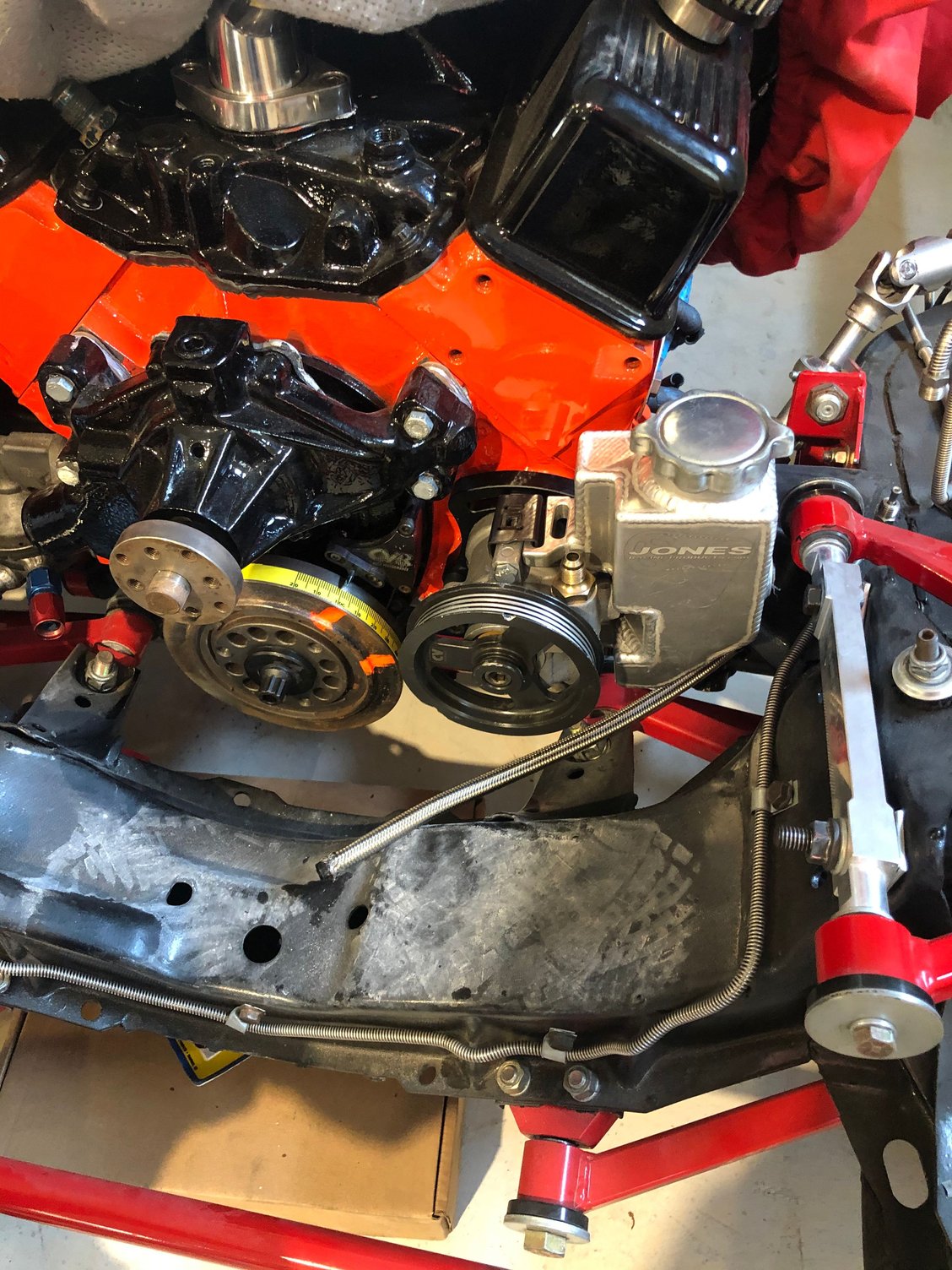

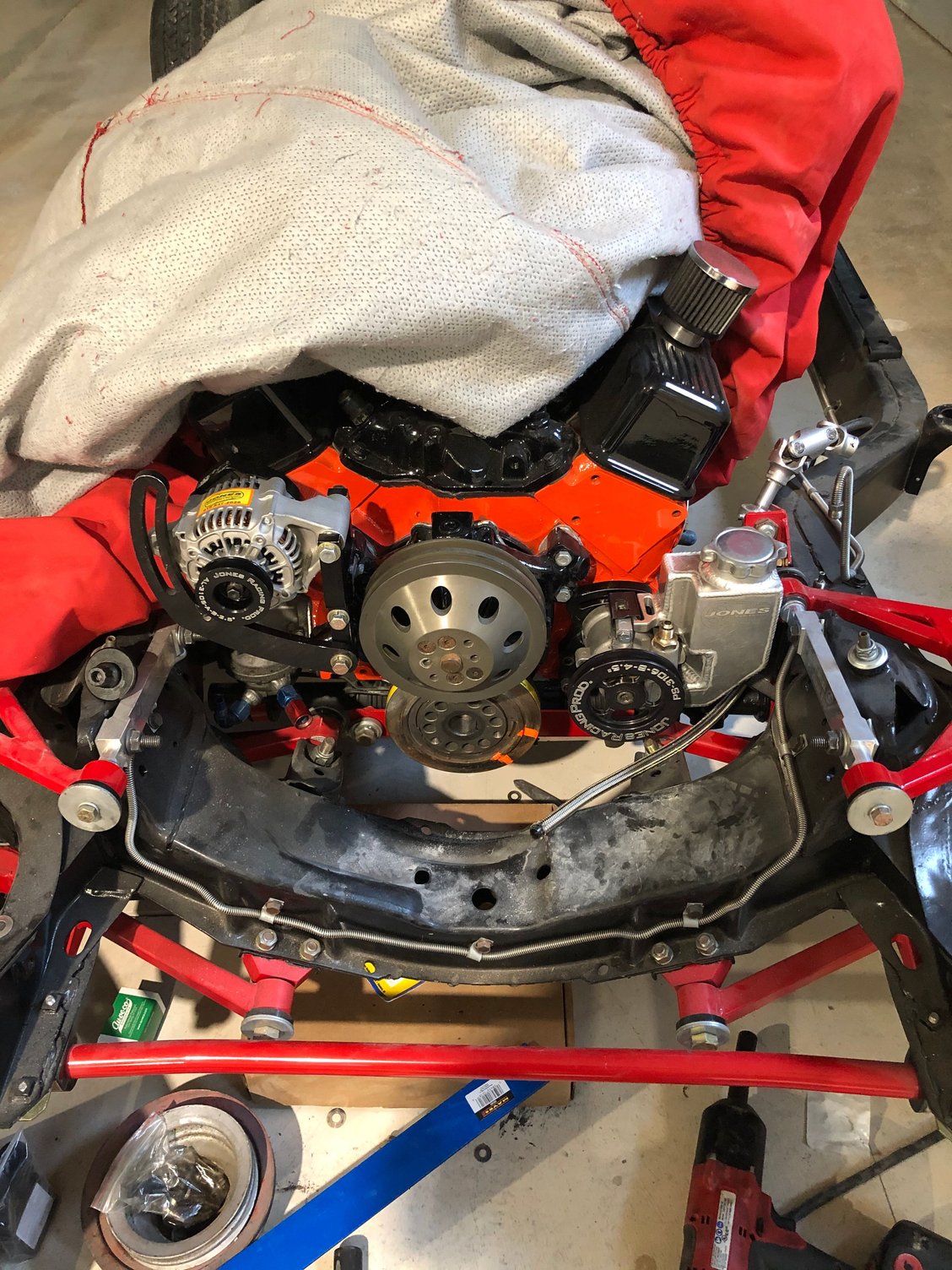

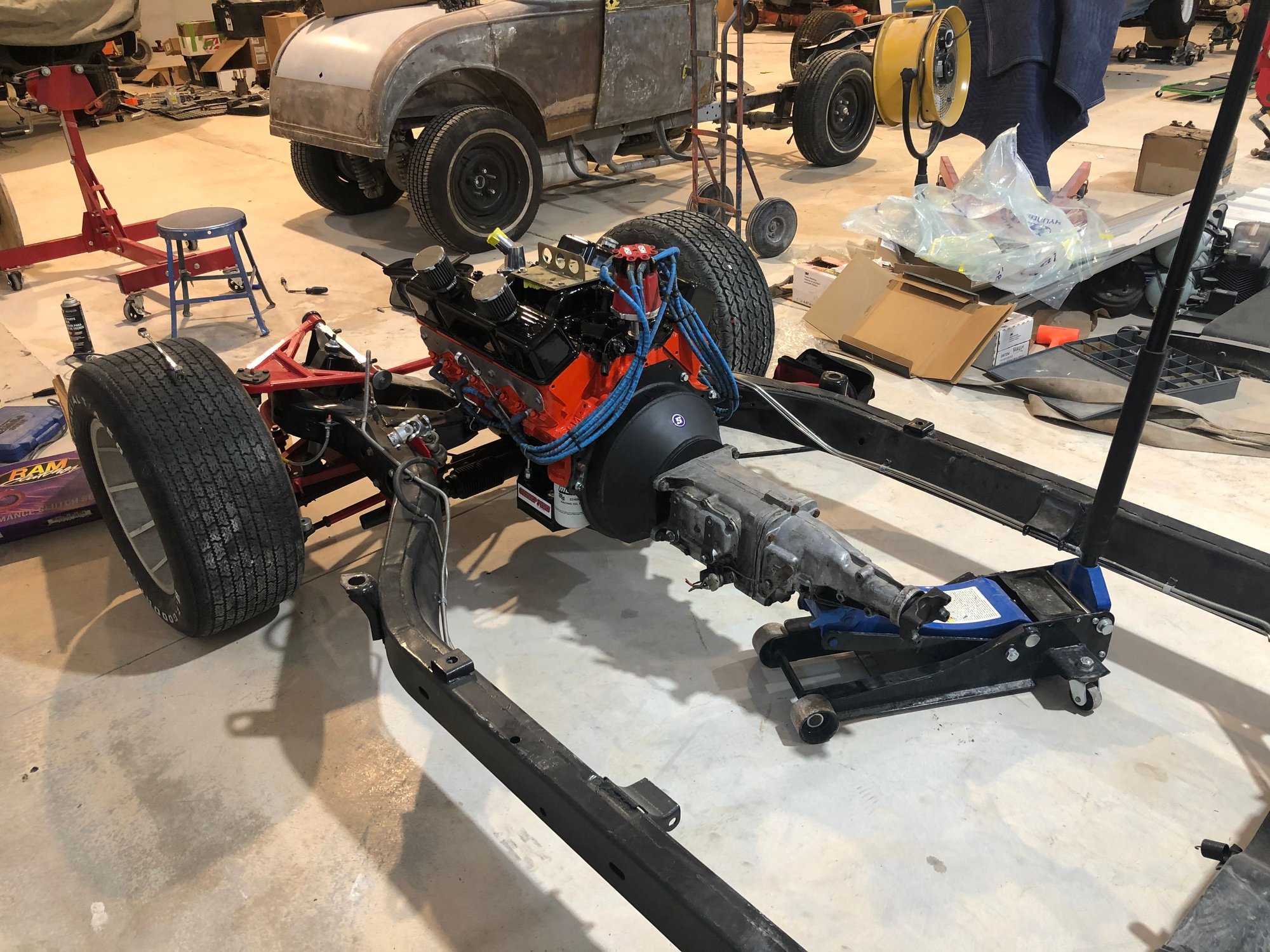

Default Engine in frame
Still need to build the crossmember
Power steering pump, should be perfect with my steeroids

Looking good , I like the look of the newer style pump on the sbc.
yea me too, it should be whole lot better than the original style pump

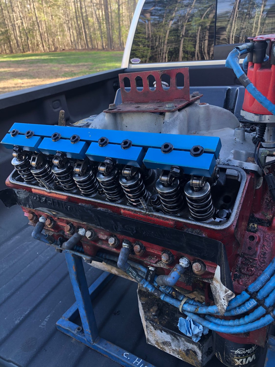

Default Engine
The motor is a Charlie High racing engines fully forged 4bolt 355 that came out of a late model stock car with 700 laps on it. Internals, Solid cam roller rockers with stud girdles carillo pistons and rods
and all the good stuff making around 440 horse and 480ftlbs with a 7200rpm redline! Should be plenty

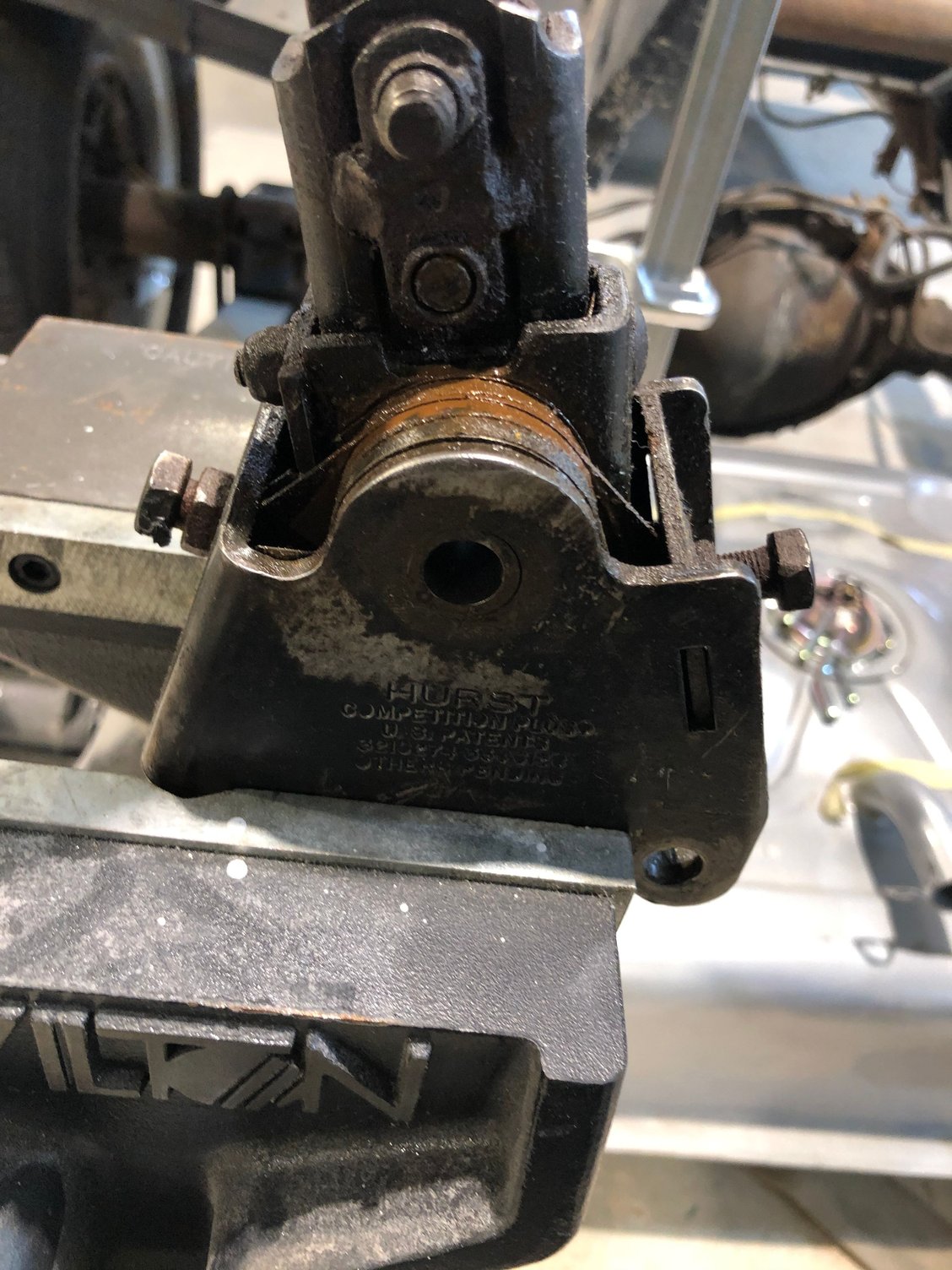

Default Trans and clutch
Transmission and clutch.
decided to go with a steel explosion proof Bell
housing just to be safe
clutch is a ram single disc diaphragm style clutch rated at 550 horse
flywheel is a neutral balance 153 tooth speedway motors
hydraulic throwout bearing is Howe racing made specifically for Muncie transmissions
shifter is a hurst comp plus that I bought used and completely rebuilt

That steering wheel in the wreck was flattened by someones chest, ouch.

that will be a lot more fun than the lt1 keep on with it
yea I think the 355 should be fun, if it would have had the original lt1 I would have restored it but it’s not worth hunting it down to me.
yea complete ruined the collumn and wheel, and his head got the windshield pretty good too!
