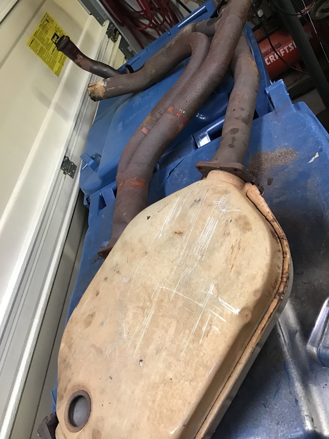

Unfortunately, it isn't a straight pipe. Here's a picture of mine (sorry, not for sale):

Yup that's a pic of what I am trying to buy. I did ponder trying to make one myself. The local exhaust shop won't since they already told me no way do they want to be involved with it. I believe they are worried about their state safety inspection license. I really don't wish to get them jammed up. Sure with I could find one. My car is down until I do.
