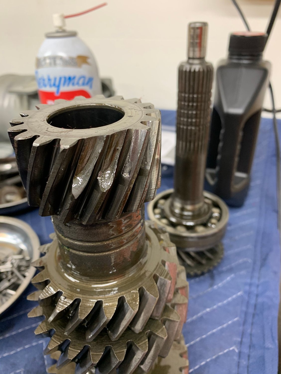

So I pulled the transmission out of my 1981 because first gear was knocking and found 2 teeth missing on the cluster gear. 1st gear always had a light tapping but the last time I drove it the tap became a knock. 3rd gear has always been noisy as well. So I'm going to have to do a full rebuild including a cluster gear and 1st and 3rd gears. I see the parts are readily available but it looks like this transmission came in at least two different gear ratios and I want to be sure I get the right parts of course. Did the T10 in 1981 come in more than 1 gear ratio and how do I tell which ratio I have if it does come in more than 1?
Summer teeth becasue som'er there and som'er are not

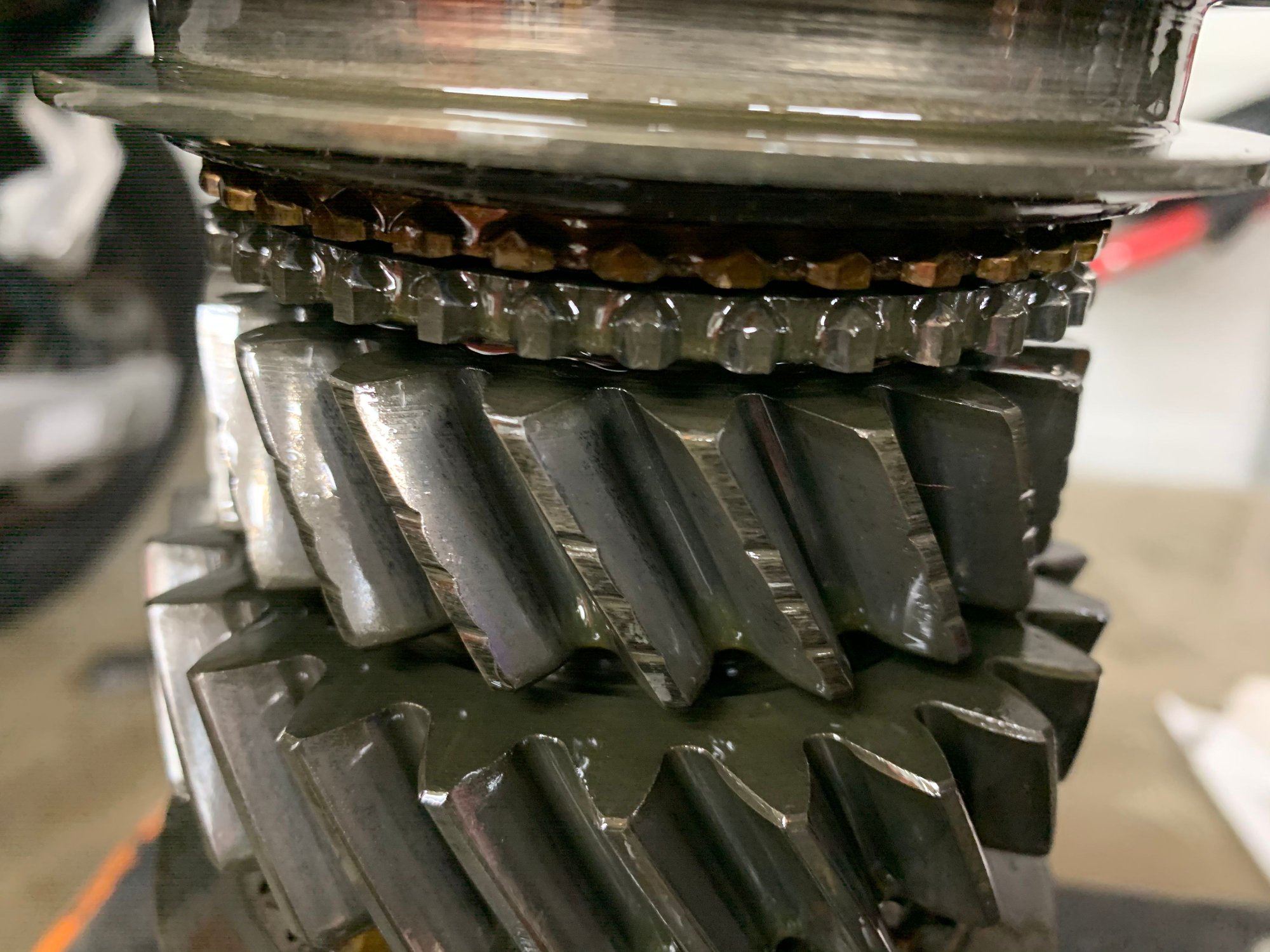

Weird wear pattern on 3rd gear, not sure what caused this.
