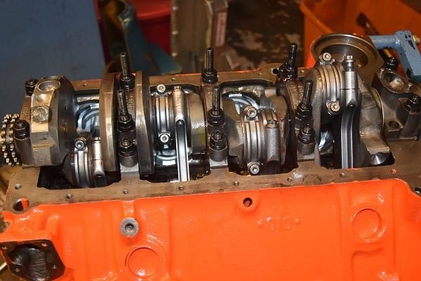

The Bearings that came out of this Motor are the best I have ever seen in any engine I have ever taken apart. They looked like the Engine had never been started.

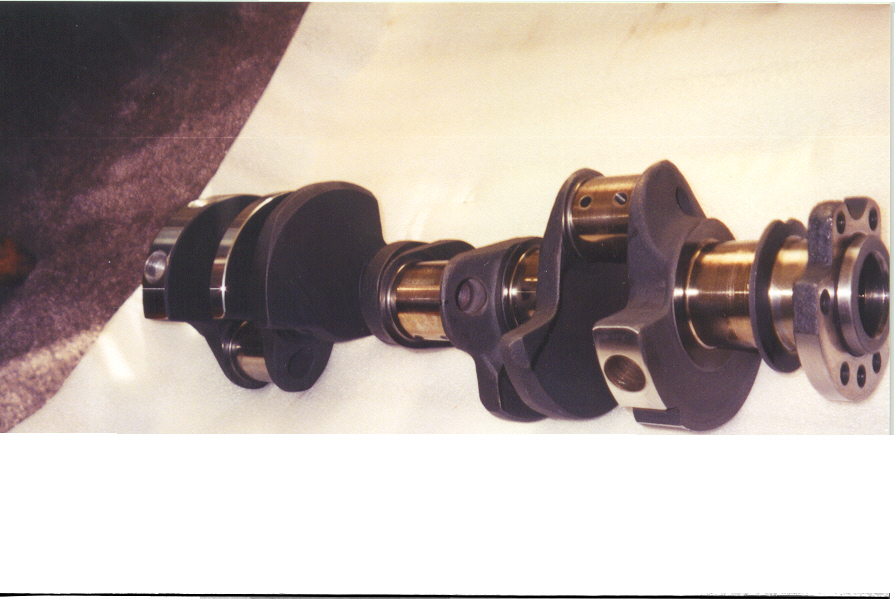

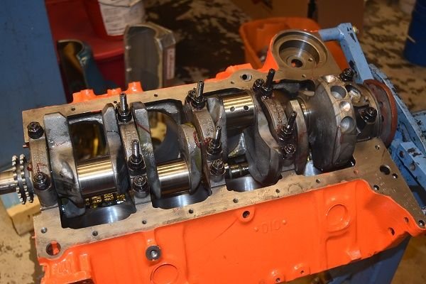

Things are really escalating now. Since I had to buy new Pistons I figured I might as well go with the 6 inch Rod tech. Scat H Beam Rods. Piston Rod weight was less than before, so Crank got Welded to bring back in balance.

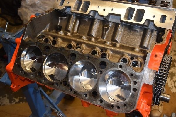

ICON Forged Pistons. These things look like a work of art right out of the CNC shop. Hate to bury them inside a motor and get them dirty. I cut 3cc off the Dome to get a True 11 to 1 Compression.

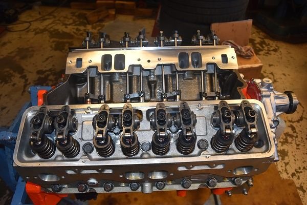

e-bay produced a set of AFR Street 195s that somebody had machined the AFR off of so nobody but me wanted them. All the Crower Valve train is left over from before.

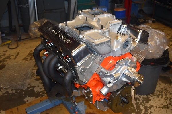

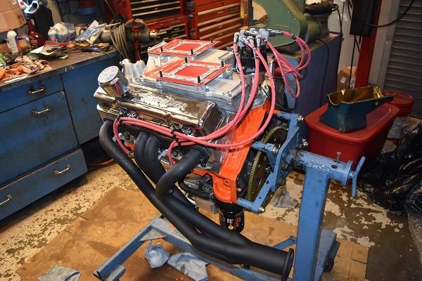

Coming together nicely now. Got my 45 year old itch for a Cross Ram cured. Note how somebody has machined the AFR off one head. Hooker 3/4"x 26" Imported all the way from China.

This is about as far as I'm going to get on this round. My day job working in Alaska is going to put me on hold. I found it odd the Accel Header Plugs were hardly any shorter than a standard NGK. I thought I remembered them being lawn mower size.

So the one real odd part of this build is that I don't know the Cam timing. I just re used what I had. Its made 375 HP with 16 inch's vacuum with 8.0 to 1 Compression and no Boost on an engine dyno. The cam is to old for Crowers web site to work. A call to them and a dig threw there Paper Files produced a hand written Note from Crower himself . I guess he wasn't known for his handwriting . .487 lift and a 114 Lobe center is about all that could be made out. It also had a date of 1989 and I know I had it prior to 1987 and it was not in my name so who knows what it is. I was planning on installing a new cam and I filled out just about everybody's Cam Shaft builders web page and didn't get a single reply. Not one. Guess nobody wants to sell a new cam anymore. So it was time to put things back together and that's what I did. I am building this motor as a dedicated Autocross car and I think it will make some decent mid range torque.

If You have a good eye You will see a Holley Duel Sync Distributor installed and yes that is intended for a Duel Sniper FI set up. Old School meets New School after all.

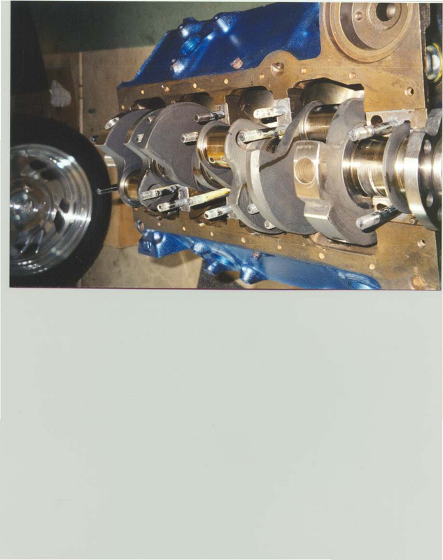

It's kinda late now, but I would have installed billet main caps. You had to add weight to the crank with welding. My original 383 with 3970010 block got the blue printing machine job and I think milodon billet 4 bolt main caps. I cheaped out instead of doing the spayed cap idea. I used the H bearings, hivol oil pump and installed enlarged oil restrictors in the back of the block. I tapped and put vent tubes in the cam valley for windage. That poor motor got to do 7500 rpm nearly every day of it's life with 11.2 C/R and the help of a solid roller and Dart 227cc heads.
Anyway I'm a firm believer in billet main caps. It's the way we built all the stock block 360 class sprint car motors. So mine was built the same

A buddy has a 509 400 Block he was willing to give me for this build. I was planning on doing the splayed Caps and build a 377. But I just wanted to keep it simple and reuse everything I could. I did use ARP studs for the Caps this go around.

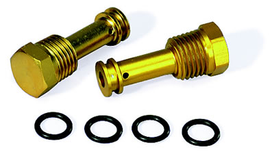

Studs really keep the block from warping or distorting. To use billet main caps you have to machine the block to fit them. What years did you do the Nevada 100 open road race? What Aerodynamic changes did you make to go over 160 mph? This is my 42 pound 3.750 black nitride 4340 and oil restrictors before you drill them out.
42 pound 3.875
