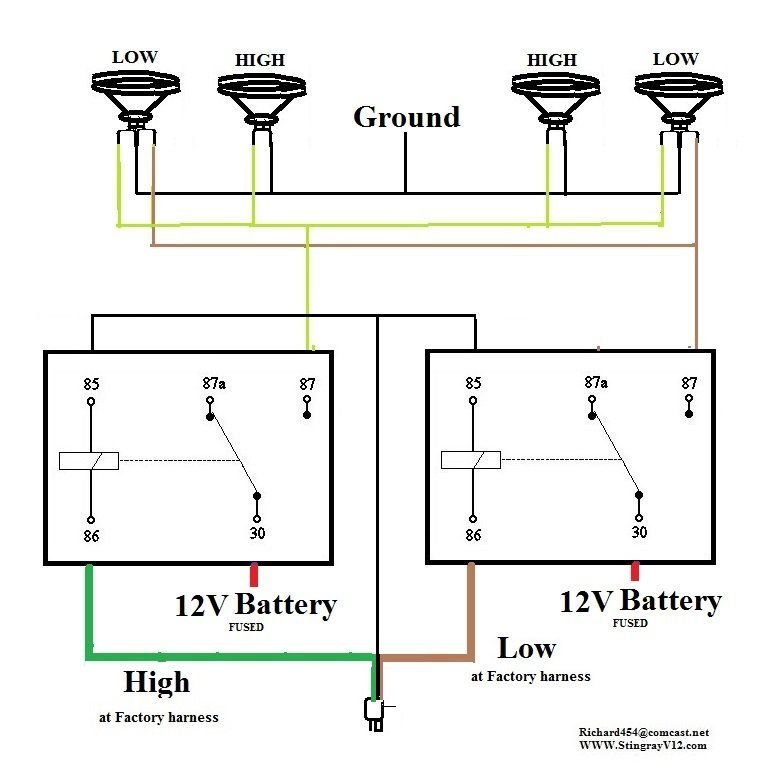

The headlight switch has a built in circuit breaker- although halogens with the same wattage won't pull more power than the stock- unfortunately the repo switches are "known" for this.
Best cure is a couple relays to take the full power of the headlights going through the switch-

Save yourself a lot of grief and install a pair of aftermarket headlight relays. Completely solves the problems related with new halogens and old wiring. I install the relays on all my vintage cars. Less load on that vintage system and headlights much brighter.
Do a search on this forum, you'll find several good threads on it.

Sounds good, I wanted to do the relay upgrade (I actually have them all in a box in the garage) I'll tackle that this weekend. I upgraded my lights to the Dapper Lighting Projectors with the 30Watt LED bulbs, but any stress off the system I can take, I'll do. Such a quick response from you guys! I'll hopefully update with the fix.

Mounted and ran the relays for the headlights this weekend, everything is up and running well. Let the high-beams sit on for a few minutes and not a single flicker at all! Followed @Richard454 wiring guide and went all too easy, Thanks again for the help! Nearing completion of the full rebuild and upgrade to 30Watt LED bulbs with Halo's and turn signal switchback, unfortunately the driver low beam had a factory defect in the halo soldering, so a new one is already on route. once it's finished up, pics to follow

Your headlights get power in a very convoluted way-
Power runs from the starter- through fusible links across the firewall-
Then through the bulkhead connector to the ignition switch and the headlight switch-
From the headlight switch to the dimmer- back through the bulkhead connector to the headlights!

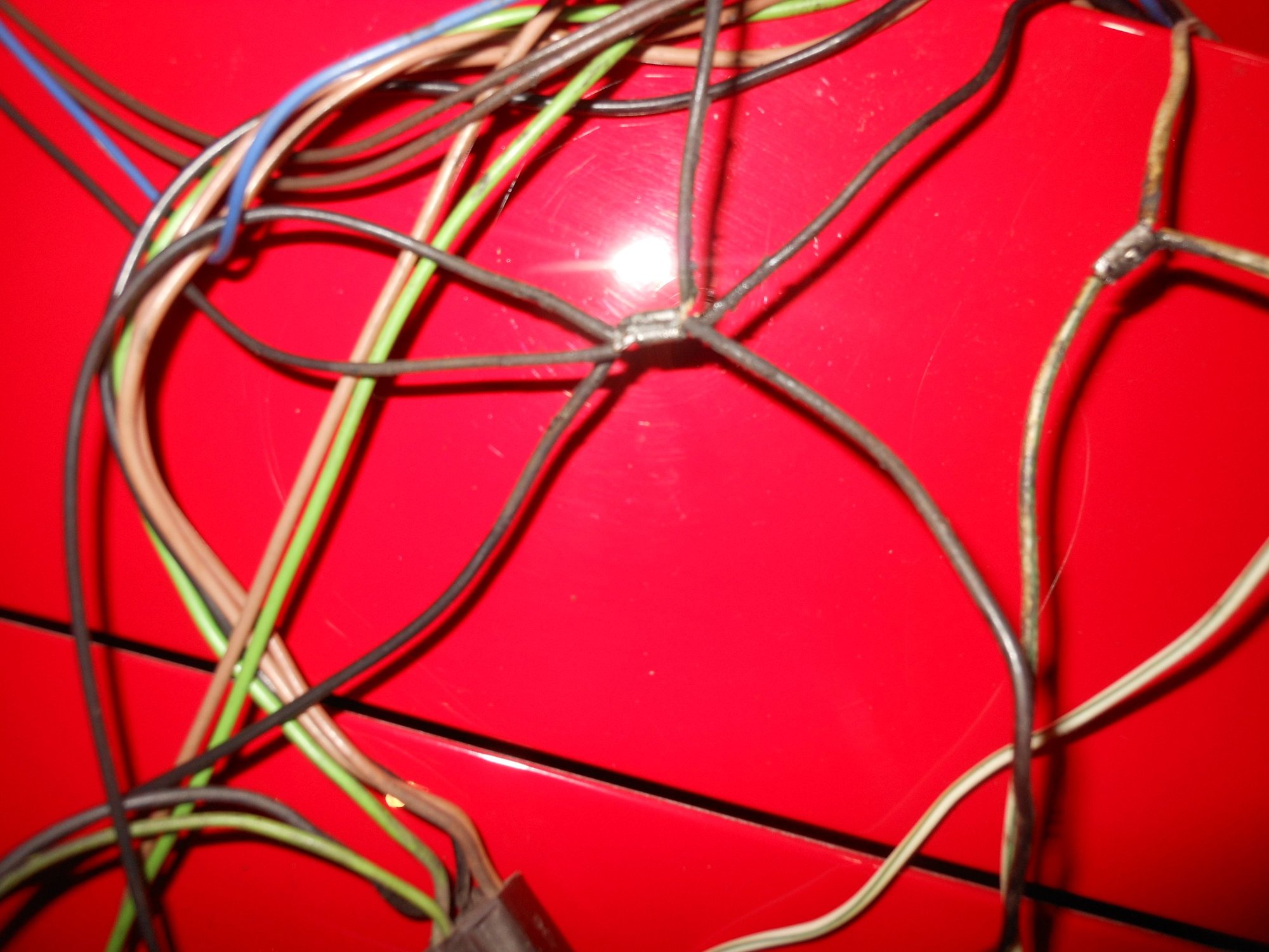

AND at the headlights- this is how the convoluted grounding is done!!! Se below.
Also inside the headlight switch- the power travels through a bi-metal strip.
If too much current flow through the metal- it heats up- expands and disconnects the power to the headlights-
As it cools down- the power is reconnected.
Repo headlight switches are notorious for the "strip" not be incorrectly rated- especially when hook it up to 50 year old wiring.
Thus causing the headlights to turn off and on
Should you use relays- which get the power directly to the headlights? YES!!!
It bypasses the higher amount of current drawn through the headlight switch- the relays pull way less then 1A of current.
