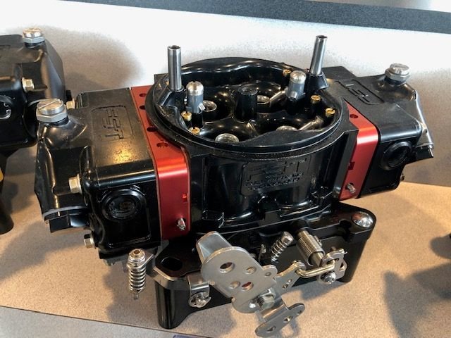

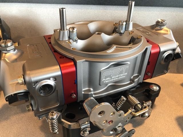

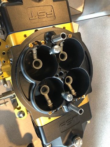

With my 406 SBC progressing well, I am trying to decide which Holley style double pumper carb to buy. This is not a thread about recommendations on carbs configurations. I am installing a mechanical secondary, no choke, 750 CFM, Holley double pumper style carb. But as you know, there are multiple manufacturers (all mostly owned by Holley). Choices...Holley, QuickFuel, Brawler, etc. I am looking for any pros / cons to any particular manufacturer.
I am fortunate enough to live close enough to Summit Racing in Ohio that I can visit their superstore......its a toyland for us motorheads, and I did yesterday. On display they have FST carbs, which I never heard of before, but they are stunning in their appearance. On a wall of carbs, they are clearly the most clean and quality looking carbs out of all of them. BUT, that is not all that counts, so I am curious if any of you have used them, or had any rumor / experience. FST is based in Michigan,.....but not sure if these are made in USA or just Chinese products marketed in USA?? What you say. See pictures, they are impressive looking.

Those are a beautiful piece of work. Downleg boosters are good, but if you want the ultimate in the street driver I would get something with annular boosters

I really only recommend the HP series classic Holley......they just work so well on anything.......I run a modded 750HP on my own 406 and it is awesome.....probably flows about 780 or so.......and it uses every bit of it.......
The FST is pretty....but let some time go by before committing......
If you really want the ultimate....contact Patrick James at Pro systems and have him build a custom HP for you from your specs.......not that much more than an out of the box Holley piece.

Don't know anything about those FSTs but I guess what it boils down to is availability and cost of replacement parts. With Summit just minutes away, its easy and affordable for you to obtain Holley parts. But what if FST parts are two or three times the cost and always back-ordered?
Mighty handsome looking unit though. And it appears to have the better blue gaskets on the M blocks.
You may have to shorten the vent tubes if running a drop-base air cleaner. I assume the secondary throttle shaft has an accessible adjustment screw?

Quick fuel 750 annular booster carb I was thinking of has an electric choke your not wanting. Not many 750 sized carbs have the annular boosters there mostly reserved for bigger carbs, not to worry the down leg would work fine on that size carb.

I agree.....if you size the carb proper.....you do not need the annular booster.....and annular boosters on everything I have ever run them on go pig fat upstairs.......
Everything I saw, read and desktop dyno'd said I needed an 850 carb......so I bolted a 750 on it.....put thin throttle plates and polished the venturi out to get rid of the casting mark.....it works perfect on the street.

ya annular has advantages and disadvantages the down leg should work real good on a 750. be nice if holley would just throw away the strait booster stuff and forget they ever used them in anything.
