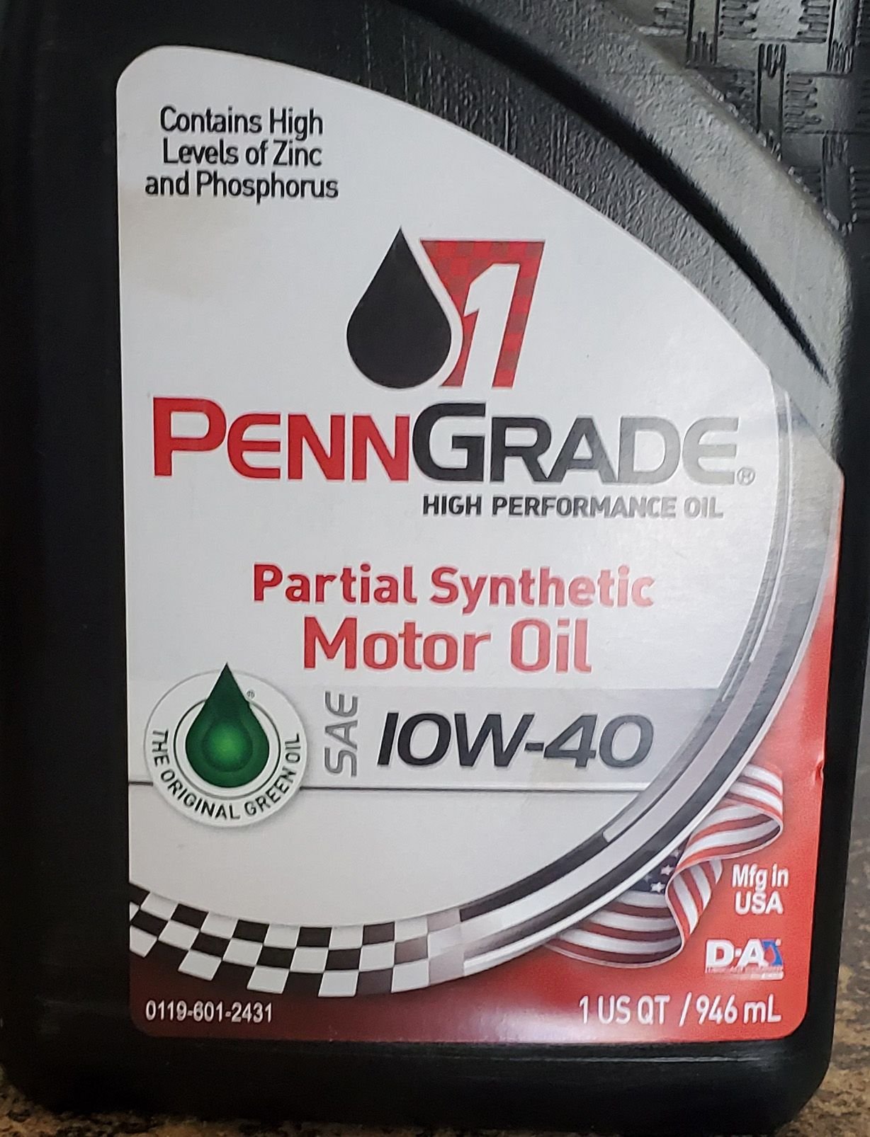

This is what I used when I had Flat tappet lifters.
