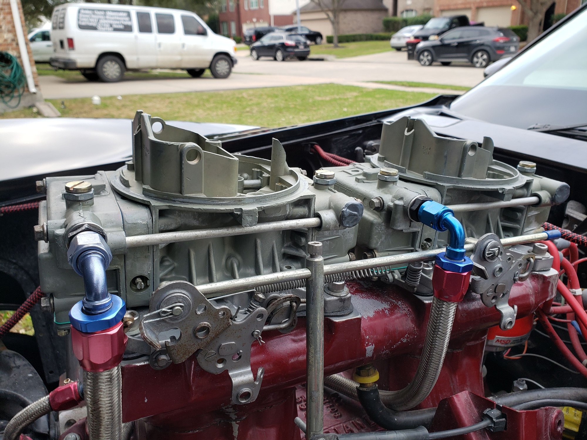

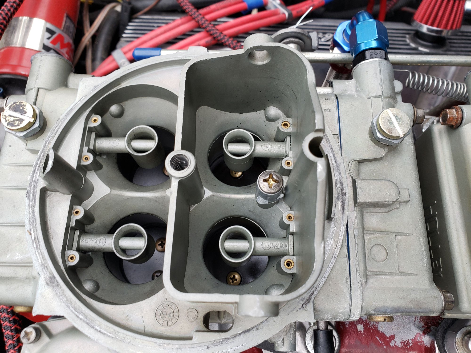

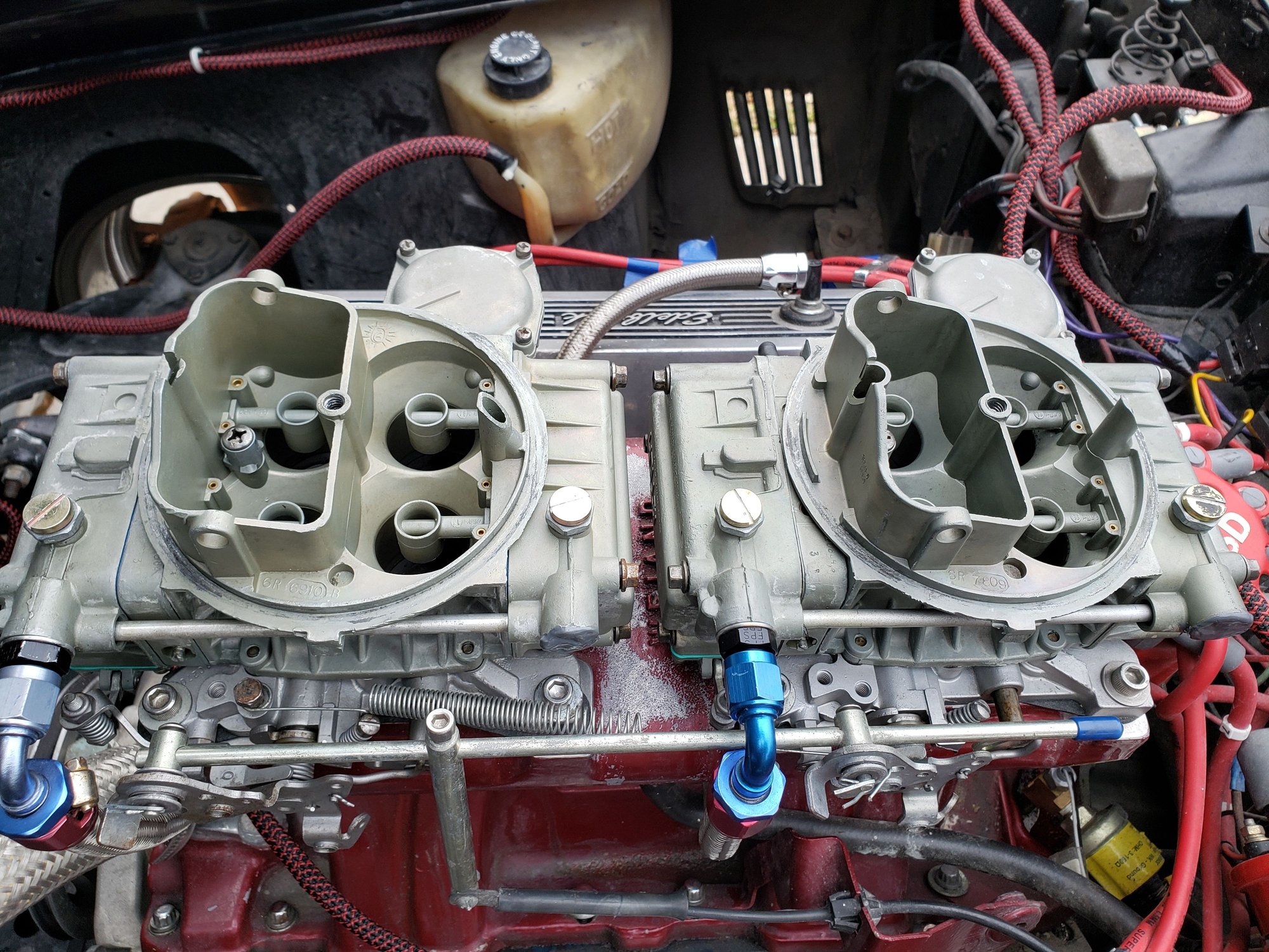

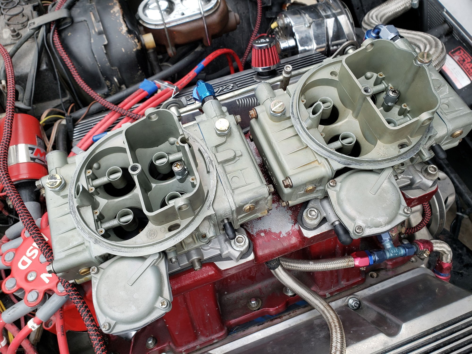

Here are some pics and a video.
Pics are with motor off.
Link to YouTube after a short drive

Ok
now we know you have 2 holleys, and no choke.

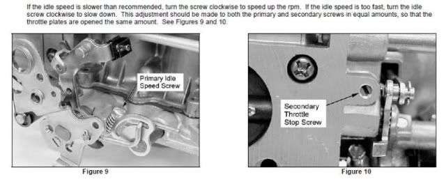

This makes the throttle adjustments even more important. See this link and this pics.
Basically all 4 throttles should be open the same amount at idle. If it idled well at 800 before it can do it again.
http://forums.y-blocksforever.com/Topic131647.aspx
Secondary idle speed screw
transfer slots appear "square" or .020" long all four should look the same
