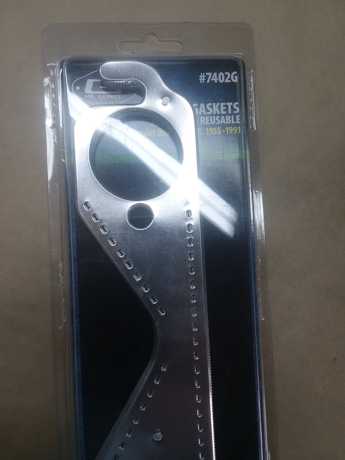

A few days ago I was driving my '77 with about 150 miles on the rebuilt engine, I gave it WOT to test the 2 -> 1 kickdown on the new Bowtie Overdrive 700R4 and immediatey heard a new noise. When I got it home and in the garage there was a ticking sound from the right side that matched engine rpm. Today I took off the right side header (Hedman 68301) and this is what the gasket looked like. The bolts were tight. So I am going to replace both sides with Mr. Gasket 7402G, high performance 1/8" thick multilayered aluminum gaskets, anyone have any experience with them?

My engine builder told me about the gasket sealer only option, he recommended Permatex Copper. I am going to hold that on in my back pocket and use it if the aluminum gasket fails,
The bolts on the side that blew out were still tight. Interestingly the ones on the other side which are much harder to access were not tight but no blow out. There was some carbon buildup around the runners though. I am aware of the splitting-the -flange option but putting a stratigedge across the ports shows they look pretty flat. Since the aluminun gasket is designed to crush .060" it sure seems that should be enough to compensated for any slightly uneven surfaces.
Hoping that someone has used the aluminum gaskets...with either good or bad results

What does the backside of your header flange look like......those round port gaskets seal round port headers.....if you have standard 1 5/8" headers, then the 1404 Fel Pro is what you want.....
From your first pic it doesn't look like you are sealing all of the flange.........
Jebby

A quick look shows that everything matches up (all circular holes) but right now the headers are hanging loose in the engine compartment, I haven't pulled them out yet. Looks like I need to do that because taking a closer look I think I see why I had problems getting all the bolts in. I think they weld the runners to the flanges and then ground away whatever weld went into the bolt clearance holes. They may not have cleaned all of that out, looks like I can take a die grinder and open that up a bit. I don't think I looked at that closely when I did the installation, maybe there was some binding going on so the bolts felt tight but they weren't pulling the flange down on to the head.
