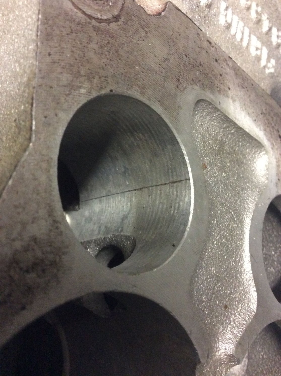

Just found this crack in my manifold

You sure that's a crack? Seems too straight. Might be an index line from some process.

I am so “gun shy” at this point.... thanks I went over it with my Dremel flapper and it disappeared.

I had a crack appear on my world class heads after assembly. It appeared it radiated out from a bolt hole. I could catch a fingernail on it and everything. I bought some new aluminum heads and while i was removing the old heads I was playing with the crack and it came off the head. It was a stringer of the gasket sealant that had happened to fall accross the head. It can happen to us all.

Hah, had that happen on a set I recently did was sure it was a crack. Stringer of jbweld, sure did look real til I ground it off. lol
