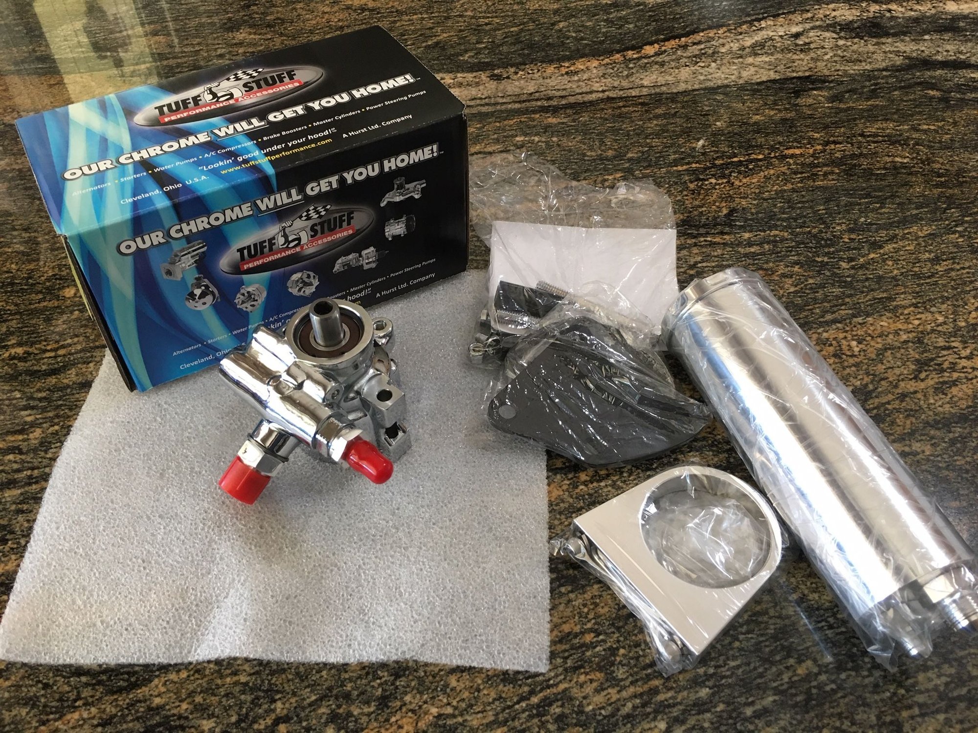

This is the setup I'm converting over to which will be powering the Borgeson Box.
I will be using a stock size pulley.
