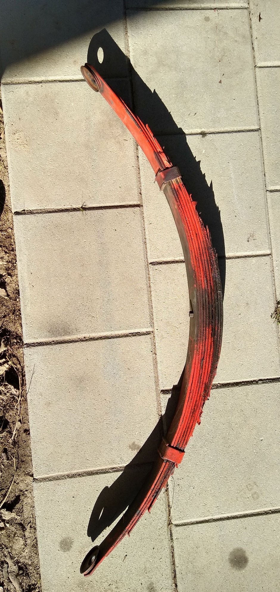

Had time to pull the spring out so I can attempt to remove the broken bolt, hopefully with no issues. This spring has 10 leaves and that's including a very short one on top. This spring has what I think is anti squeak material between most of the leaves. I ordered a new 9 leaf spring today, I decided to go this route with the steel spring to keep cost down. I have found that the front bushing on the rear arms are shot, so they are on order as well. Hopefully I can have them out and back in by the weekend. leaf spring may take longer to be delivered. If I understand from MelWFF is the bands on the end of the spring should have been removed before installing. I assume the new spring with be delivered with the shipping bands installed as well and should be removed? Now, a question, if the new one does not come with the anti squeak material, would it be acceptable to use the material from the old spring? I will be disassembling the old one anyway, will be using the leaves as blades and tools as I forge a little bit.
Old Mar 7, 2020 | 08:42 PM

and make your ride height resemble a monster truck

If I understand most of the posts I have read concerning the rear height, I can add longer bolts to lower the back end and still have the benefits of a new leaf spring and not one that is wore out or questioning if it is the correct one for the 1980? As for the monster truck look, um! I have viewed plenty of images of stock spring vette's and I like the way they look. Getting the car mechanically sound and keeping the cost down will speed up the process for us to be able to enjoy the ride. Have plenty to do on this car and have encountered several issues that I did not realize would show up. Old dawg, learning new tricks as life passes us by!

If you're purchasing a new leaf spring, it should have the anti squeak shims (not sure that is the correct term) already. Doesn't make sense you would spend money on an assembled spring only to have to install the shims. Also get your self the Assembly Instruction Manual (AIM). You said you purchased the service manual, hopefully the GM on and not the Haynes. Good Luck
