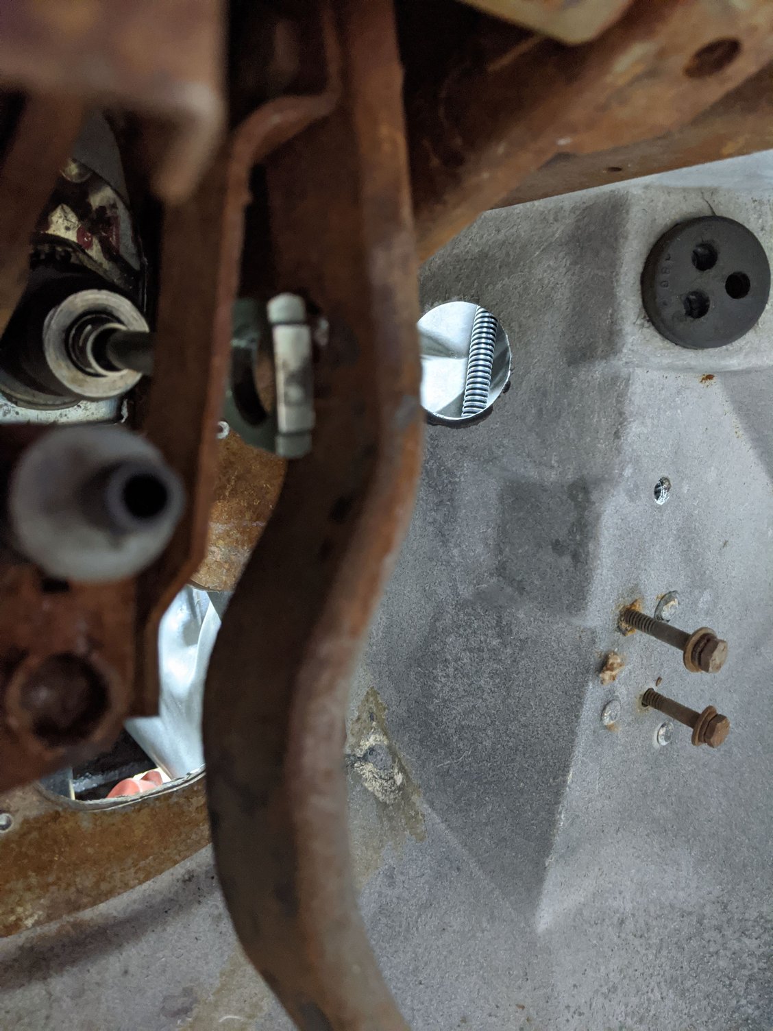

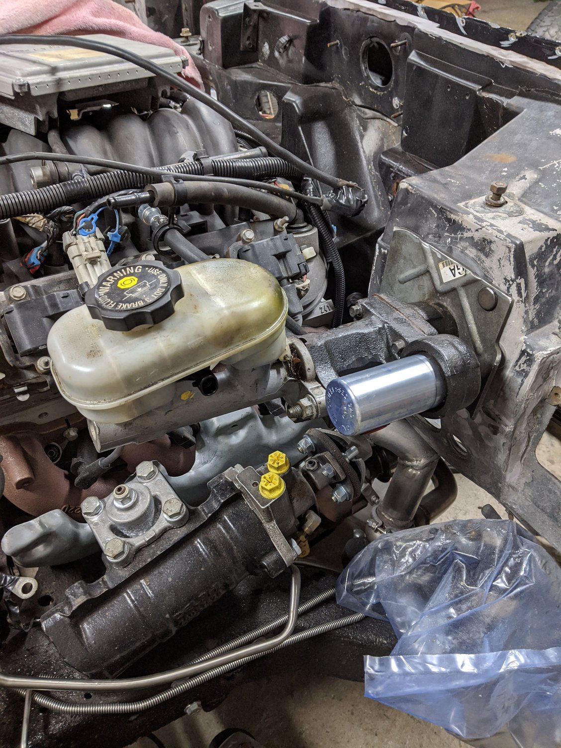

Thought I would post up some pics. Using a hydroboost from an early Silverado HD. The master cylinder is from a 99 TransAm that I used as a donor for my Restomod. Borgeson steering box too.
It's flipped upside down, I had to cut the bottom off. One bolt would not fit the Corvette pattern, but I will still a new hole so I can get all four. The other three bolts line up perfectly.
The linkage matches up almost perfectly, the rod is a little short. This unit uses the staked rod.
I had to cut the bottom of the center hole so the nut from the hydroboost would fit.
