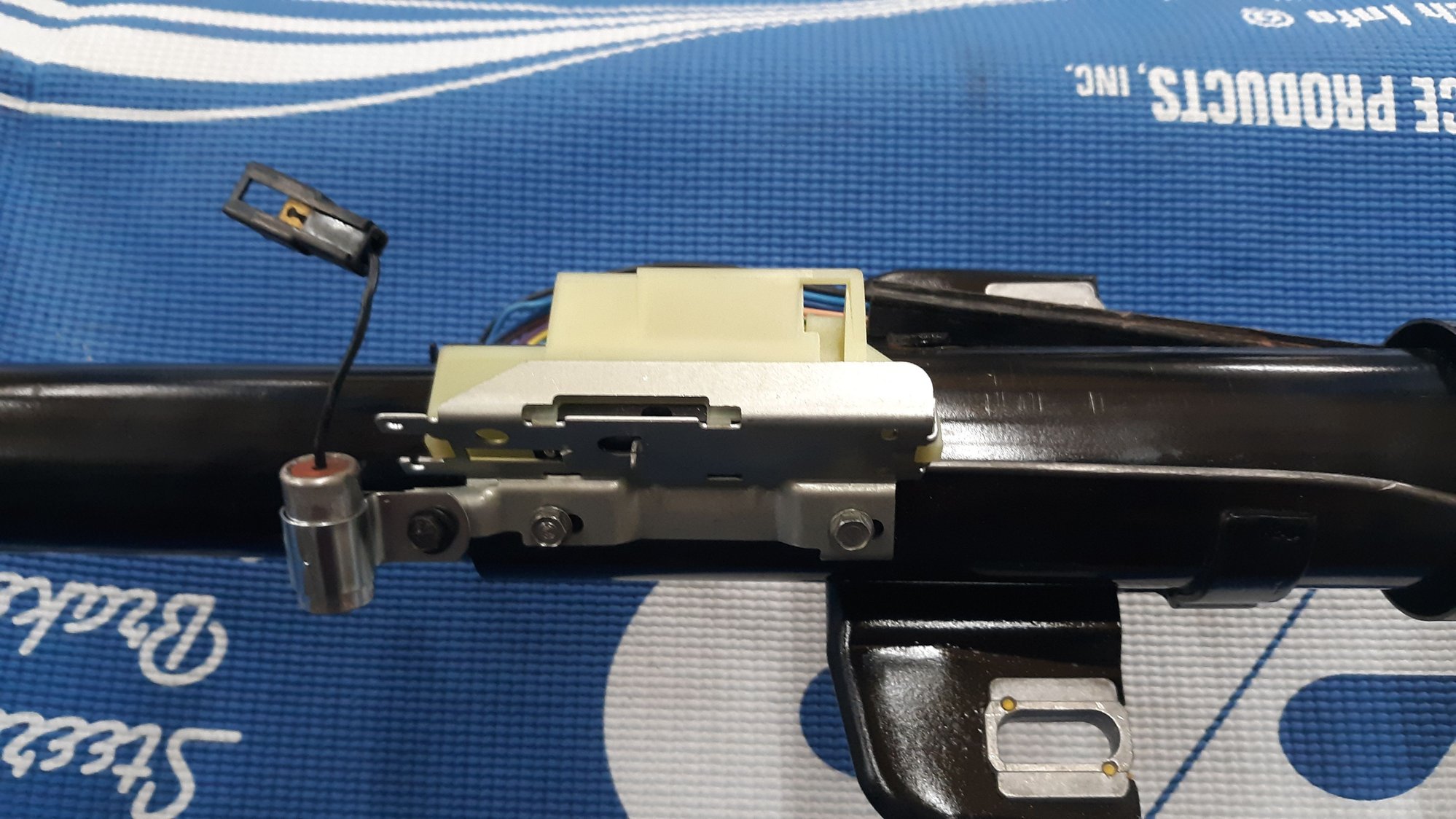

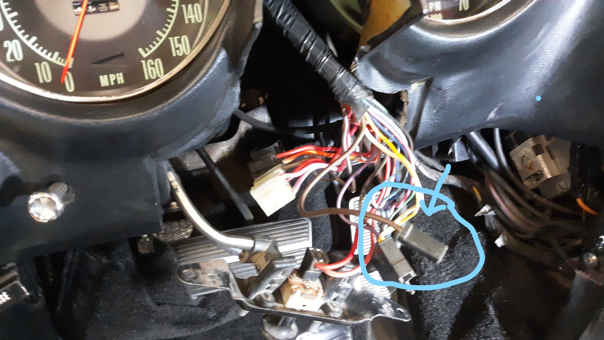

We are working on a 1971 big block w/AC, automatic, convertible. While installing the steering column I have a brown wire that I can't find a home for. The wire is circled in the picture. HELP PLEASE!

Fairly certain that is for a capacitor.... give me a sec to find the thread...
Old Mar 9, 2020 | 02:39 PM
carriljc's Avatar
carriljc
Joined: Jan 2001
Posts: 6,713
Likes: 1,371
here you go.... eyeball this thread.... see if it applies: https://www.corvetteforum.com/forums...hind-dash.html

Thanks for the info. That confirms what I found in the assemble manual. Somebody had tossed my capacitor.

The brown wire I asked about is in fact connected to a radio capacitor.
