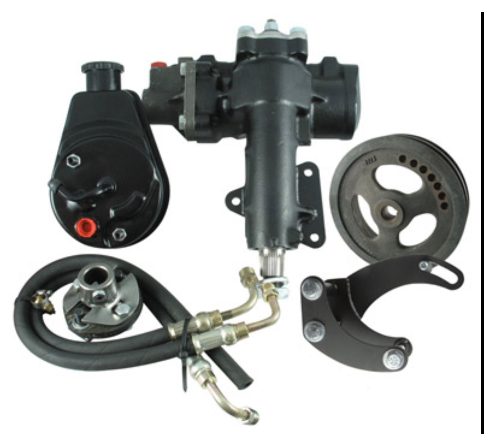

I’m getting ready to install my Borgeson power steering unit in my 74. It is a non power steering car. Do I use the stock belt or is there something special? Thanks. Tom

Isn't your replacement PS pump the same unit as on the stock vehicles? Show us a picture of it.

This is the Borgeson kit picture. I’ll get a better one from the parts.

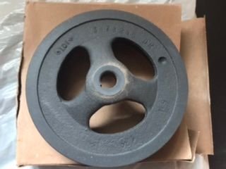

That looks like the standard GM pump. Did you get a pulley with it? What is the casting number on that pulley?

From what I’ve read parts are stock except the power steering unit itself. Just wondering if anyone that’s done the conversation knew if the belt was different . Thanks. Tom

I cannot read that pulley number but it looks like my cast iron pulley. I would give you my belt number but it won't do you any good unless you have the same deep groove PS pulley and 6.75" crankshaft pulley. My PS belt goes from the crank to the PS pump only. If you think the number would help then let me know and type out that PS Pulley number-- then I'll get the belt number for you. Here is what it looks like installed:

Part number. 3878245 DK. GM. dual 3/4” grove.
