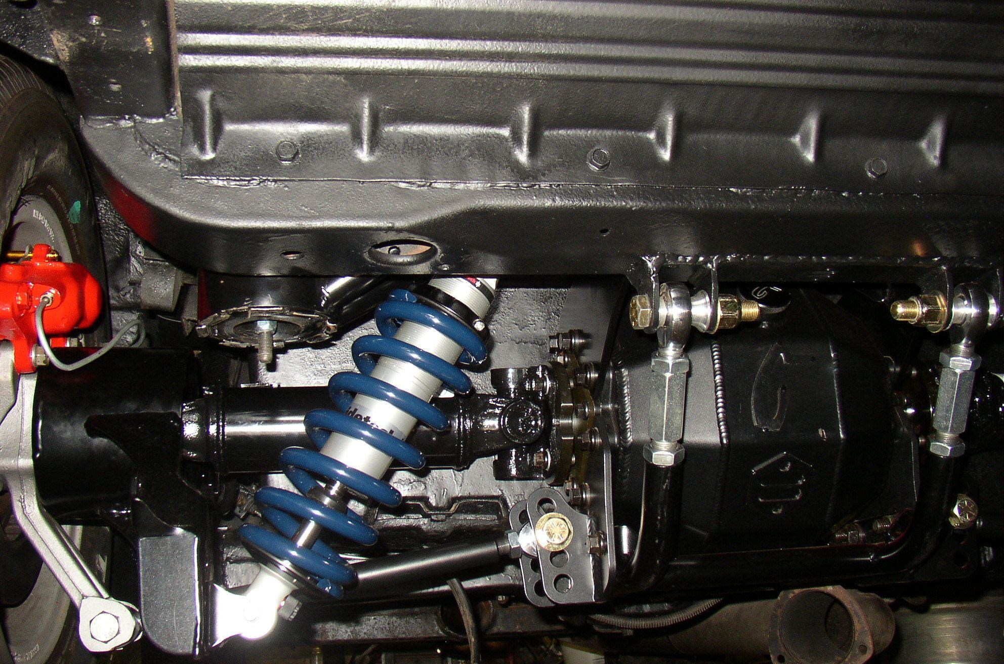

I have not quite gotten there yet, but as I recall they have spacers that you can purchase that can be put on the bottom of the spring that would lower the car. In the picture above there is room for what looks to be about a 1" spacer without changing the spring rate. If they don't sell them, I was going to make a spacer.

Took a quick look at the instructions again and the rear setup of Rusted is installed per the instructions. Also found this: Seems maybe a different spring is in order to lower the car. ugh.
From Ridetech instructions
