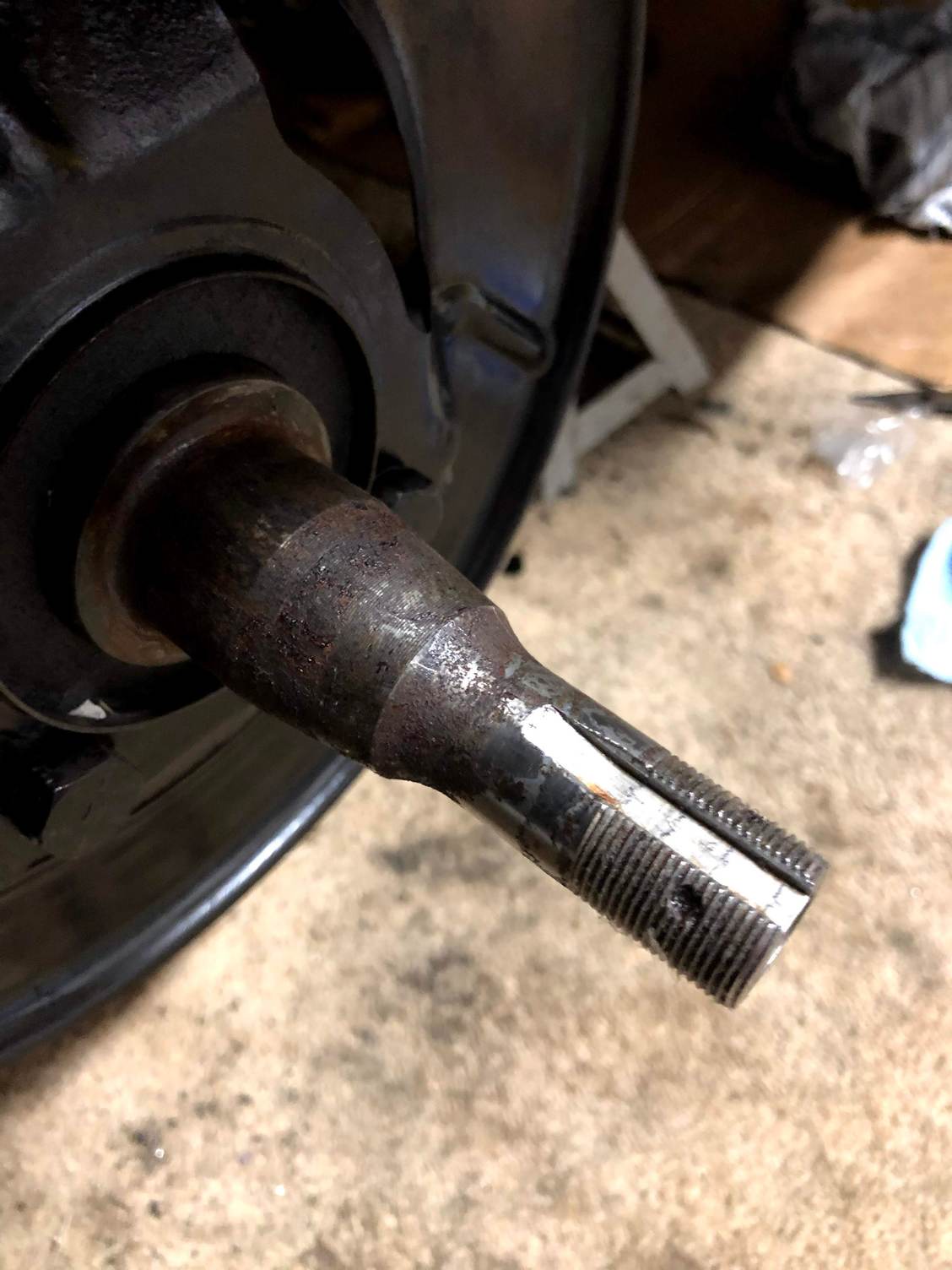

So I made a bit of a mistake. While having the wheel hub off and cleaning parts up, I wrapped the spindle in masking tape so I didn't damage it. It seems that may have been a mistake. The tape held moisture and now I have rust. CRAPPERS!!
How should I clean this off? Can I clean it? Is it ruined? I was thinking steel wool, but I'm not sure.

Try some scotchbrite to polish it off without changing the spindle dimensionally.
A good rust preventive like amsoil metal protector will help too.

Agree, scotch brite and brake clean. Works every time.

Roll emery cloth will work as well. Piece about a foot long and buff it like buffing your shoe.

By scotch brite, you mean the green pad, right?

Red is medium and gray is fine.

Forget the scotchbright, get some emery cloth.

Those surfaces just hold bearing races. None of them are actual bearing races. Clean up with sandpaper or Emery cloth and it will be fine. You spend a 1/2 an hour on that with Emery cloth you are not going to make it a 1/2 of a 1000th smaller. And it will clean up in about 30 seconds.

So I used a Dremel Versa cleaning tool and a scotchbrite attachment pad. and got this result.
I was planning to use the amsoil meter protector also. I think that will work OK.
Doesn't the bearing rest on the angled part of this spindle and roll on that surface? I would think that needs to be pretty smooth for the bearings not to wear wrong.

The bearing only slides along the spindle to get in place. The actual SPINNING occurs when the roller bearings rotate against the race in the hub. Those are machine surfaces to tight tolerances. The spindle area touching the inside diameter should not spin at all. Only loose enough to slide the bearing assy on and off.

The spindle looks great! The rolling bearing surfaces are the (replaceable) bearing races inside the hub. You should be all set for that, as they probably still had grease on them, but make sure they are smooth.
