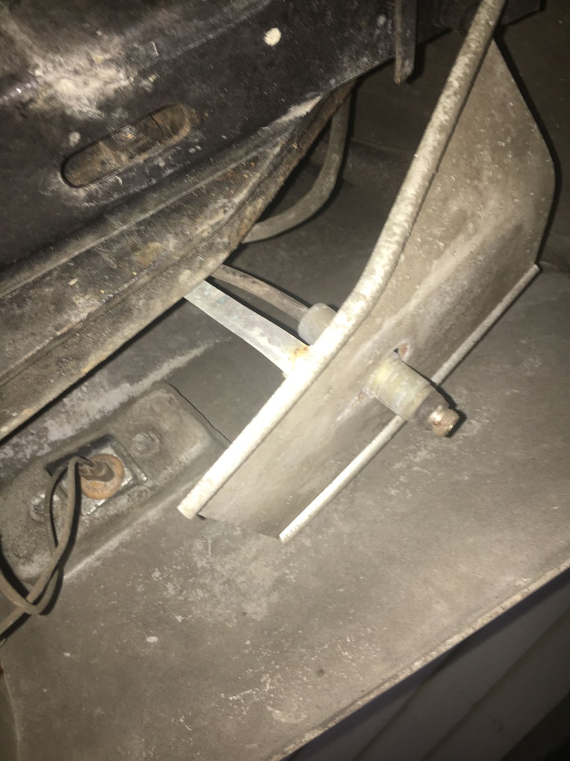

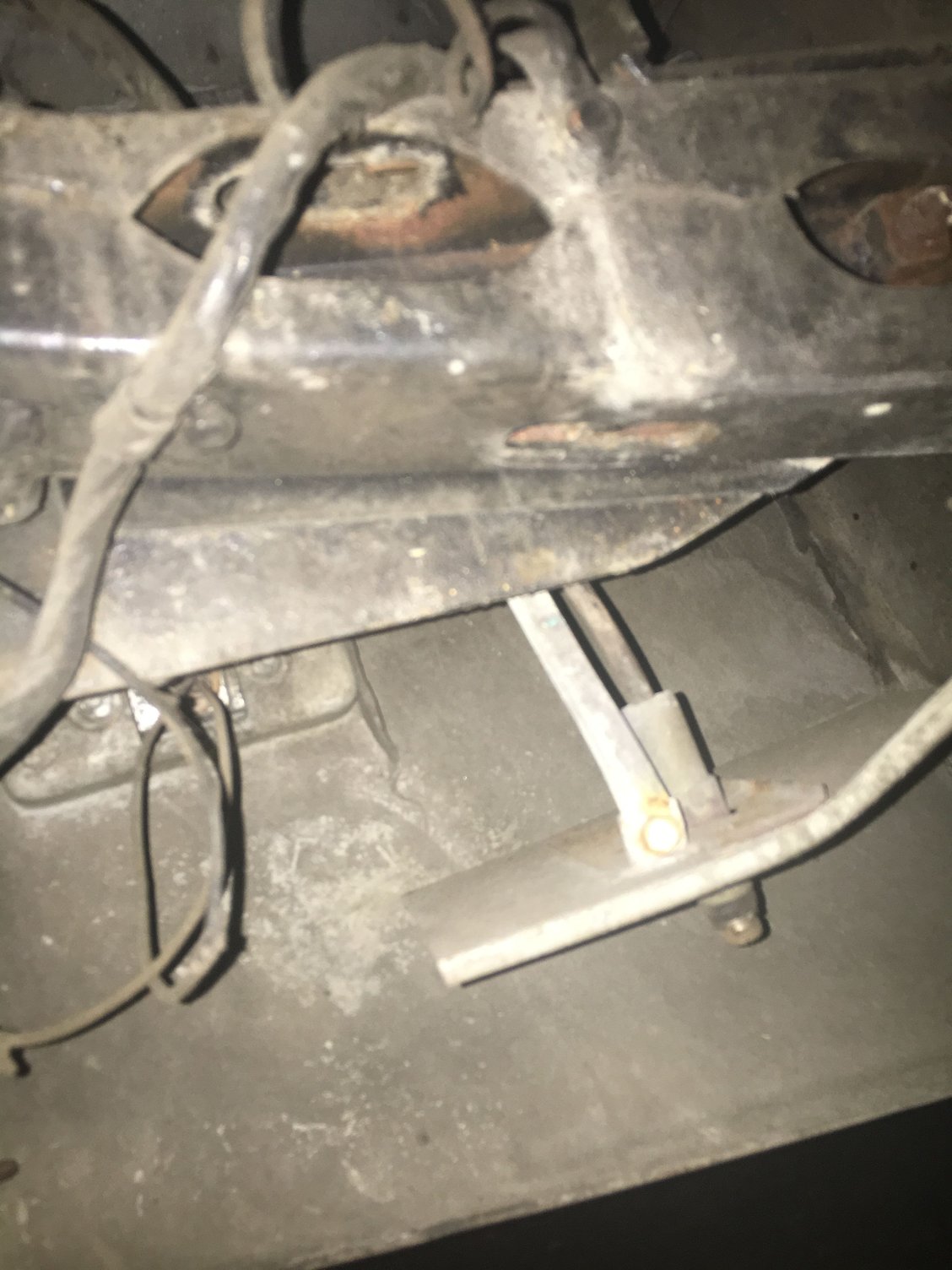

Hello all,
so I am wondering what this is that is hanging from the underside of my car near the driver side rear quarter. Pictures are included in the post so please take a look at them. Does it have something to do with the alarm system? Thank you for any help

Looks to me like possibly the ground plate and connection for the radio antenna.

That is what it looks like to me also.

Yep, so the car does not have an antenna on the driver's side rear fender?

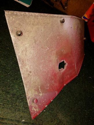

Yes...looks like an antenna wire and ground plate. Goes up against the antenna mast from the inside. Here is a picture of my old one (1968) without the cable attached.

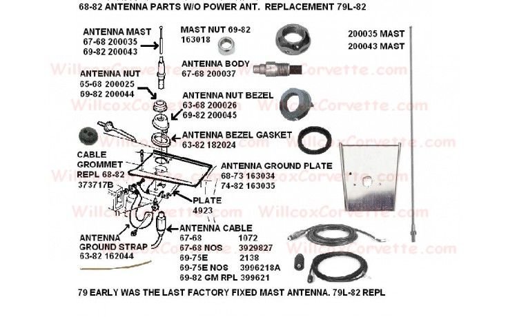

Here is a detail assembly drawing from one of our vendors.....

This is God's way of telling you to buy an AIM manual! It's got pictures! LOL $24.00
otherwise known as the 'assembly manual' . What Corvette workers used to assemble the car!

That is correct there is just an open hole ! now i can add the antenna back on, i have the original from the previous owner.
