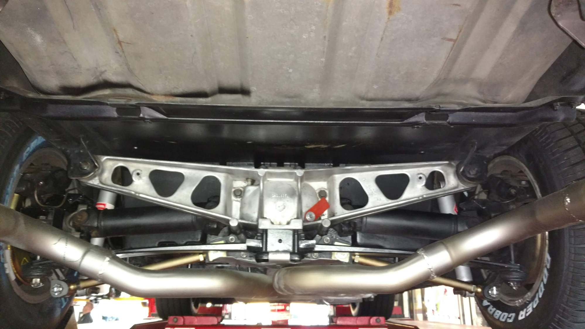

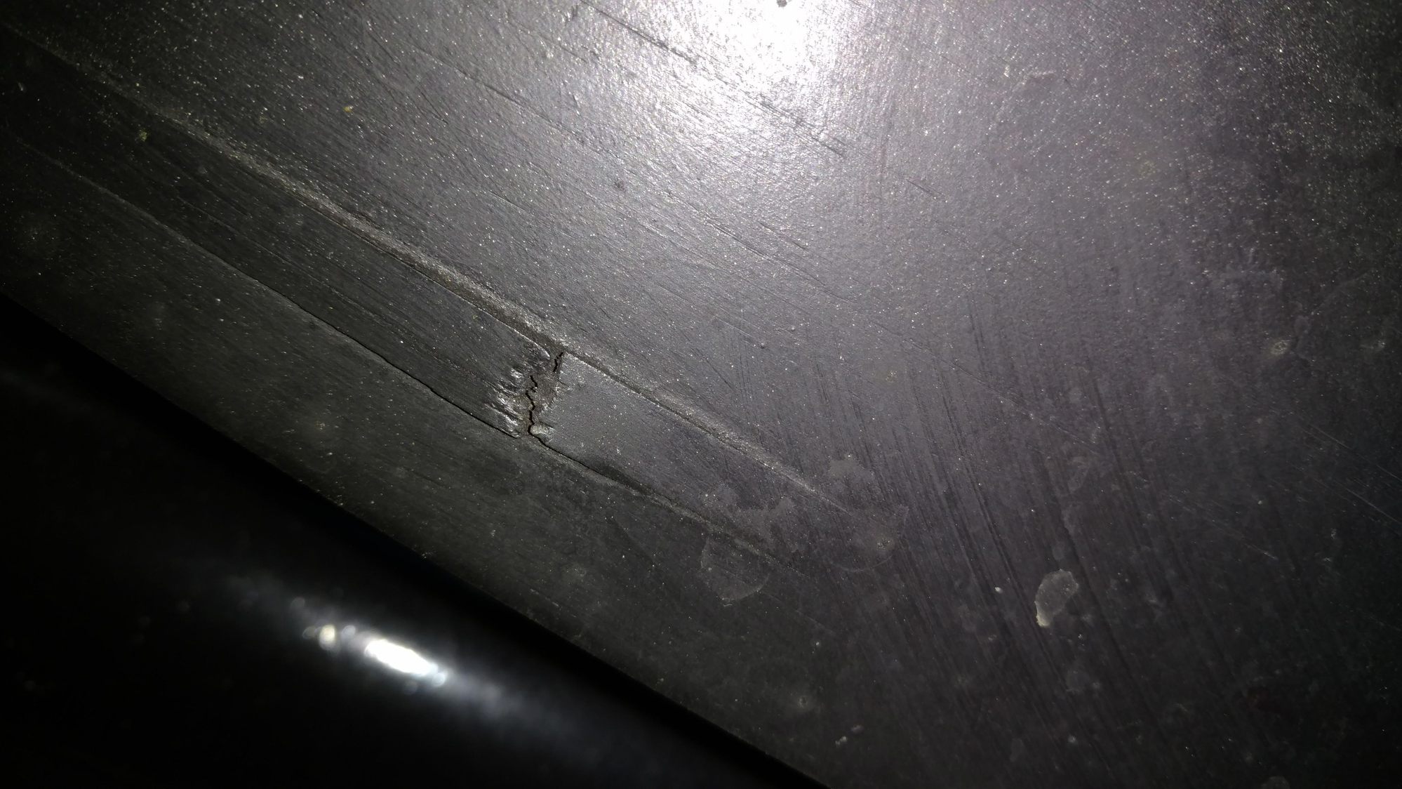

Gentlemen,
I am pulling my differential soon. I want to be prepared to replace my spring pending your answers. I have a flaw in mine which has been stable for decades (see pictures taken today). The spring has been painted over once in case anyone wonders why the crack is the same color as the surrounding material.
The flaw notwithstanding, is there a "life span" for these springs? Does their performance degrade with time and cycles? It is, of course, 38 years old and hasn't sat around- it has 219.000 miles. That means I'm beginning to have difficulty finding something I have NOT replaced at least once. The spring and differential are on that short list.
The first picture is from underneath. The entire blemish is about 3" long, maybe a little more than 1/4" wide.
The second picture is from halfway back to the rear bumper. The blemish can be seen to the right of the center of the photo. just protruding from the surface of the spring about 1/4" or less.
Recommendations, please?
Steve

Well, my VBP 360 monospring has been on my 78 L-82 gymkhana suspended C3 since 1986. Generally speaking a monospring should not wear out..AKA lose its compression/rebound characteristics, unlike a steel spring which WILL sag with time and will wear out..steel leafs will fatigue.
I have a few questions.
Who made that spring? How long has that very slight splinter/crack been present? The one fatal flaw has been that the composite springs can crack if they suffer road debris/damage. If that splinter has been there for a while, my guess is that the spring would be fine. HOWEVER, with the high mileage on your car and spring AND since you are going to R&R the differential any way, if it was me, I would replace that spring....if you only Occasional drive that car and the crack has been present for a while, I would leave it alone ......for now.

It is the original spring. The crack has been present for over 20 years and has been stable.
I drive it A LOT. Even used to commute with it to two daily jobs in the D.C. area.
Porposing is an issue to me. I wonder if renewing could dampen the rebound without making it ride like a truck. I am uncertain what the original spring weight was, but from my reading I think is is around 200.
How does your 360 feel?

The porpoising is definately the shocks. They are too weak for the spring. I have heard that the composite springs need a slightly stiffer shock than the steel ones to stop the porpoising, since the steel ones have more friction. So stock shocks meant for the steel spring may not work well.
The Bilstein shocks are very well recommended.
PS: If you have a factory spring, I would love to see a full rear end shot with the whole spring, while it has the car weight on it. Could you measure the spring bolts and see if they are 6.5" or larger?
Either would be appreciated.
Congratulations on driven it often! It looks great in Maroon.

This view is from an alignment rack so the weight is all on the tires. (Ever seen such a clean driver with 219.000 miles on it?) If this isn't what you meant I will take more photos today in the garage. I will reply with bolt dimensions later today. I will look up the Bilstein shocks.

I wouldn't bother if it's been that way for decades. You already like the ride so put decent shocks back on it and keep driving.
That's exactly what I was looking for! Thanks. I can almost guarantee you have 6.5" spring bolts based on the large amount of space to the wheel rim. I calculate your current as installed arch at a low 1.5".
Ans yes that is the cleanest high mileage non-restored car I have seen in quite a while. You obviously take terrific care of it. Congrats.
If you wanted to replace that due to caution, (the old crack) I would recommend the Van Steel EZ-ride it is an exact duplicate of your spring, made by the original manufacurer (Liteflex) on the original molds.
