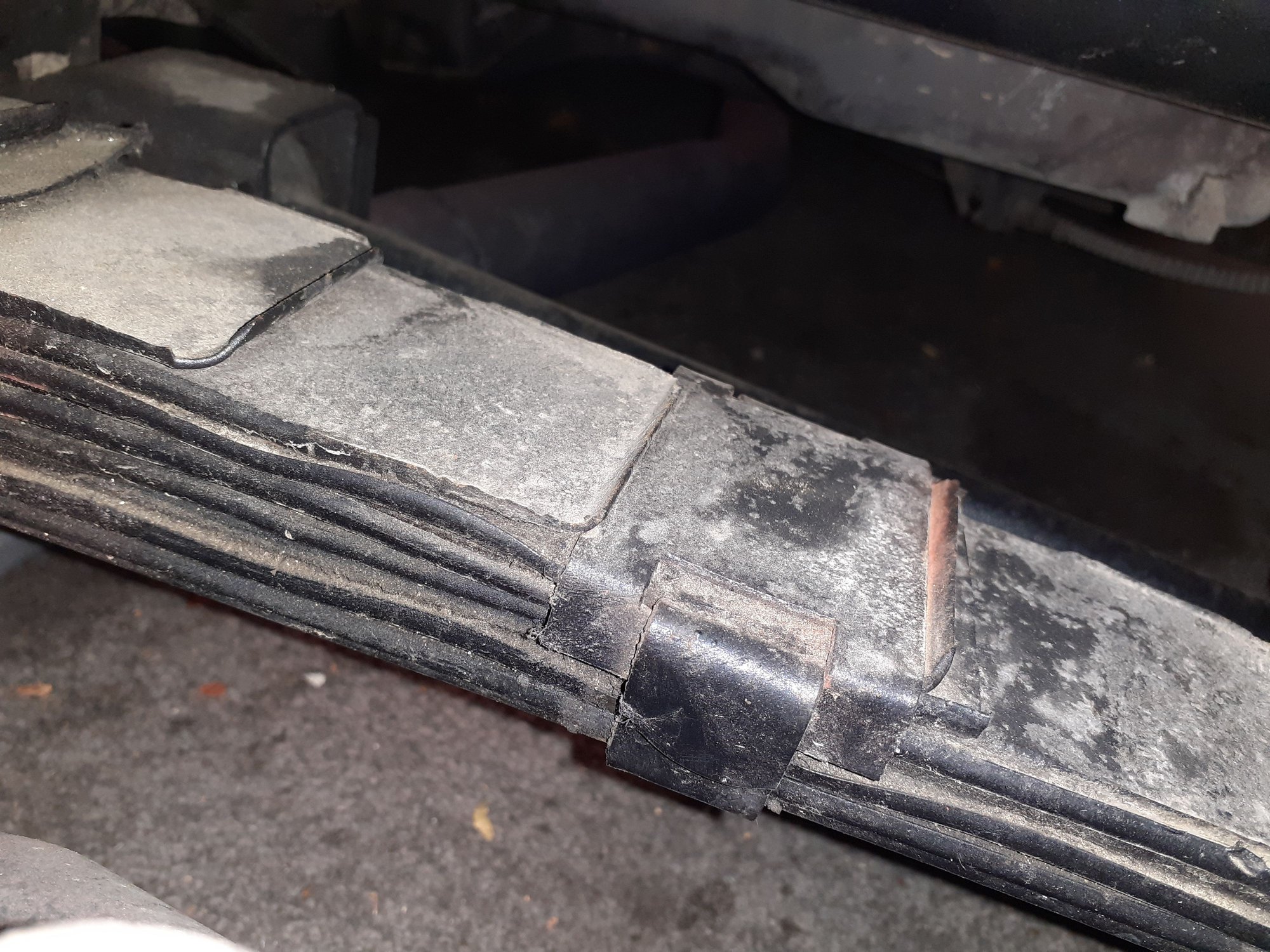

Hi corvette team,Question is....is this a shipping clamp on my rear spring and should it be removed?Is there any noticeable difference to the height and ride before and after.
It amazes me I haven't seen this before!!

Yes, that is a shipping strap and that is not the original spring

Yes cut those off. I found them on my 75 after I purchased it. Unfortunately removing them hasn’t settled the spring much.
Hi GTR1999, that's not a surprise the diff housing has been changed also....but how can you tell the spring is not original?
cheers Dave NZ
Good little job to do while I'm struck in lock down for a bit ...I was more worried about the car lifting a little as I already have 8 1/2" bolts on

The ends of original steel leafs were curled up like a sled. Aftermarket are flat and have those straps. They also are not arched correctly and most times need 8" bolts to bring the rear of the car down.

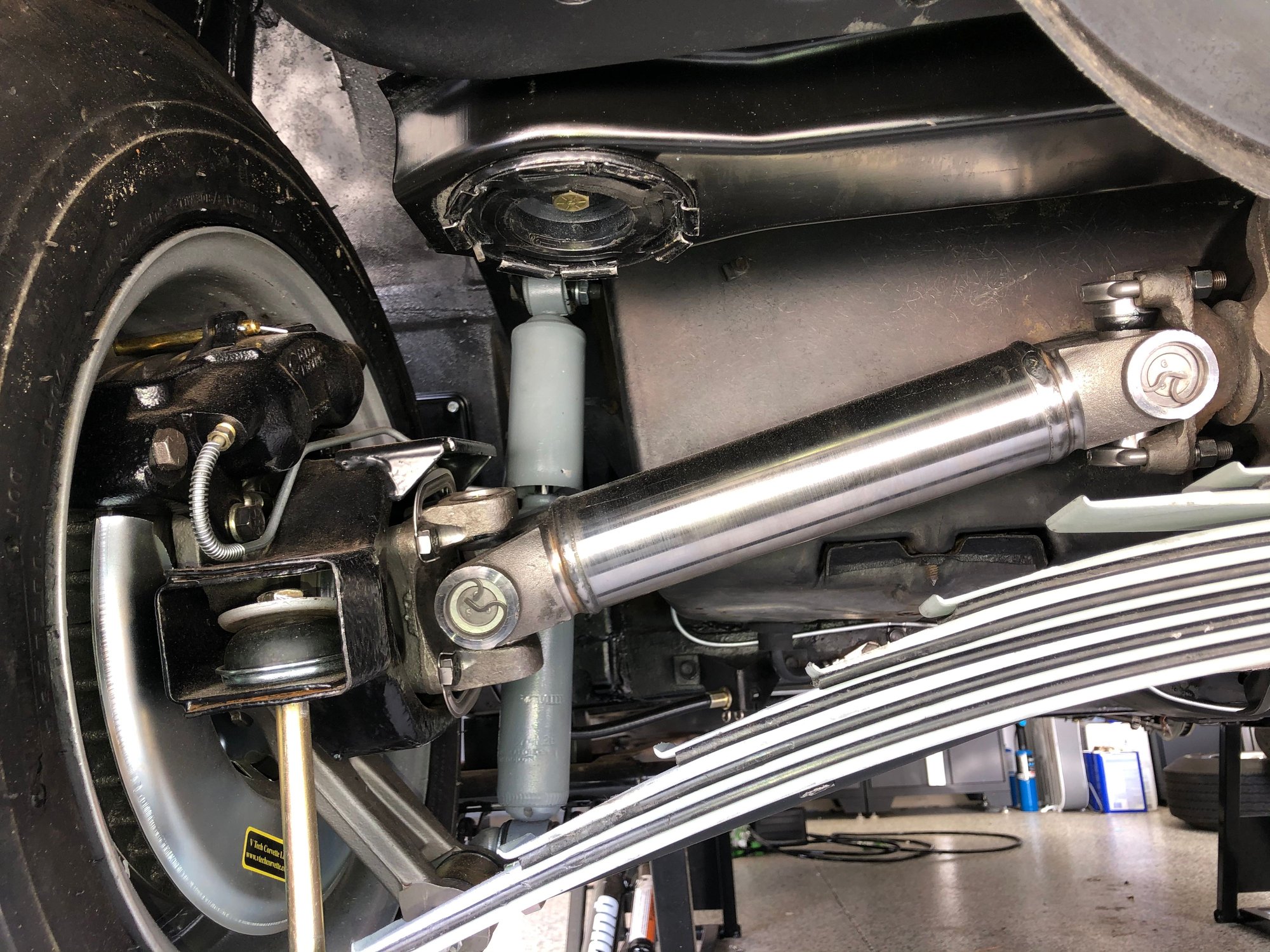

I took mine apart, removing the shipping clamp, painted and reassembled. That is how there were from the factory I believe - no clamp.
Niiiice, man that's a clean rear end......I might get there one day!!
Thanks man. It’s taken quite a while to undo and fix the pile of Bubba on this car. Almost done.
