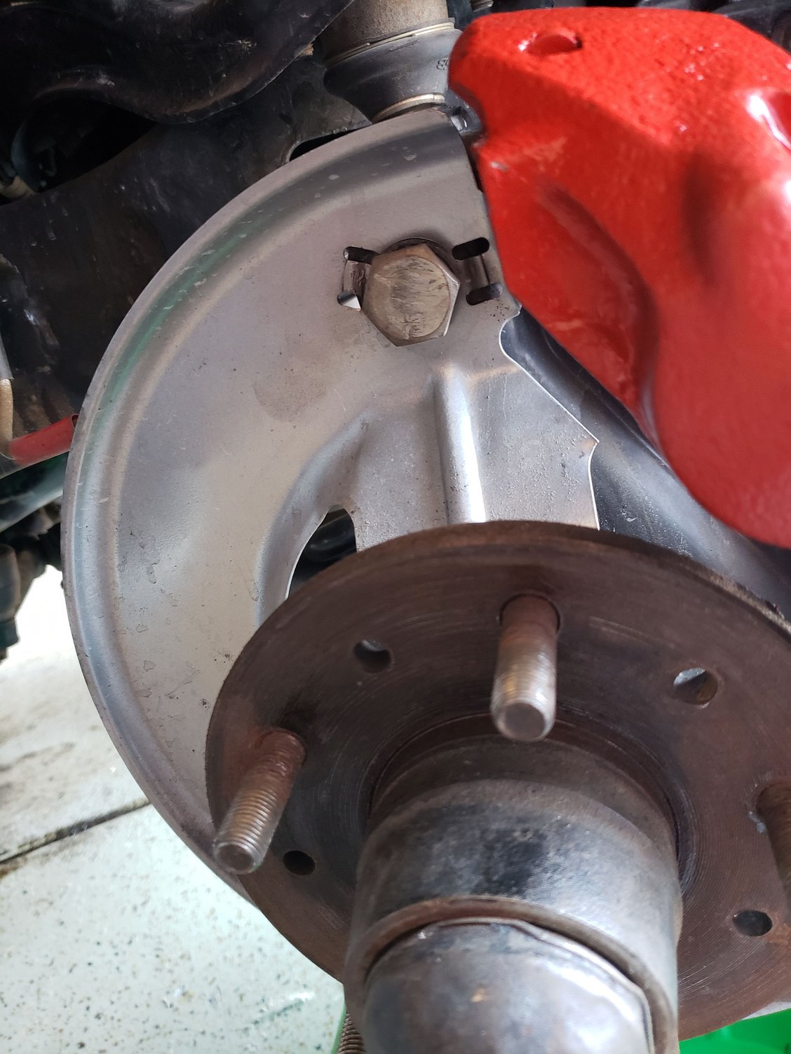

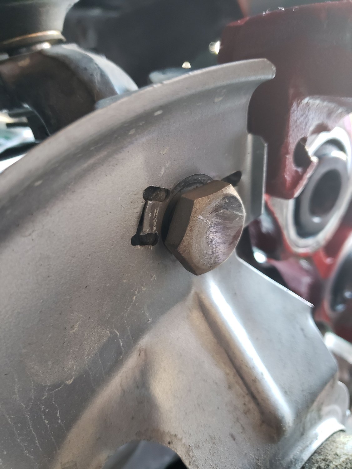

Default Solved
I found the problem! Turns out the bolt on the back side wasn't tight or even locked into place and backed out enough to hit my rotor. Cheap bolt=expensive fix.

There's two tabs on the shield that are supposed to be bent out to hold that bolt head.

Pretty sure op stated the stakes were not utilized..my question is still how does it gouge the rotor unevenly?
I still don't have a solid answer for this other than my rotors must have been slightly out of true.
Interesting note: I pulled the rotor off the driver's side to check that bolt (the bolt was tight but of course those tabs weren't bent either, quick fix) but that rotor was also scored on the inside. The pads looked good though and I never noticed noise coming from that side. My daughter and I stared at that side for about 30 minutes looking for other damage and were never able to find out what caused the damage on the driver's side. I have to assume it was debris caught in the slots at some point.
I went ahead and installed my new front rotors and pads and my new caliper on the passenger side. I'll keep a close eye on these rotors for any signs of premature wear before they get destroyed. I'll be interested to know if anyone else runs into this type of issue. If I ever nail down the cause for sure then I'll repost it here.
You can bet your passenger side bolt head that I Loctited that bolt and used the locking tab. I also took the rotor off the driver's side to bend that tab too. Lesson learned...
