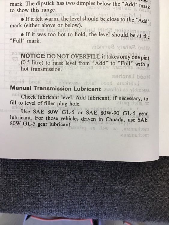

And of course i overread all this..and skipped even my own advice from manual stating gl5 seeking improvement..from others but they were older gl4 transmissions.
my 79 needs gl5.. I accidentally posted shell gl5 but corrected my picture to lucas oil gl4 and 5..which is what i had in it..when i got it..
it was low when i bought it and the drain plug was full of hairy metal..couple thousand miles with the lucas ( obviously better than low oil) and plug has zero metal.. i bet never changed since new
i bought and added the stalube gl4 and just got done adding to ...ill drive it and see if i note a difference but will have to get it out of there next oil change or sooner?
Mistakenly went from lucas to this..gl-4
