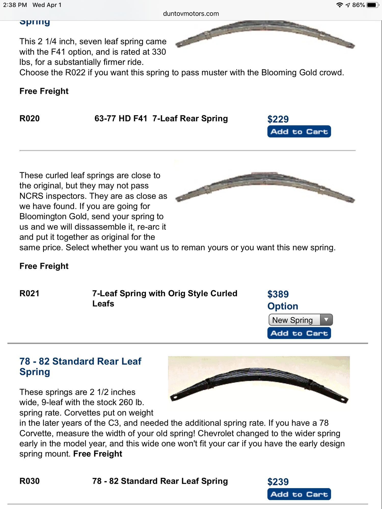

Here is a very clear picture of a 9-leaf. (the variable rate 6+3 version). All of these leaves count and I see no short one that could be considered a spacer. To me Bikespace's spring looks like this one, just without the 3 flat ones at the top, so it would be a std 9-leaf.
Redvette2 says his replacement F41 spring has this extra very short "spacer" or non-leaf, but I can't find a very clear picture of one. You can barely see it in his supplied pic. Can you tell if the ends look squared or are they more normal?
Update. Courtesy of ZIP. 7 leaf with and odd top leaf or "spacer" adding up to eight.
Now I'll add a further question. I have always understood that the earlier diffs took a 2.25" wide spring. And the 78-82s took a 2.50" wide spring. So is this rare Gymkhana 7 (or 8) leaf 2.5" wide for these 4 years?.

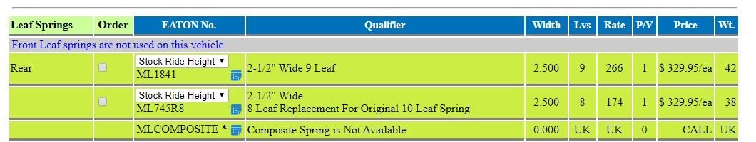

I checked a couple sites and could not find a source for a 7 leaf or HD/Gymkhana/F41 spring that was listed to fit a 2.5" wide 78-82 rear.
So maybe this spring is not being repro'd and a weaker replacement 9 leaf is the only choice available?
Update; Eaton spring spouts "built off original GM blueprints" and lists 2 steel springs for 82: 2.5" wide. Note what they say about leaves. So the 78-82 steel springs are very unique.

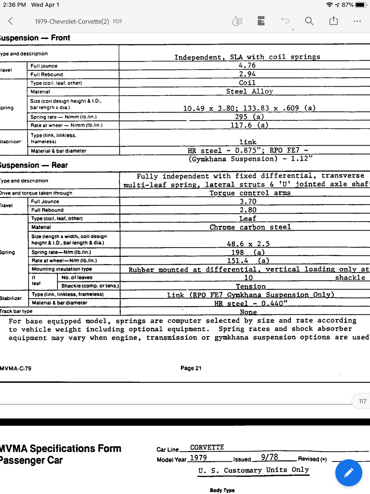

There really is no debate that the 81 gymkhana is an 8 leaf steel spring unlike prior years C3's that had 7 or 9 leaf springs. 1981 seems to be an odd year supported by GM documentation. Please open the GM documentation below for verification:
https://www.gmheritagecenter.com/doc...t-Corvette.pdf​​​​​​
Hopefully the link and an actual picture of the GM documentation will put this question about leafs for the gymkhana spring for the 1981 C3 to rest....it is 8 leafs!

Guys, I just looked it up AGAIN , 198lbs. as stated previously. USE THE LINK FOR YOUR YEAR C3-this is a great information resource!
Gm Heritage center.com. https://www.gmheritagecenter.com/doc...t-Corvette.pdf

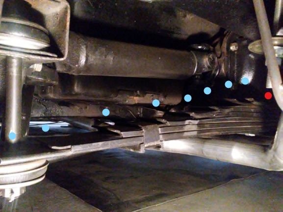

Took a closer look at my car and found this top spacer looking leaf out of sight at the top of my spring. It is rounded and has a very slight tip-up at the end. There are definitely eight leaves plus this short spacer one. So not the FE7/Gymkhana spring but likely a 9 leaf without the variable rate.
Short top spacer leaf in lower right side of picture.
Eight Leaves....with top spacer (red dot) out of the picture due to angle

This supports the GM documentation and picture I posted earlier^^^^^^^^^^^^^?

The base rear spring says 192lbs above from GM documentation? I believe the computer modeling refers to front coils, not the rear spring, but I could be wrong. I also seriously doubt GM customized springs for each car based on options. Maybe some GM employees could weigh in but I am highly dubious of that level of detail in 1978/79. For example, the base front coils by the aftermarket are rated 460lbs..GM never offered a base C3 with 460 lbs coils. My aftermarket gymkhana coils for my 78 are sold as 550lbs springs which is the rating from GM. Either way, for the rear spring any deviation from 192 lbs for the base rate would not deviate more than say +/- 10lbs...insignificant.
Duntov springs like all the other aftermarket companies does not mimic what GM published for all the various spring rates for C3 years when replacing springs.
For example, back in 1986, when I replaced my 78 gymkhana 7 leaf spring with a composite, I went specifically with the VBP recommendation of a 360 composite. The F-41 GM Steel sport spring was rated at 292lbs.
Either way, I believe we answered the question with decent certainty that this 81 had the gymkhana suspension from the factory.............Cheers!
