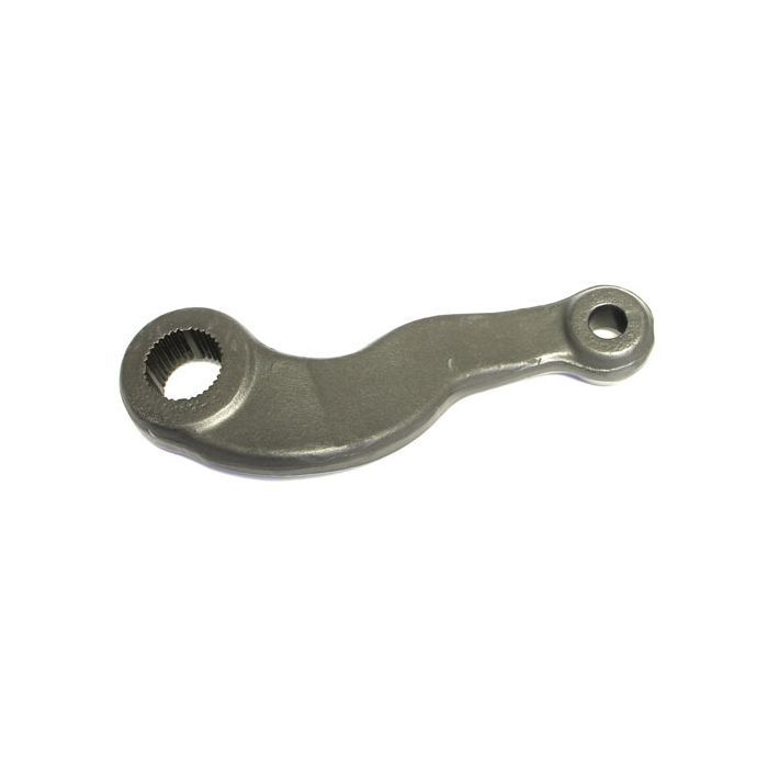

I have a non- power steering relay rod off my 71- that I converted to Rack and Pinion. Shoot me an email "richard454 at comcast dot net" if interested
And yes the pitman arms are different- see below
MANUAL
power steering
