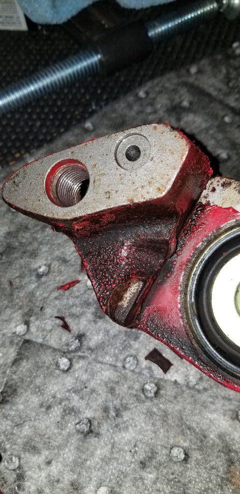

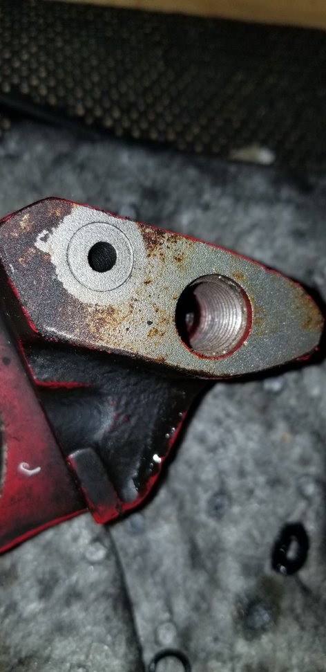

I got around to opening up the caliper and found some interesting stuff. The recesses for the o-rings between the two caliper halves are different depths. The UPPER o-ring, which is the seam that was leaking, has a deep recess for the o-ring. The LOWER o-ring has a much more shallow recess. The o-ring in the lower recess was completely flattened, but this may be by design as there was no leak here. The upper o-ring in the deeper recess is the one that was leaking. I'm wondering if maybe the o-ring being set so deep in was keeping it from properly sealing??
Here are some pictures:
Upper recess. This is the source of the leak, as you can see by the peeling paint.
Lower recess. This had the completely flattened o-ring, it was definitely sealed.
Unless someone tells me other ways, I would say these were poorly machined when they were rebuilt? They were rebuilds from VBandP 5yrs ago. I got the rebuild kit to fix the leak, but seeing them now I think I'm just going to go with some Wilwoods and be done with. I'm sick of constantly dealing with the various issues with the factory style calipers. I'm going to do some research and either do the 6 piston D8 style direct replacement, or a big brake kit.
Old Apr 26, 2020 | 07:34 PM
bazza77's Avatar
bazza77
Joined: Jul 2010
Posts: 3,174
Likes: 631
From: perth western australia
I agree , that combined depth of machined flat areas for the small O ring looks to be too deep . the O ring supplied just wouldn't work in there , One way to try is a wider O ring ?
Old Apr 26, 2020 | 07:51 PM
80vette21's Avatar
80vette21
Joined: Oct 2009
Posts: 306
Likes: 45
Yeah, I could try that, but I just don't want to keep chasing my tail with these. The leak destroyed the paint, which I'm pretty sure was supposed to be powdercoat, so at this point they need to be stripped and redone or they're just going to look like crap. And then it still might wind up leaking. It's worth the $800 to get 6 piston, powdercoated Wilwoods that will probably never be a problem again lol
