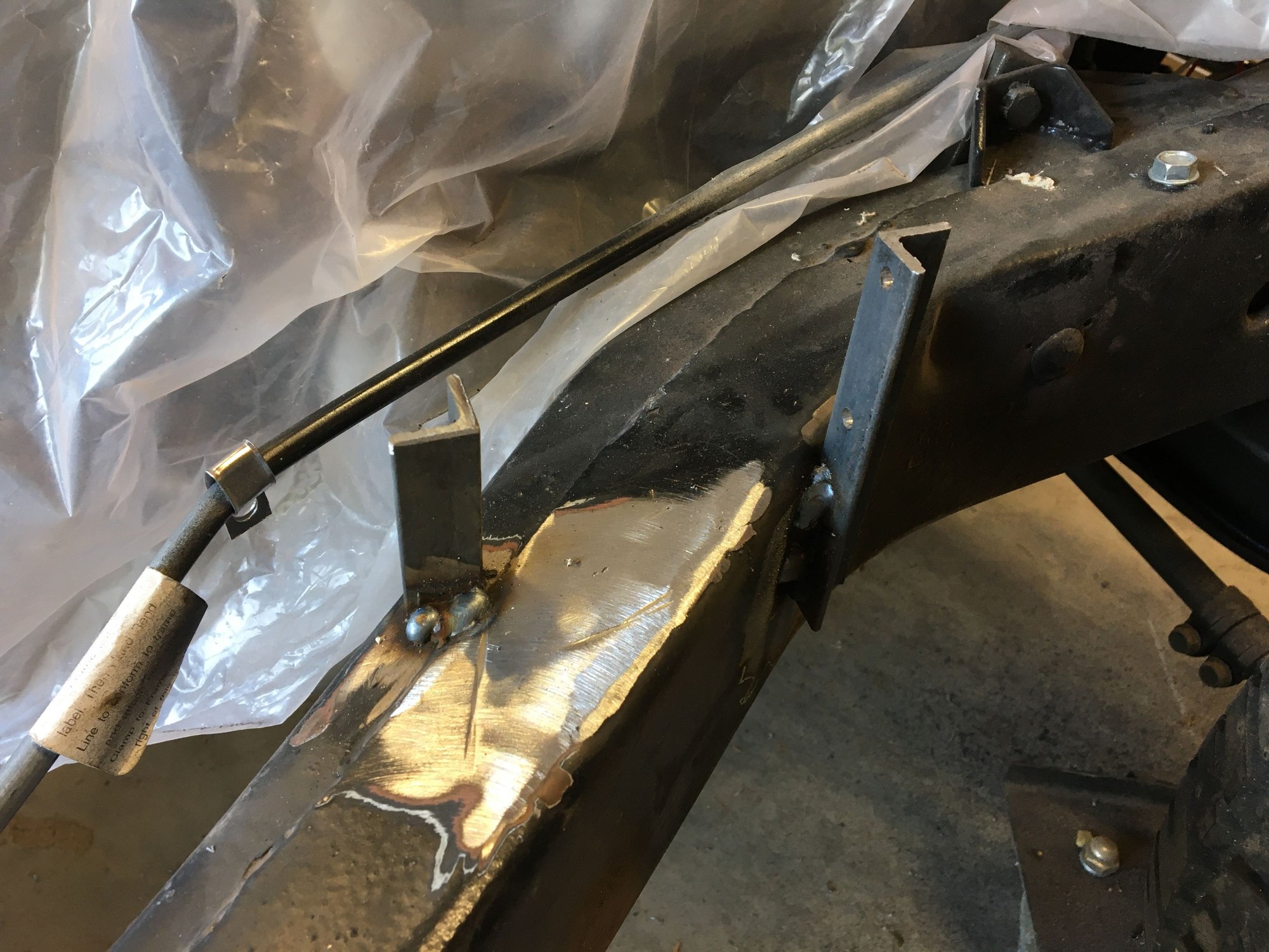

I took a little time this morning for another welding project to make my bracket removable. Scott
