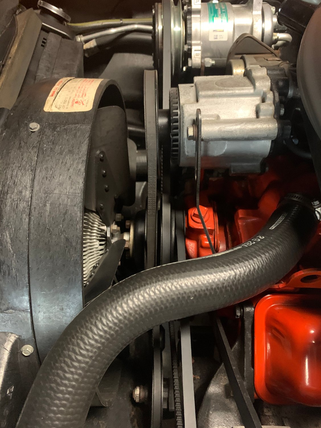

Originally Posted by 4-vettes
O.K. I learned this one the hard way many year's ago. A lot of people think, (incorrectly) that there are 2 chev small block water pump's. Nooooo. There are 3! Long , short , and Corvette! If you have an original engine and accessories. You MUST get the correct Corvette length pump. Slightly longer than a short pump, but shorter than a long pump. Failure to do so and your belts will run on angles and fly off. Go on Summit's site and put in your car details. It will bring up several pumps of the correct length of several different companies. Read all the reviews. Then make your decision.

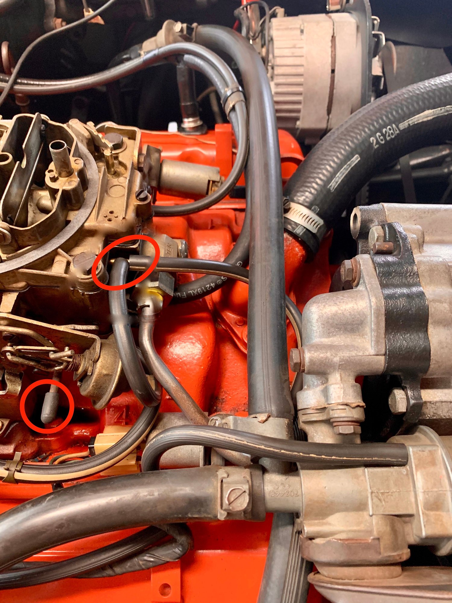

Speaking of running on angles, my "new" to me '73 has a slight issue there. Bought it in November '19 and didn't notice this for 2-3 months. Car had Vintage Air added at some point, not sure if that's when something changed or not, but anyway here's a pic. If anyone has seen something similar/has a fix, I'm all ears. BTW I've already tried swapping a washer around on bracket that holds AIR pump but that didn't correct it.

Not the best photo to be sure of all the belts. But looking at the Alternator belt. Looks like a short nose pump is on your engine.
many years ago. I took my 77 to a automotive repair shop. I guess I thought I was to busy to repair it myself. My original waterpump was leaking.
they installed a short 350 chev waterpump. The pump worked fine. But all my belts were running on angles.
That's when I looked into it and found out that Corvettes have a Corvette specific Waterpump.
Look it up on Summit or any large Auto parts distributor. Corvette's with an original engine and accessories need a Corvette specific pump. Slightly longer than a short pump. Shorter than a long pump. This should get the Alternator belt lined up.
as for the rest of your belts. Hard to see and when they installed that aftermarket aircon compressor . Hard to say.
Curiously....why do you still have the smog pump installed? I can understand originality but you have a Sandersen style A/C compressor so that is out.
The A.I.R. was a trick created by GM to dilute exhaust by pumping fresh air into it. The same amount of absolute hydrocarbons is emitted......it is just diluted.
Years later they found that pumping air into the exhaust helped the Catalytic Converter function at a higher temperature.
If it was mine....I would remove it and put it away somewhere......they are about wothless in function and can actually impede performance by pumping volumes of air into an already challenged exhaust system.
Jebby

Jebbysan,
I see what you mean about originality has left the building with the aftermarket AC. If I take it off, obviously I would need to cap off that vacuum line, but what about the two bigger, heater hose size lines that go to the exhaust manifolds?
Jebbysan,
Just remove everything. Cap the exhaust manifolds with inverted flare plugs. Nothing else should be connected to the engine....that I remember.
Jebby

Ok cool, I think I can handle that. Both hoses run into a kind of bell shaped hootus which in turn screws into a small black manifold looking thing that then branches off into exhaust manifold (4 per side). You can see it right at the top of this picture. Thanks Jebby, now I can quit losing sleep over the slightly off fan belt!!!

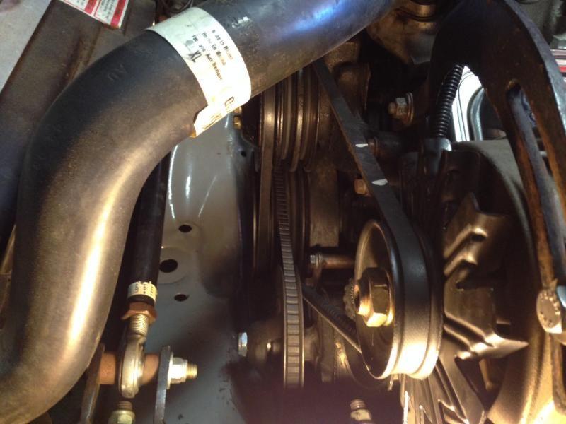

Buddy1961
This is the part number that I put on my 1968 in December 2002. Pulley rubbed a skosh on the pump body so I filed the pump body down (just a touch). Works great. Hi flow.
https://www.summitracing.com/parts/bra-1668
You need the short one. Don't bother trying to use that long one....it'll create more heartache than anything.
You can see it below. Lines up perfectly.

So Guys thanks for all the info. I have the stock mounting brackets for the power steering pump, the low mount that also bolts to the front of the engine block and to the motor mount, I also have the alternator mount that bolts to the face of the head and to the first bolt in the header. So i have a short water pump 2 grove crank pulley and I purchased long water pump 2 grove crank pulley. The alternator and power steering pump both bolt on on the drivers side. Going to install them this weekend hopefully the nice chrome water pump I bought works?? I hate learning lessons that waste money$$ Ill keep you guys informed. Thanks again for all your help!! Buddy"
Old Apr 9, 2020 | 07:24 PM
Buddy1961's Avatar
Buddy1961
Joined: Aug 2013
Posts: 78
Likes: 10
Thanks, your set up looks like mine, same brackets. Alternator above the power steering pump. Im going to install them this weekend, hopefully I already have what I need?? Buddy"
