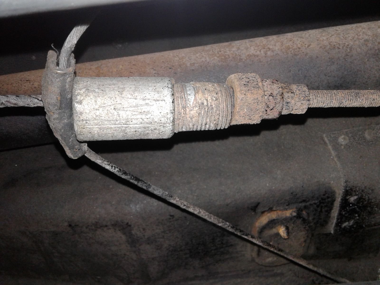

Here is how my PO bubba did it. The issue was more than just a stretched cable and required a total rebuild of the parking brake assemblies at the rear wheel.
Bubba fix for parking brake.
