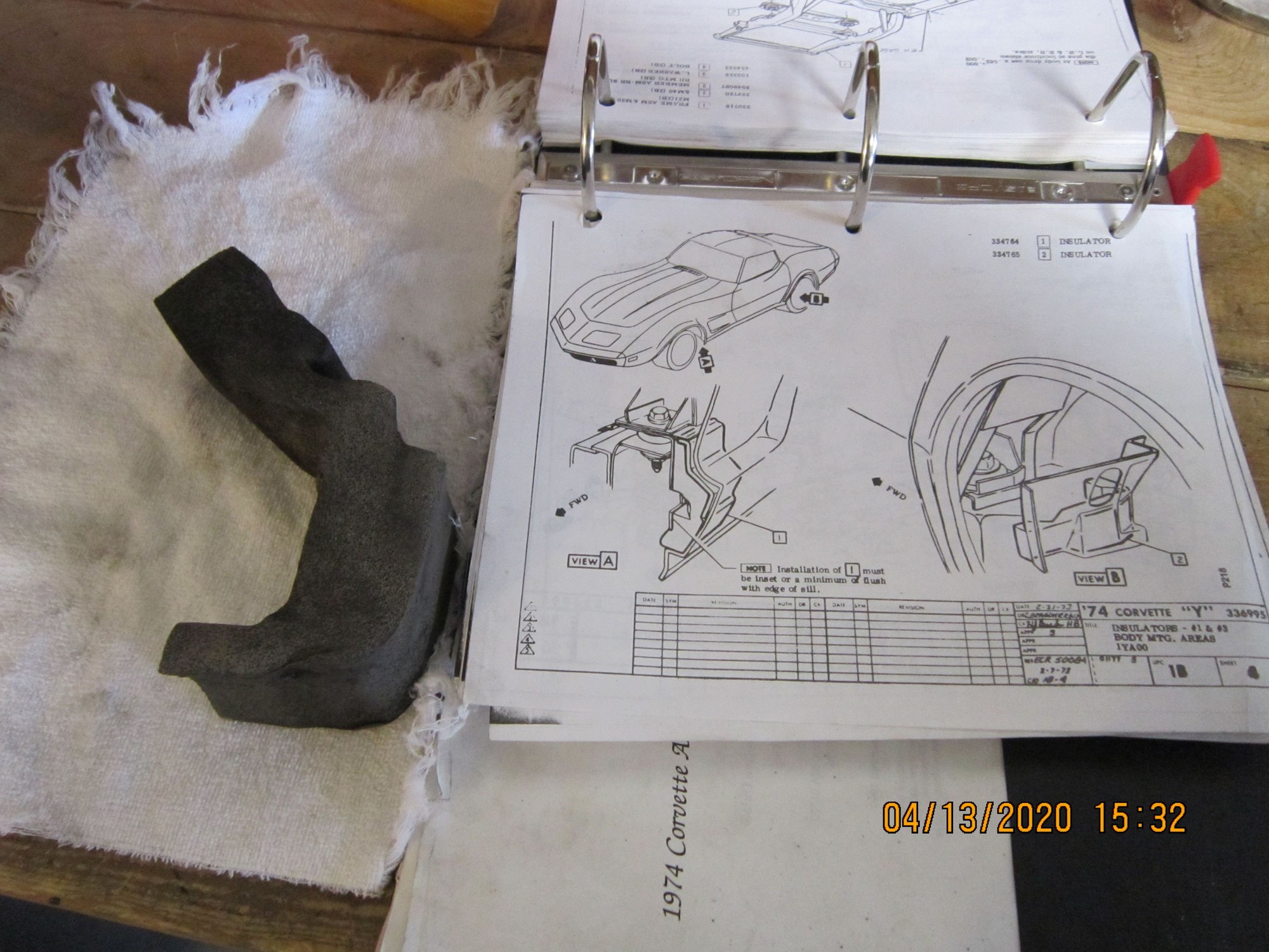

So I looked at the diagram for the front and rear body mount "shields" and they aren't to different. I'm thinking I can trim down the front shield to fit in the rear. The only concern is if the insulator interferes with the body mount fit as it slides down when dropping the body. Take a look:
front body mount insulator
