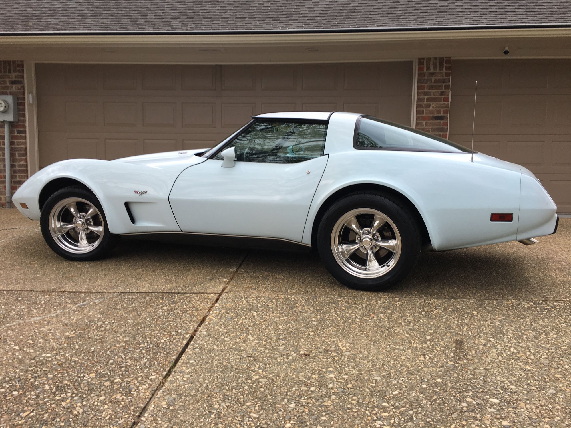

Check out wheelsforless.com. They have 17” wheel &tire packages for C3 corvettes. just recently got a package for my 79.

https://www.wheelsforless.com/Americ...m_Hot_Rod.html
8" wide, 4" backspace or -12mm offset.
That is what I have in the 2pc Built-To-Order Torq Thrust II.
